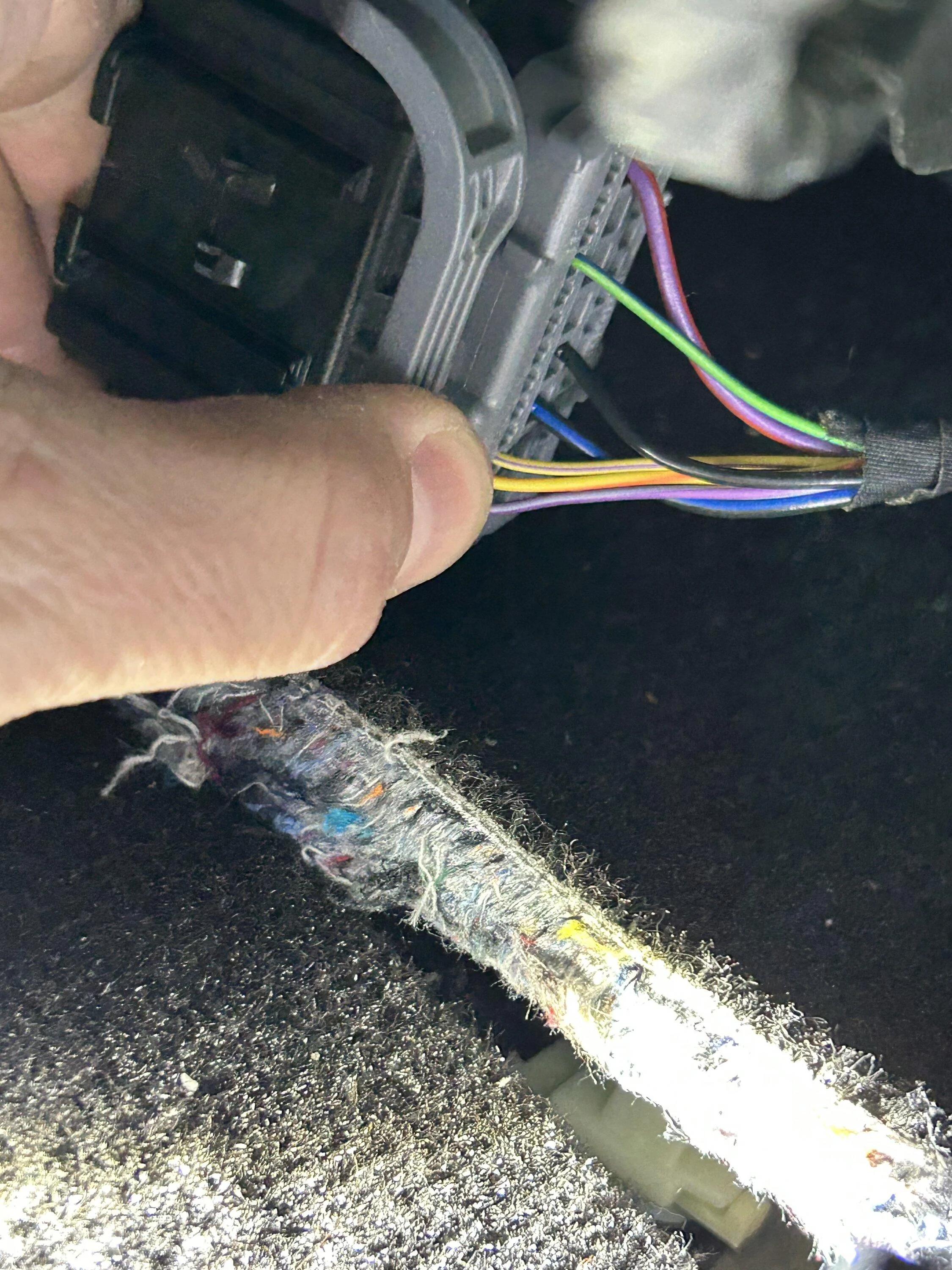

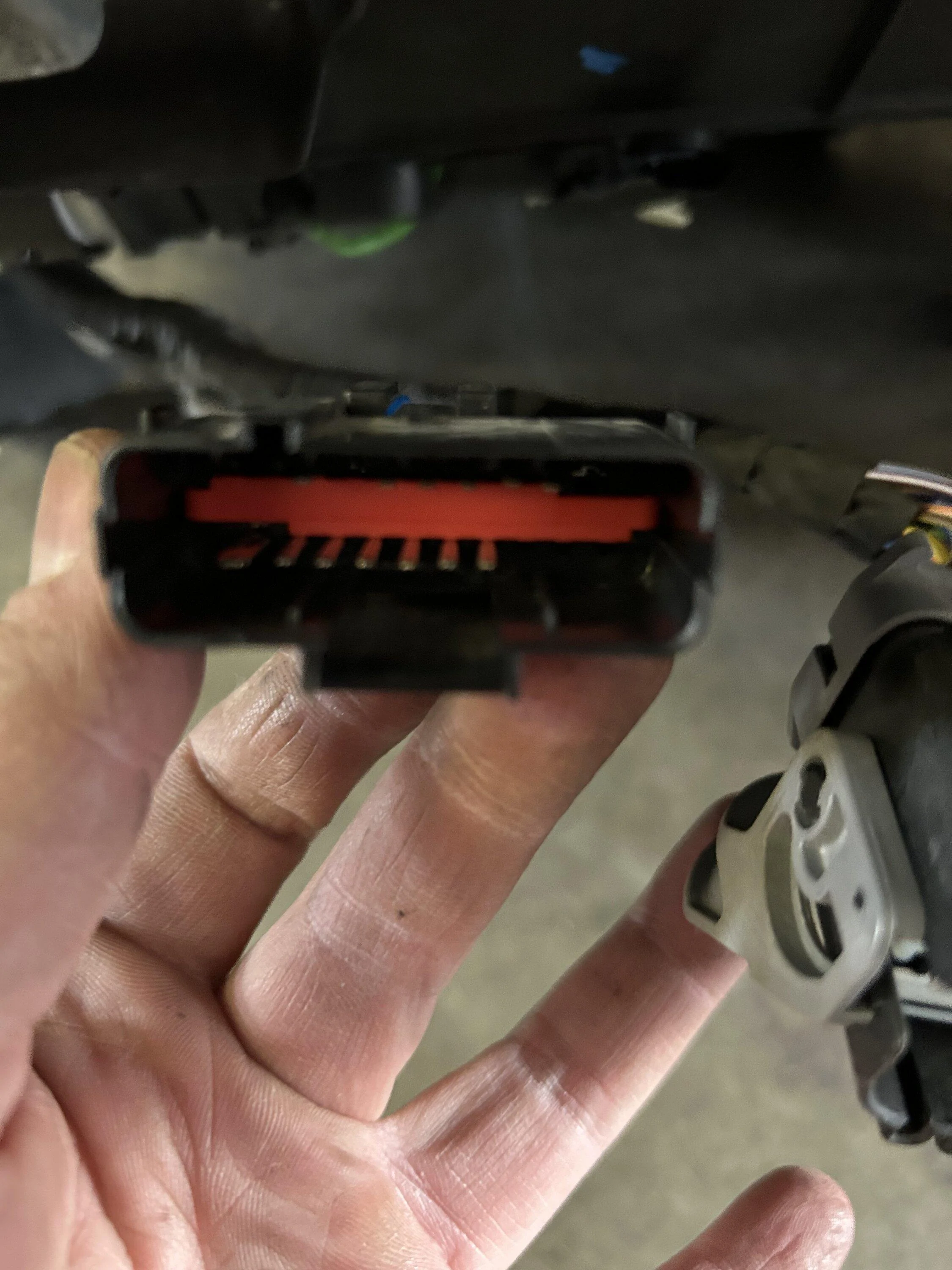

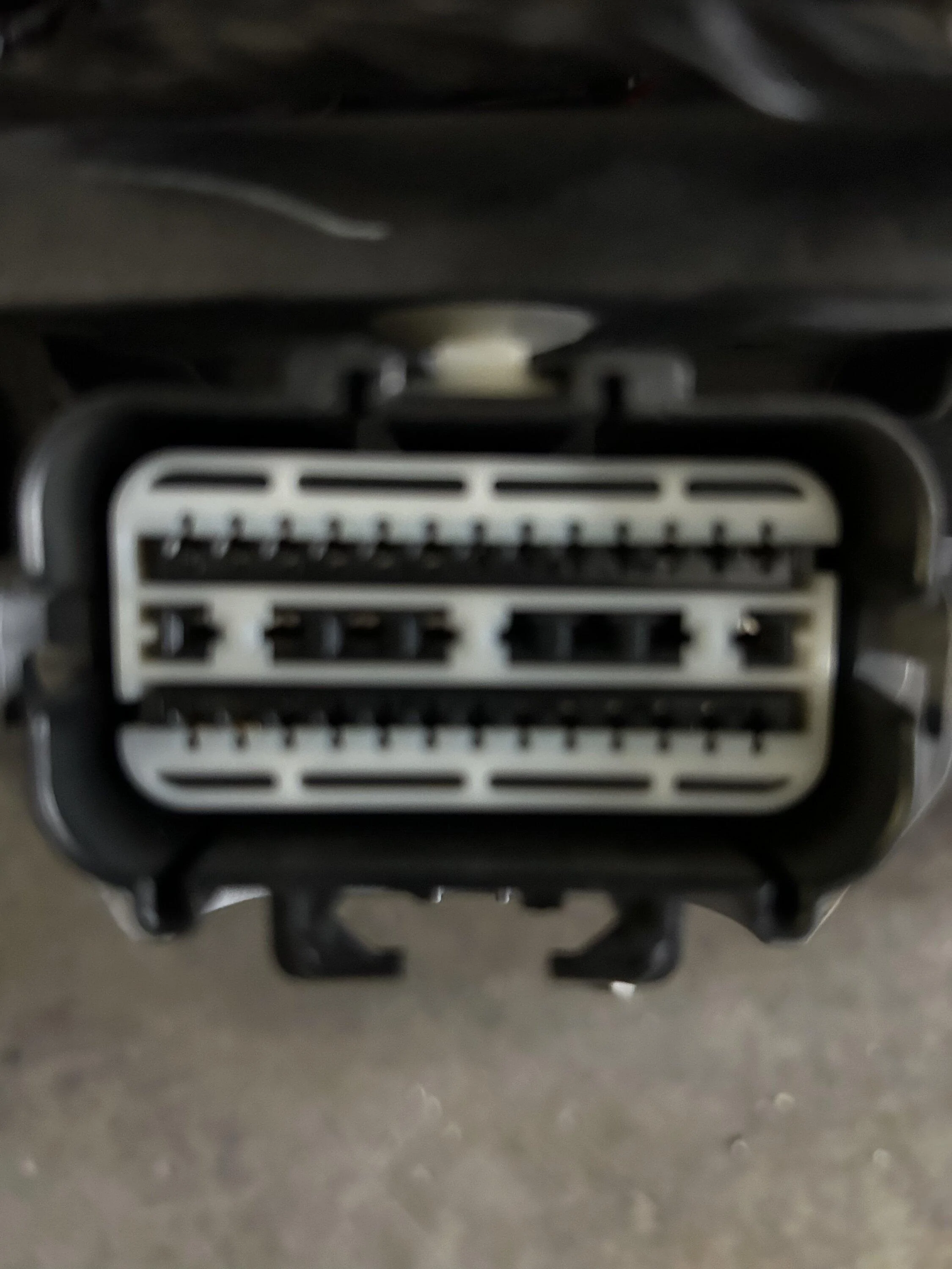

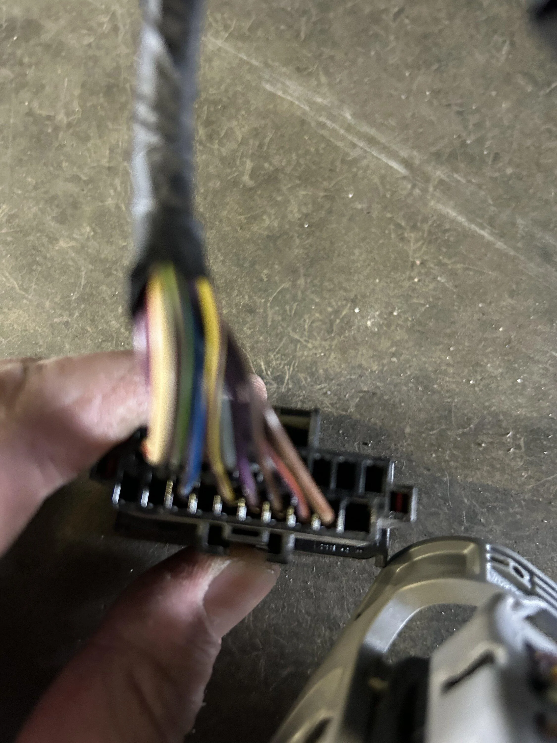

Hello this is my first post on here and was looking for some help with my interior swap. I have a 21 regular cab xlt with 301a package 8 way power drive seat and manual passenger seat. I scored a set of seats from a 2019 raptor heated and cooled 10 way power seats I’m trying to swap into my truck. I test fit them and eveytjing lines up but to my suspicions the power does not work. I’m not so concerned with the heating and cooling it would be nice if it worked but more concerned about power and no air bad codes or Dtc for the time being. Not quite sure where to start with eveything iv been reading for days about it but I can’t find much about this specific swap.I’ll attach some pictures any help would be greatly appreciated.
I have read a couple good threads on here on swaps but this install is a bit out of my
Comfort zone as I don’t have a lot of experience with wiring. Any help or direction would be greatly appreciated thank you!
Picture 1-4 is the raptor driver seat harness
Picture 5-7 is the raptor passenger seat harness
Picture 7-10 is the xlt driver seat harness

I reread your post. sorry, i can’t help you if it didn’t work when you plugged it in.
the plug from the floor will fit into the big plug on the seat. when i swapped a powered seat from a 2017 truck into my 2022, the seat worked fine and i have no airbag lights.

Do you happen to know how many pins are on your truck side harness? Do you happen to have a photo of the wiring on your truck side? I didn’t realize the driver seat has a memory module in it so I bought a non memory 10 way harness to bypass the memory and hopefully that solves the driver seat power issue but I can’t wrap my head around why the passenger seat isn’t working
