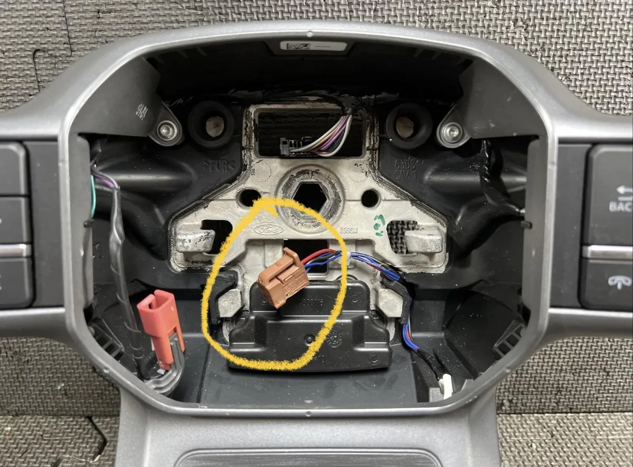

my truck is just outside the recall date for getting the heated steering wheel. My truck was built in April of 2023 and the last build day on the memorandum is March 29, 2023. So I'm looking into adding it myself. How do I tell if I need a new wheel or if I just need the new clock spring, and HVAC controls and the rest will be plug and play?
I saw this one but my temperature readout isn't in the dial. it shows up on the screen for the info center. I need to find the a way to locate the parts I need and see if i need to replace the entire steering wheel or just add some stuff to it

So i looked through that thread and I went out and popped my airbag of. theirs nothing plugged into the blank plug on the steering wheel side to the steering wheel control module. How do i tell if i have the heating element in the wheel? Do I need to get an all new steering wheel? so the thread is 80+ pages long so i may have not gotten all the info I needed to find.

In the front steering wheel picture - if you have the brown plug it's heated.
On the SSCM - there should be pins on the front and backside if you have a heated clockspring.
