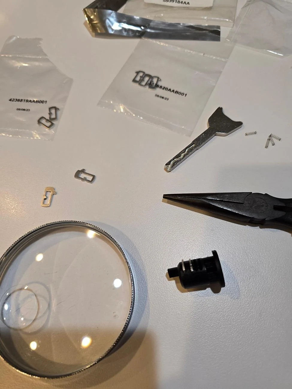

First, I keyed the locks to my keys. Instructions are included with the locks.

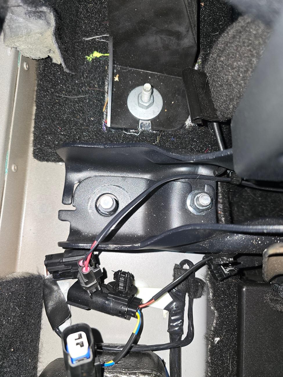

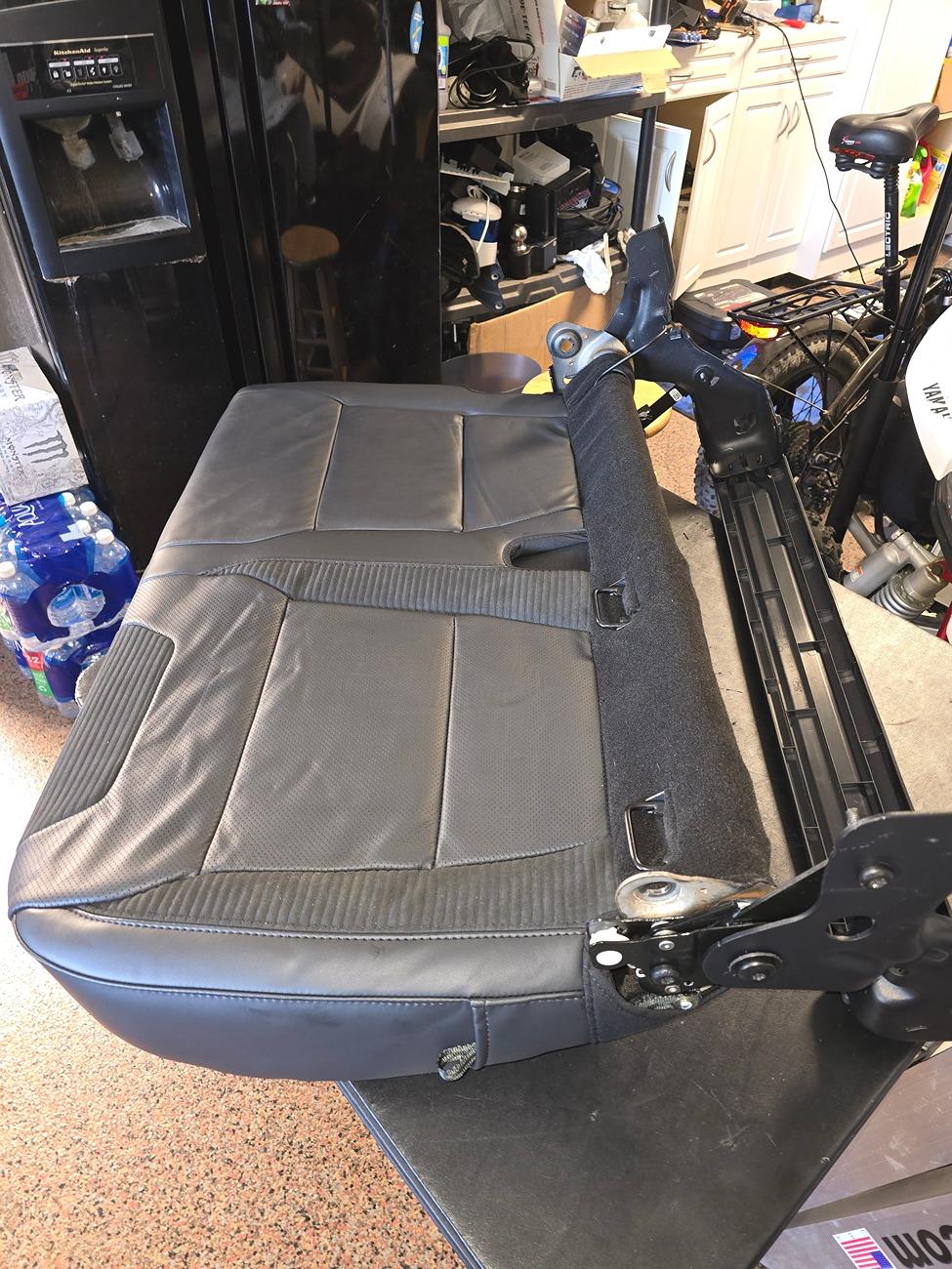

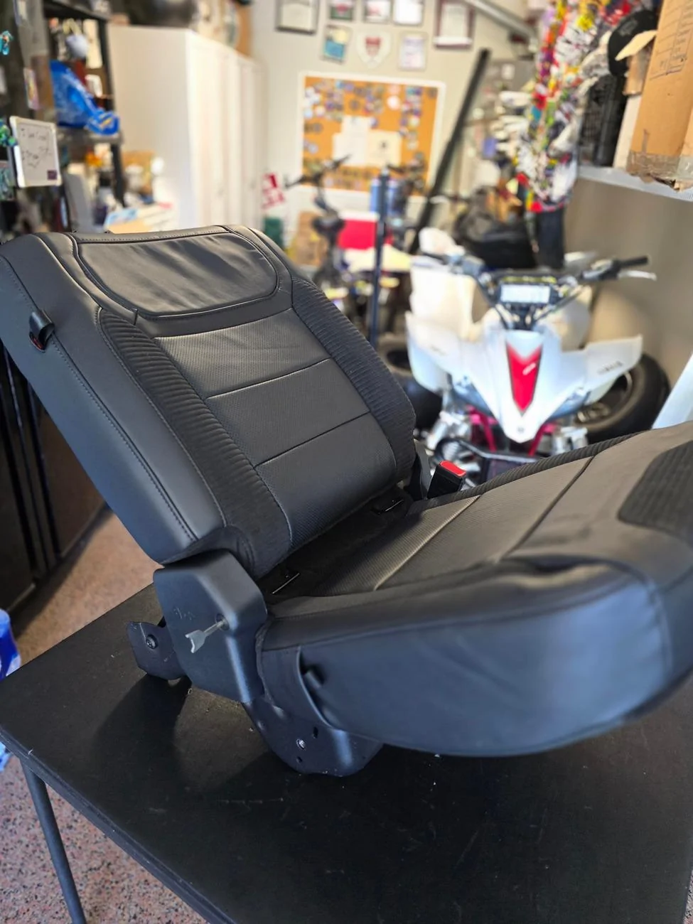

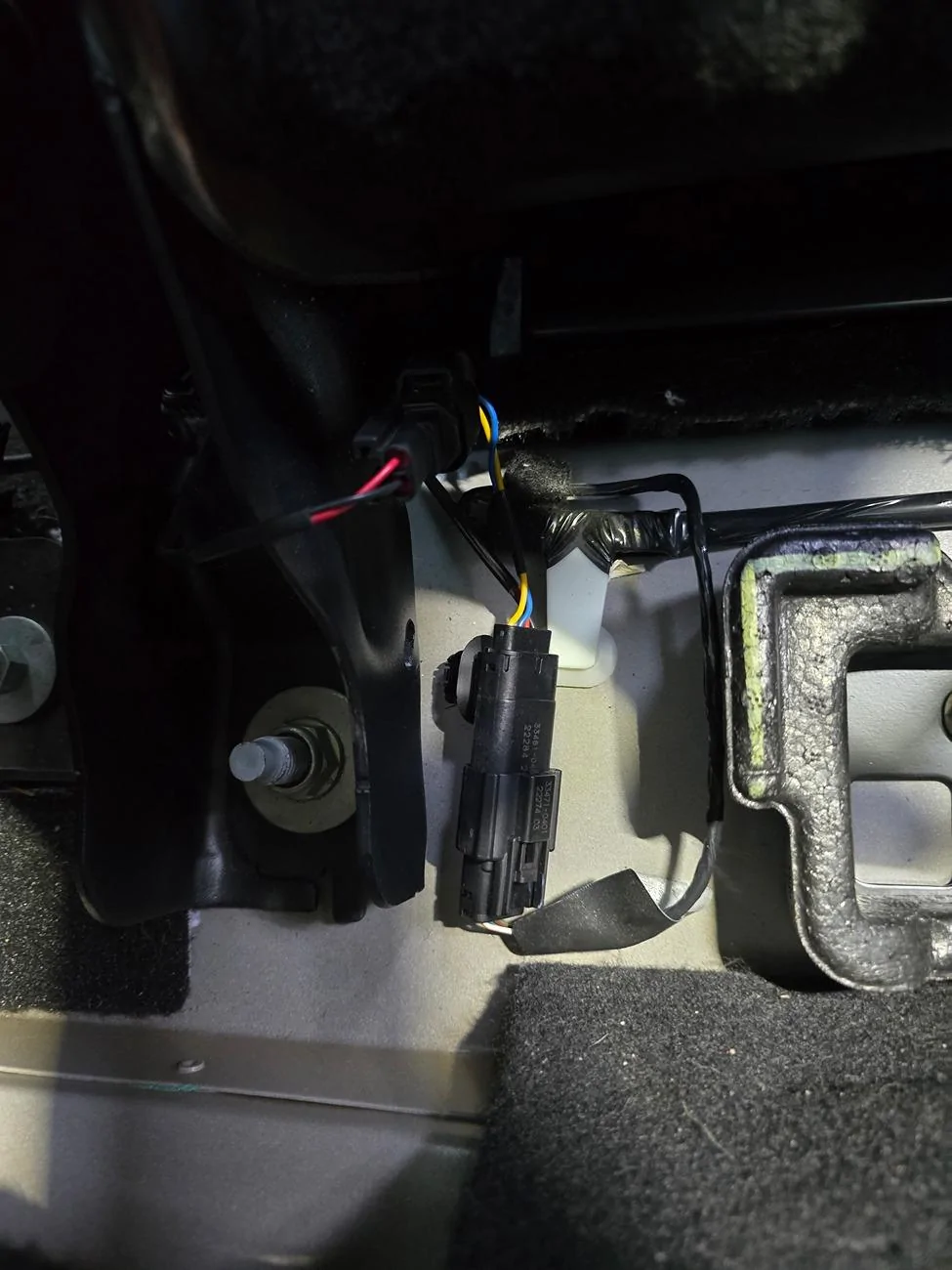

Do the 40% side first since taking it out before the 60% is required anyway. Also, it’s a bit easier to work with. Be sure to disconnect seat belt sensor connectors before pulling the seat out. There are three nuts in back, two of them on the 60% side of the 40% seat, and 13mm two bolts in the front. I used a ¾ ratcheting wrench for the large bolts in the back. Take the seat belt off the seat side.

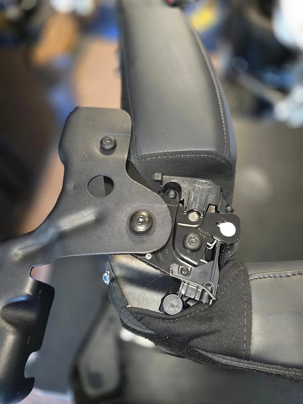

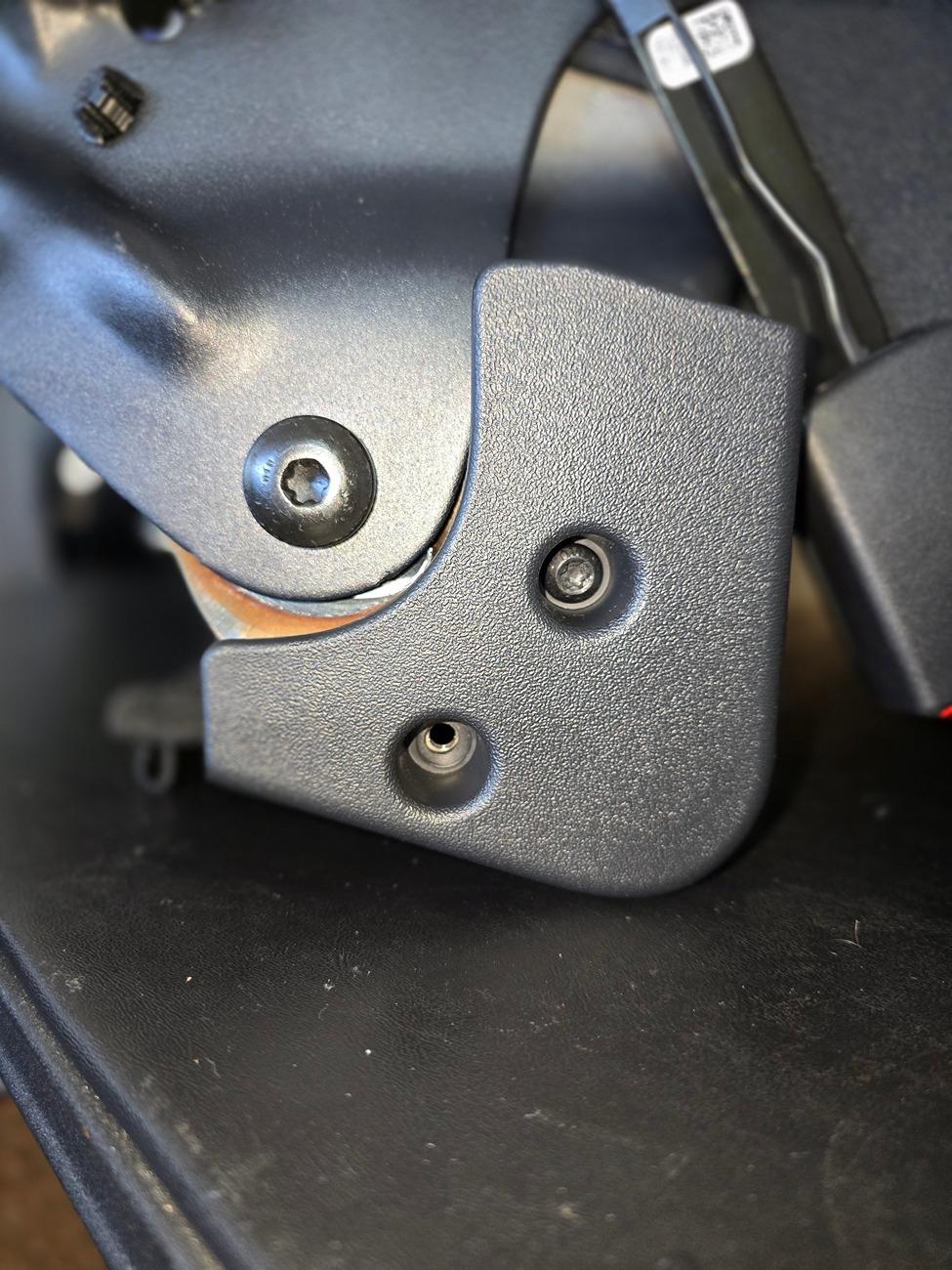

Take the current outside cover off to expose the latch you will be replacing and the seat back bolts. Take the inside cover off. These need to come off to take the seat back off.
Figure 6
Figure 7
Take the seat back off by removing the 13mm bolts on either side.

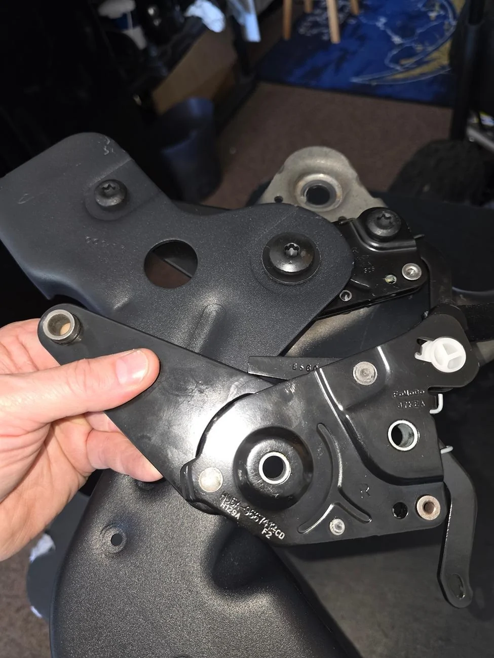

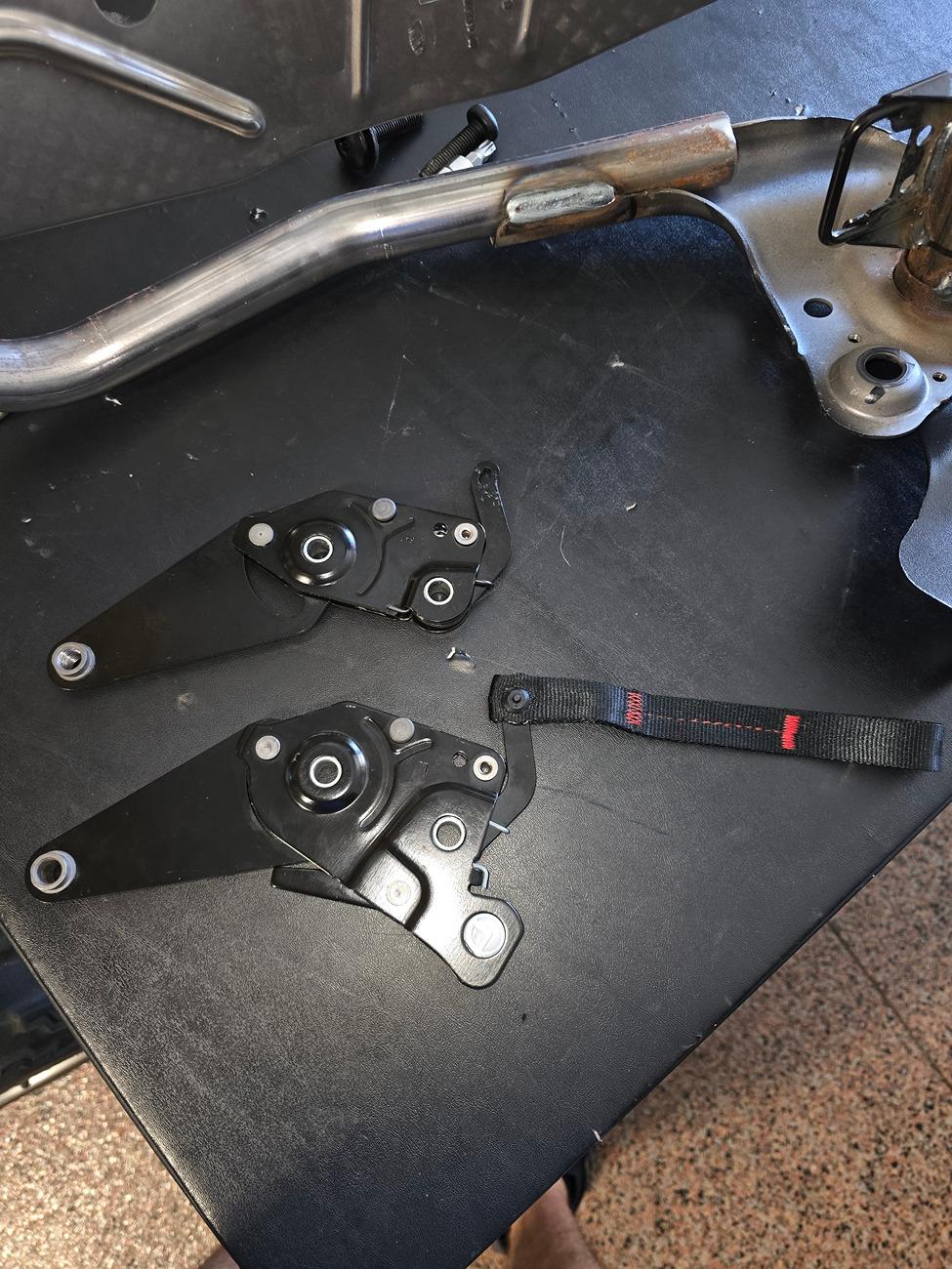

Note the current latch position and orientation (R on this side) and compare it to the new locking latch. Remove the current latch.
Figure 9

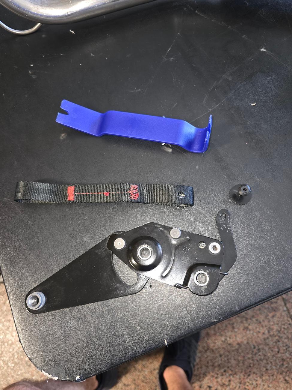

Take the strap off and install it on the new latch in the same orientation. The strap is held on by a grommet and pin that snap together. Use a trim tool to gently pry them apart. I was able to recover one but broke the one on the 60% side later, so they are on the parts list in case you brake one. They come in packs of four BTW.

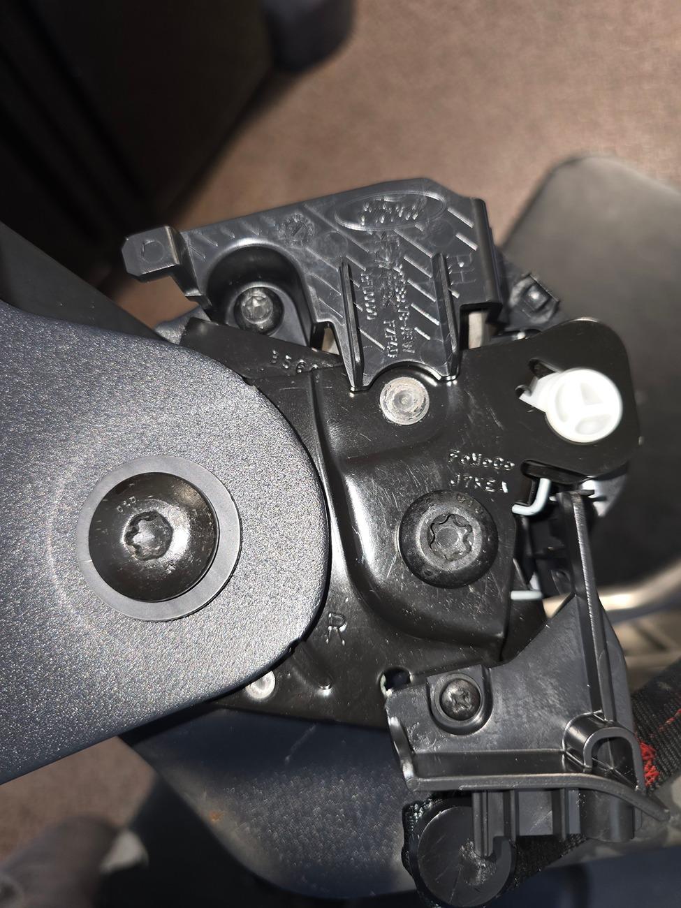

Install the new latch, re-install the seat back, and fidget in the new over inside piece. You can soft clip together the inside and outside plastic covers to help with alignment of the inside cover piece. Refer to parts.ford.com to see how things fit together and where screws are to be used. I used a generic F150 diagram for the latch on the 40% side, and later the 60% side to see what goes where. This figure shown the here is with the new latch, seat back re-installed, and the inside cover attached (this placement is important to understand).
Figure 12.
Figure 13.

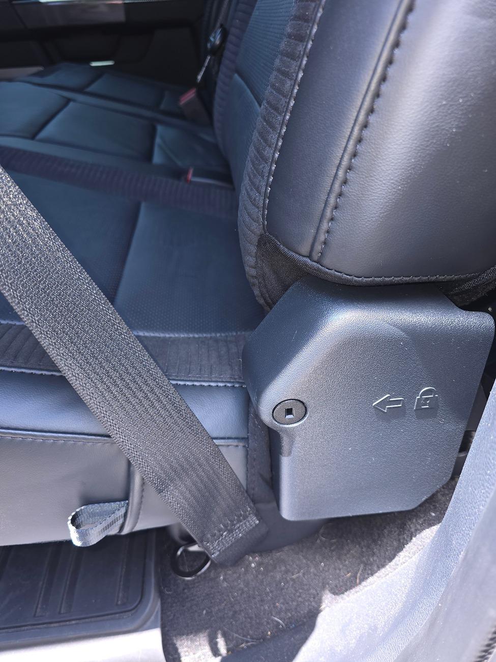

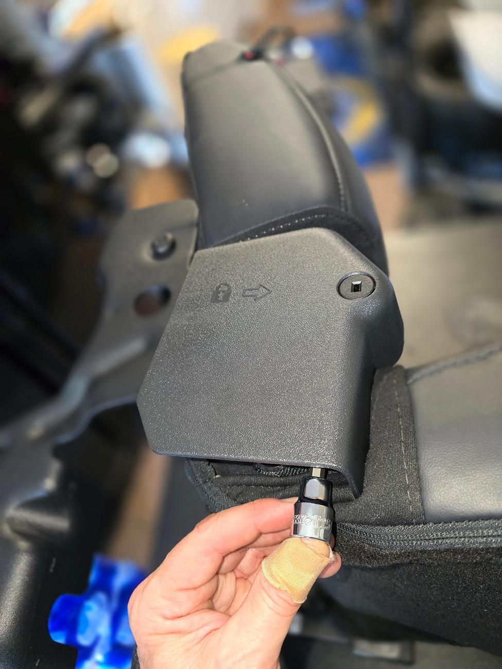

Install the lock in the cover hole. Be sure to observe how you will install the lock part of the cover. Line the lock up with the white round part for activating the lock piece in the new latch. Install the covers. Keep the key in the lock to jiggle it if you seem to be close but not quite having it in the white piece on the latch.
Figure 14.
Figure 15.
One installed, check operation. If good move on to the 60% side.

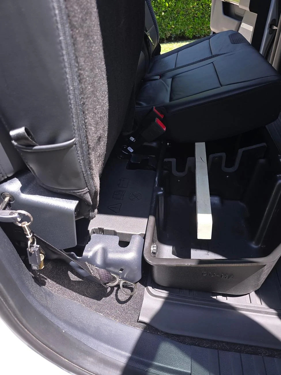

Now that I have locking seats, I can use them to lock an under-seat storage like this one. I did not use the Ford OEM one and found this Du-Ha to be more sturdy and easily removable to recover floor space when needed.
