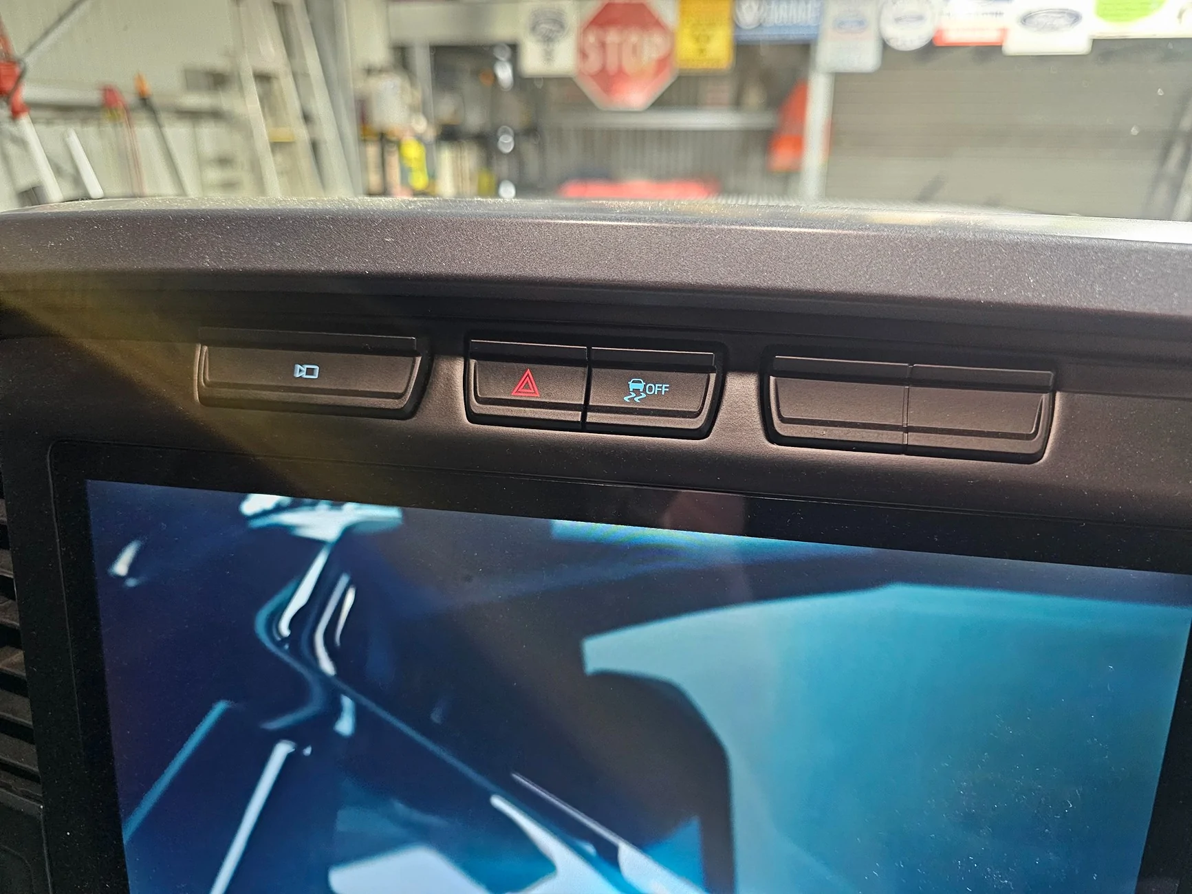

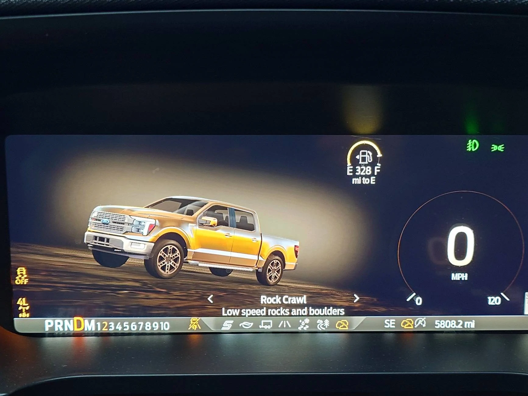

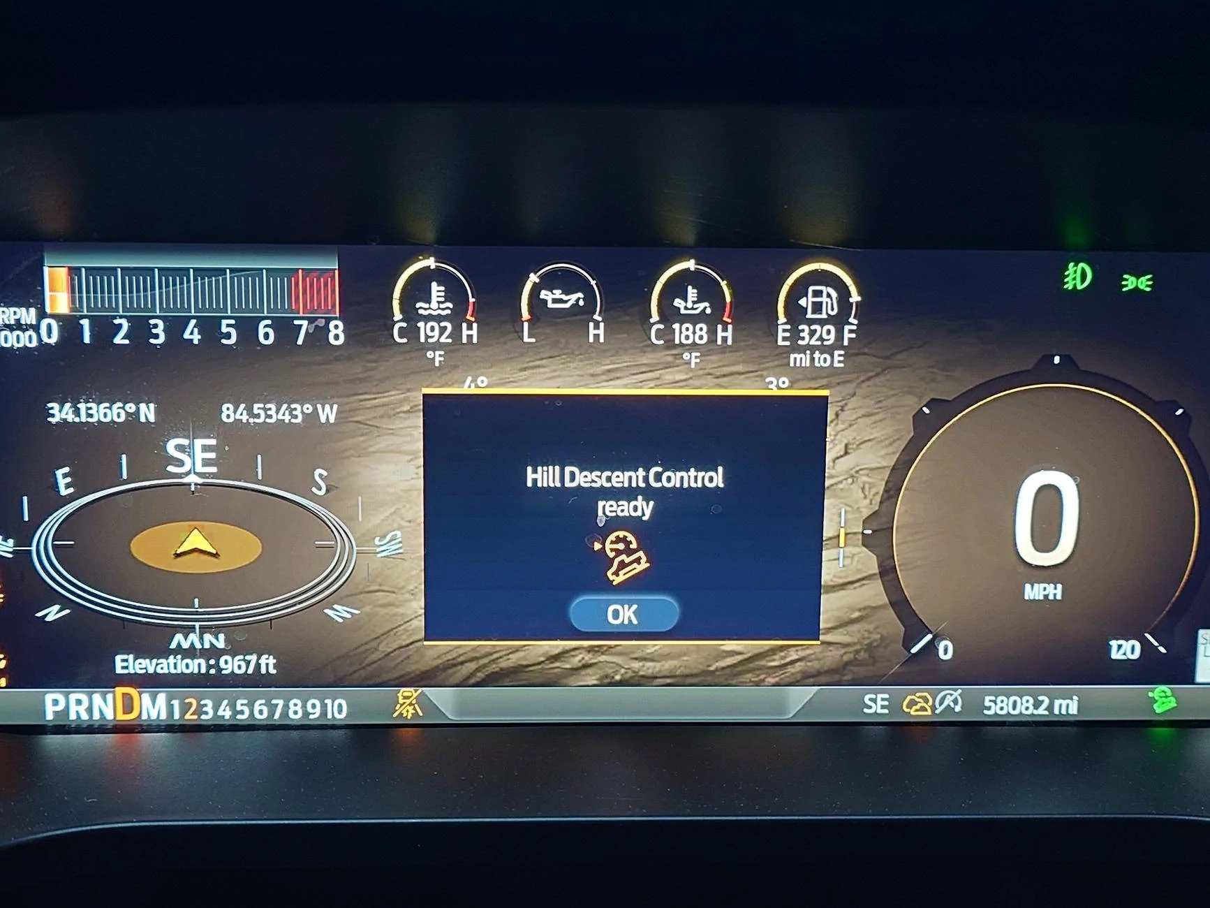

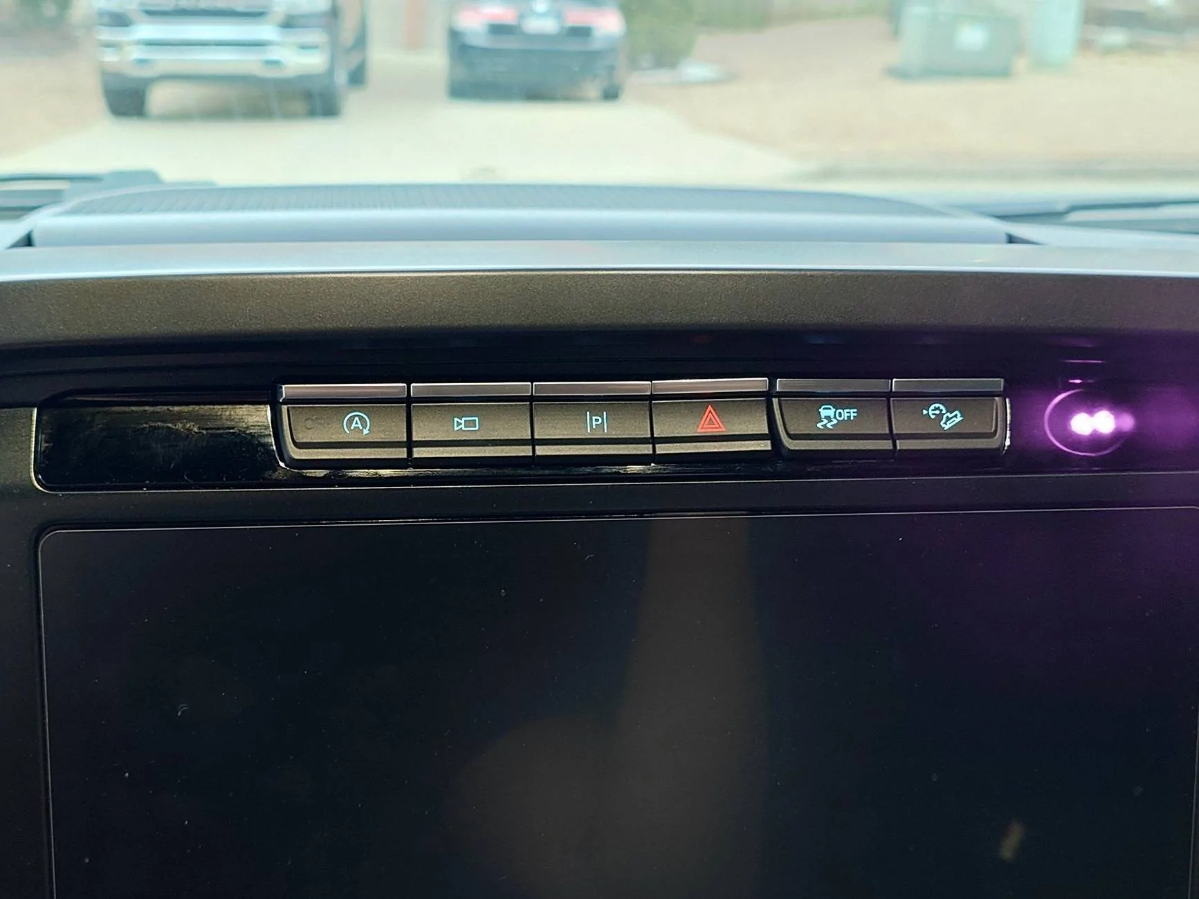

Nicely done!Update...it works!
I now have HDC and Rock Crawl modes.
I was super confused during the install as my harnesses both had a wire in the spots listed as needing to be tapped...
So I just threw a Hail Mary, plugged in the switch, modded the FORSCAN and boom!
So on my 2024 STX the factory already had the correct wiring run...lucky.
Now if I could just figure out how to make this auto climate trigger my AC compressor ?
To access the switch did you only have to remove the center speaker to access it?
I have a 2024, so I am hoping that I am pre-wired for it, and wanted to minimize the amount of trim that I have to pop off.
