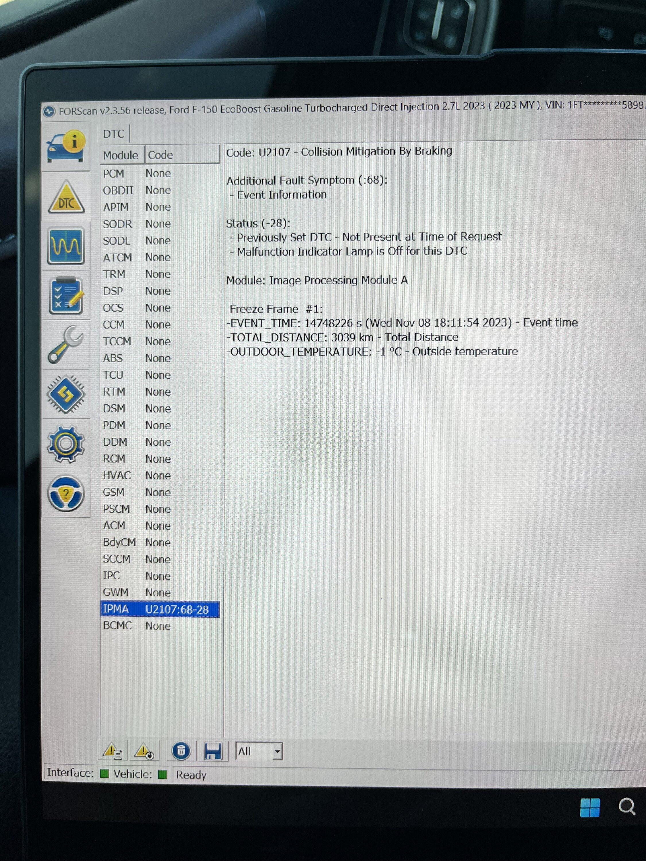

After almost 4 days of successful CCM upgrade and no issues while using, I went ahead to save all my as built so that if ever any update or something removes my CCM upgrade I can go back.
While connecting Got a DTC for Ipma.
any idea what that is ? Though its not there anymore.
