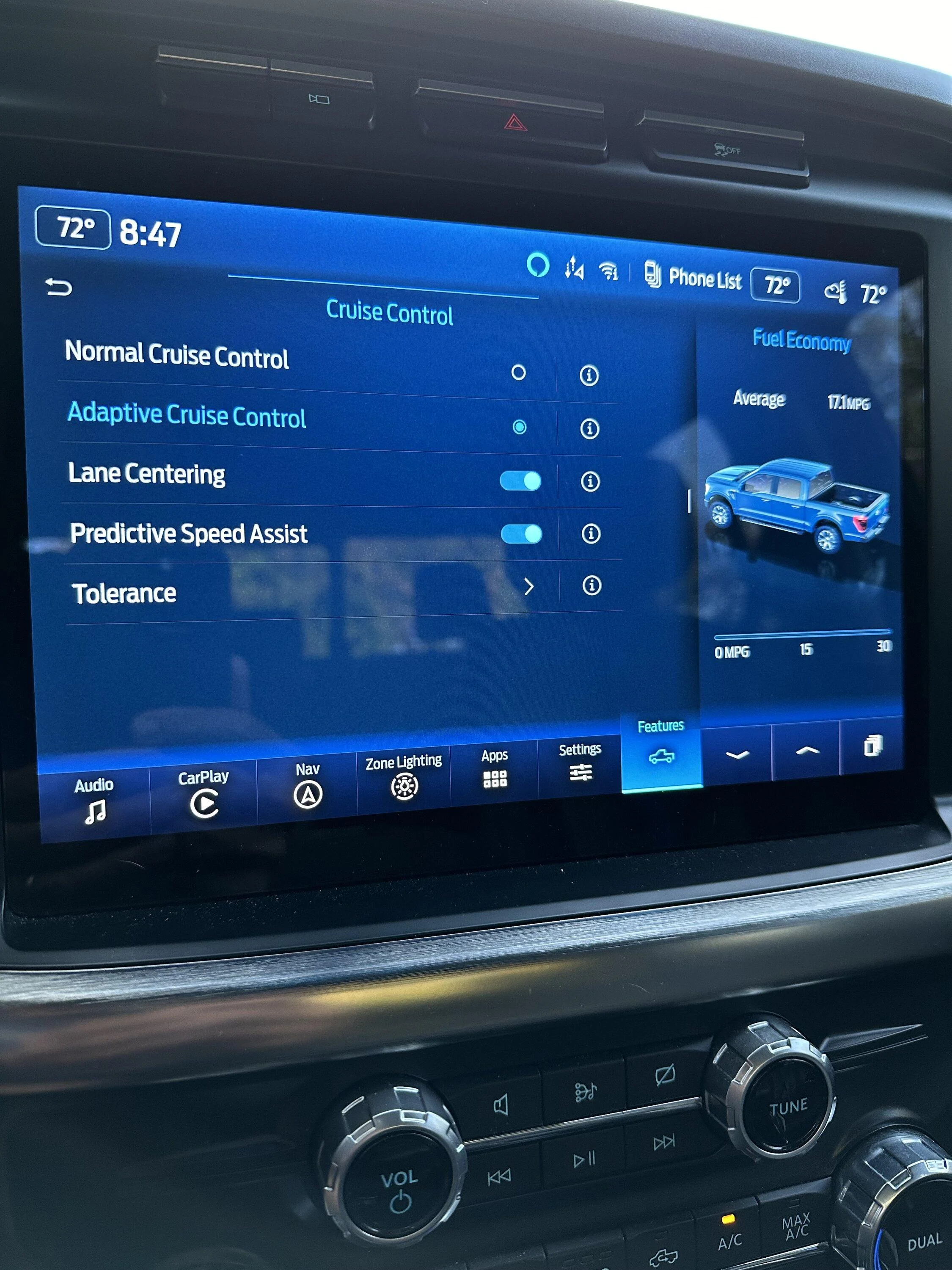

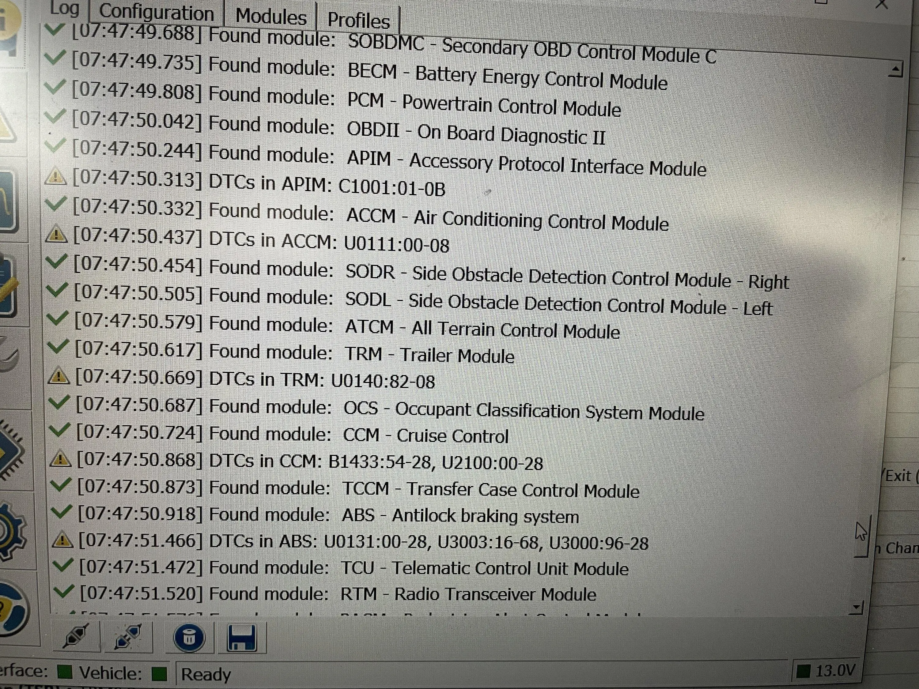

Additional: I looked up the DTC in the CCM and it says Initial Configuration Not Complete. Do it again. https://forscan.org/forum/viewtopic.php?t=3192Check the DTC in the CCM. It's likely it did not calibrate as you thought. If it says not calibrated, go through another calibration. Many of the DTCs may be due to the fact that you have ACC enabled in the Driver Assistance menus but it's throwing DTCs because it's not available. In fact, if you press the cruise control button while driving right now, it will likely say Adaptive Cruise Control not Available on your instrument panel. For some reason, I had to calibrate my CCM twice. The first time it seemed to calibrate and it took only maybe 10 to 12 minutes. But it didn't actually calibrate. When I calibrated the second time, it took somewhere between 15 and 20 minutes and was successful. Prior to the successful calibration, I also had a bunch of DTCs. You need to drive over 30 mph and try staying in your lane and follow some traffic. It may have given up rather than calibrate the first time.
