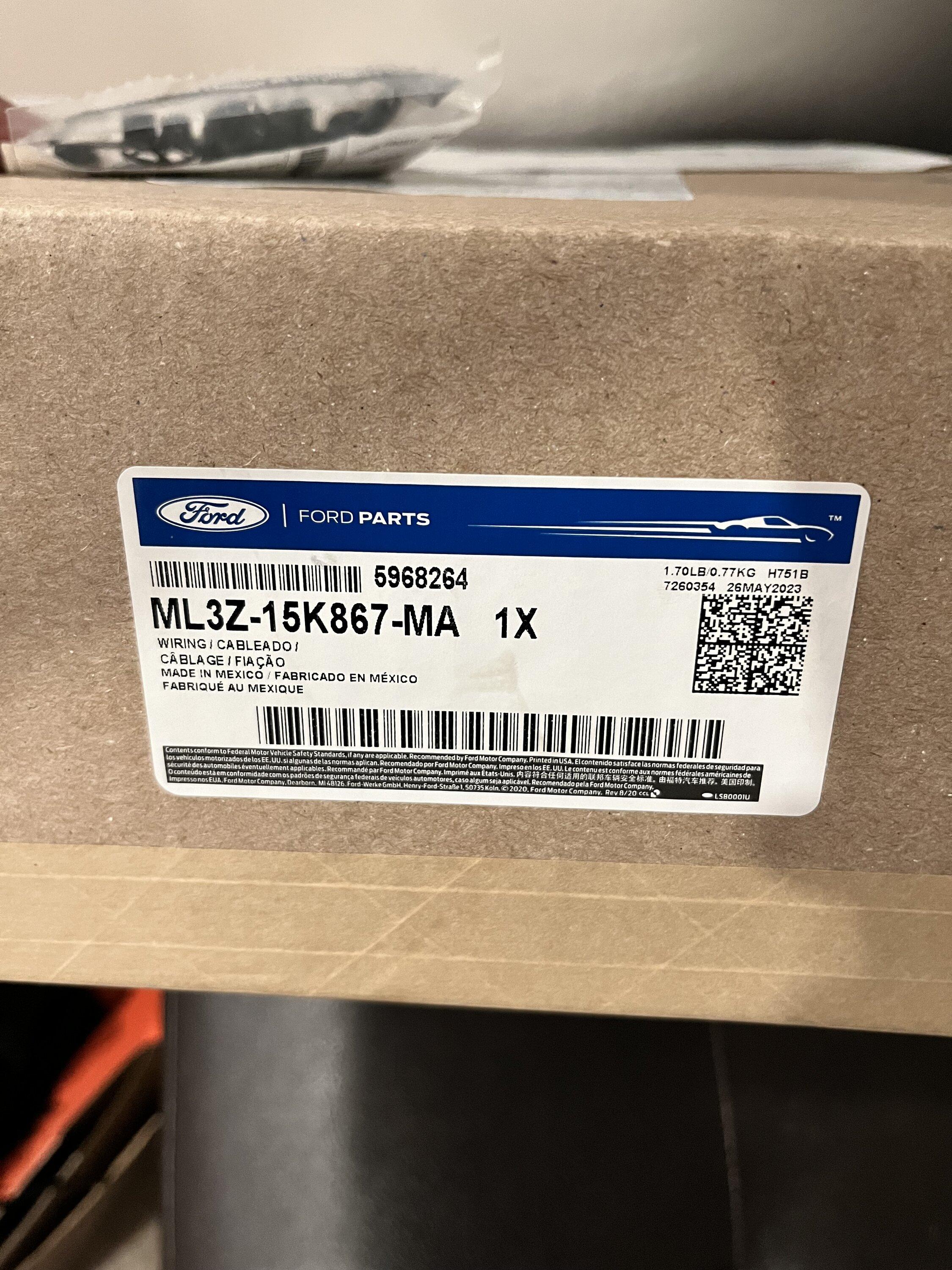

To get started though on the parts:
Wiring is the ML3Z-15K867-MA OR MF(A POST SAID THAT THE NEW PART)

Disregard that sheet tab, that is my play around sheet and for got hide it, thanks for the reminder!
ML3Z-15K867-MA is what you need if you have a turbo motor, will work for a 5.0 as well but will have extra connectors.
That FB listing is what you need so get that if you can.
Yep, just get the parts and make the changes in the sheet and you should be on the right track.

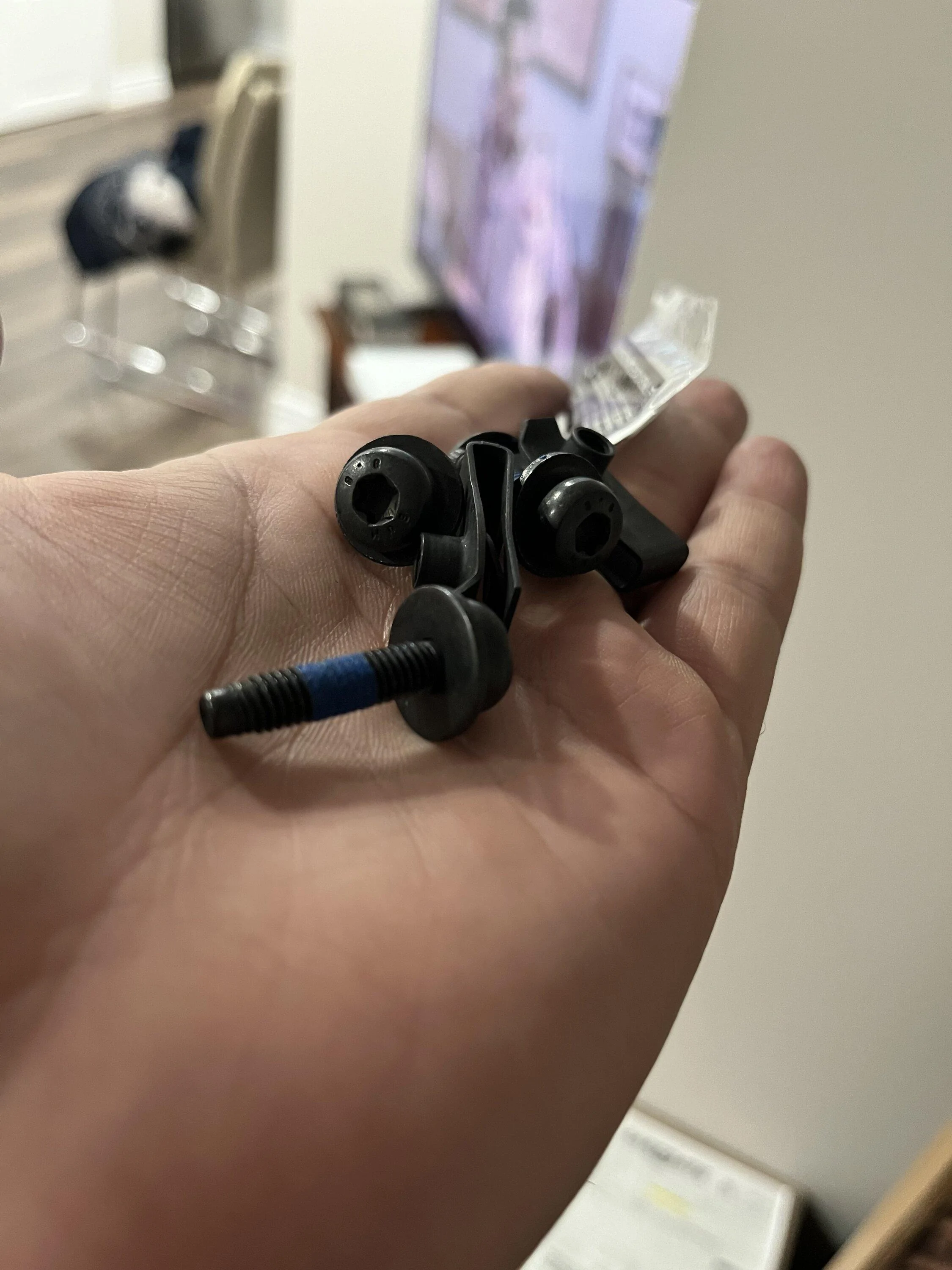

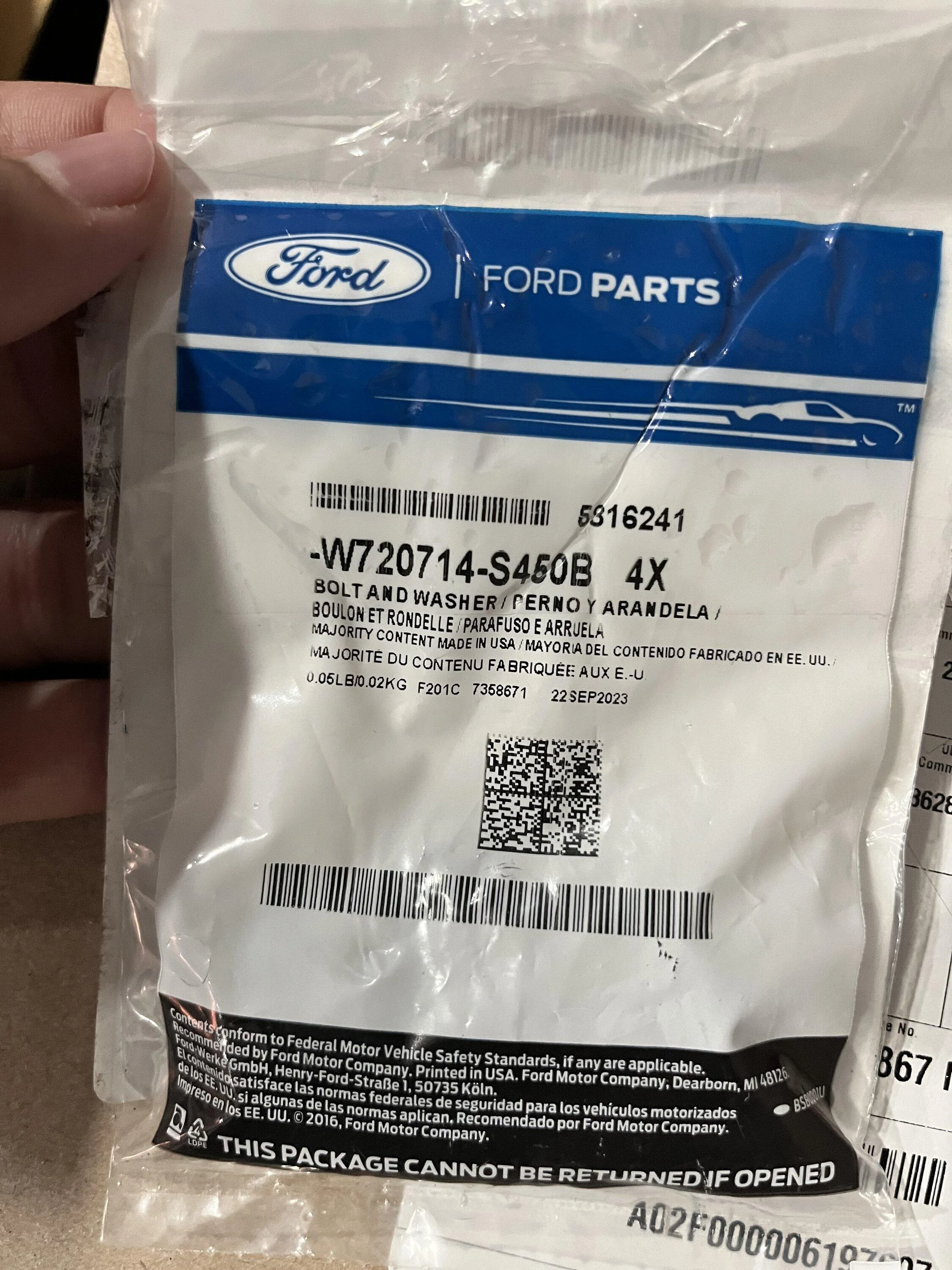

M6x20 or 25 flange bolts
Damn it! I ordered the Ford parts and it's around $50 for 3 of em.
Are these just the same? if so, I might try to cancel the order when I pick them up.
Apart from this @superfordman If you help me understand what will be the different steps for my CCM as it's a used one?
How do I remove the previous VIN and add mine? That's the only thing I believe I am unsure of at this moment.
@thunderf150, I did not order the Ford screws for the CCM, I took my CCM to ACE Hardware and bought 1” stainless steel, flange screws that fit it along with some thread locker. As for the VIN in the CCM, once you have the CCM installed and recognized by ForScan, simply overwrite the existing VIN. That’s all you have to do.

@thunderf150, I did not order the Ford screws for the CCM, I took my CCM to ACE Hardware and bought 1” stainless steel, cap screws that fit it along with some thread locker. As for the VIN in the CCM, once you have the CCM installed and recognized by ForScan, simply overwrite the existing VIN. That’s all you have to do.
Got it! So when installed open the ForScan in new profile to see ccm and 1. overwrite VIN on it and 2.make the changes to other modules or opposite?
What bolts should I ask at the parts shop, do you have any pictures?
TIA
Yes, just follow my sheet and copy in your VIN from another module.
For bolt exactly what you quoted from me above, M6x25 flange bolts.
TIA
Yep, just like @superfordman said. When I ordered my CCM, I didn't order Ford's flange screws with it opting instead to just take my CCM to ACE Hardware and have them match the threads and head shape.
To clarify your question on entering your VIN into the CCM, you must make all the ForScan changes in all modules except the CCM first. Then power off your truck, let it sit and absorb all the changes you made, then go back in and load a completely new profile in ForScan. If all physical connections are made correctly, you should now see the CCM in ForScan list of modules. From that point, enter your VIN number in the CCM as indicated on the spreadsheet, overwriting the previous VIN that was in the CCM. Write the changes, power off/on and verify the changes. Assuming all is correct, if you haven't already done so, you need to physically level the CCM. After that, you need to run the CCM calibration procedure that's been detailed several times throughout this thread. Since you read all 55 (now 56) pages, surely you'll remember reading that. ?

Just an update the parts are here. Too bad the temperature is dropping down quickly here now. Hope I can find a way doing the installation at a buddies place inside a garage.
Fingers crossed.
