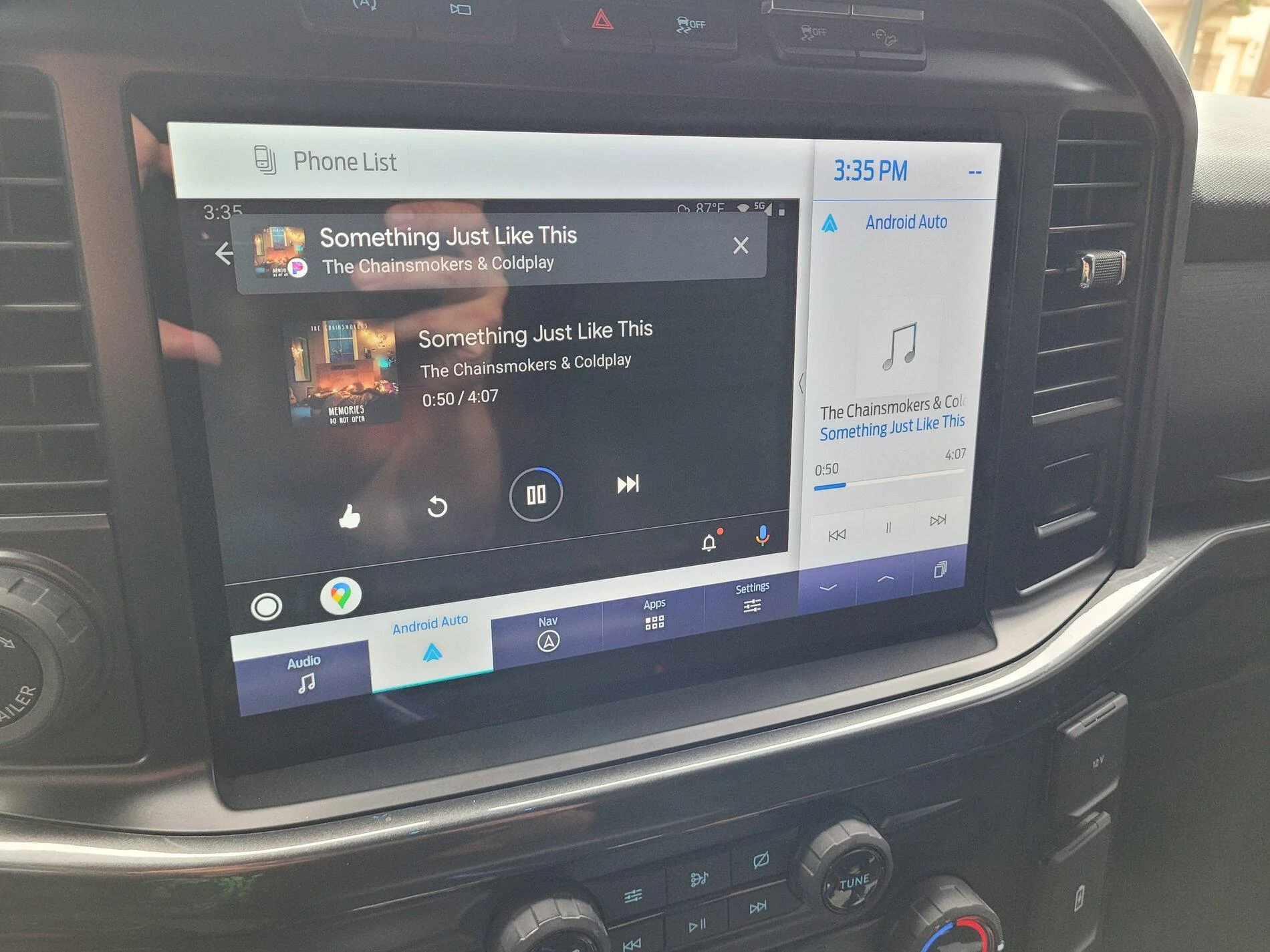

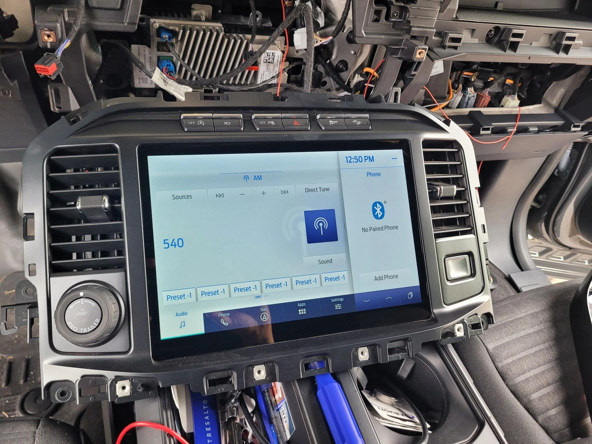

It is possible. I have done it. Plus a few other things. Wireless charger. Console shifter, 12 inch Upgrade.
The cluster unfortunately requires the top dash o be replaced. Could be just the driver side IF there is a dash material that matches what you have in your truck. For an XL like mine I had to do the entire dash. The opening is smaller for the Digital cluster versus the 4" and 8" cluster.
