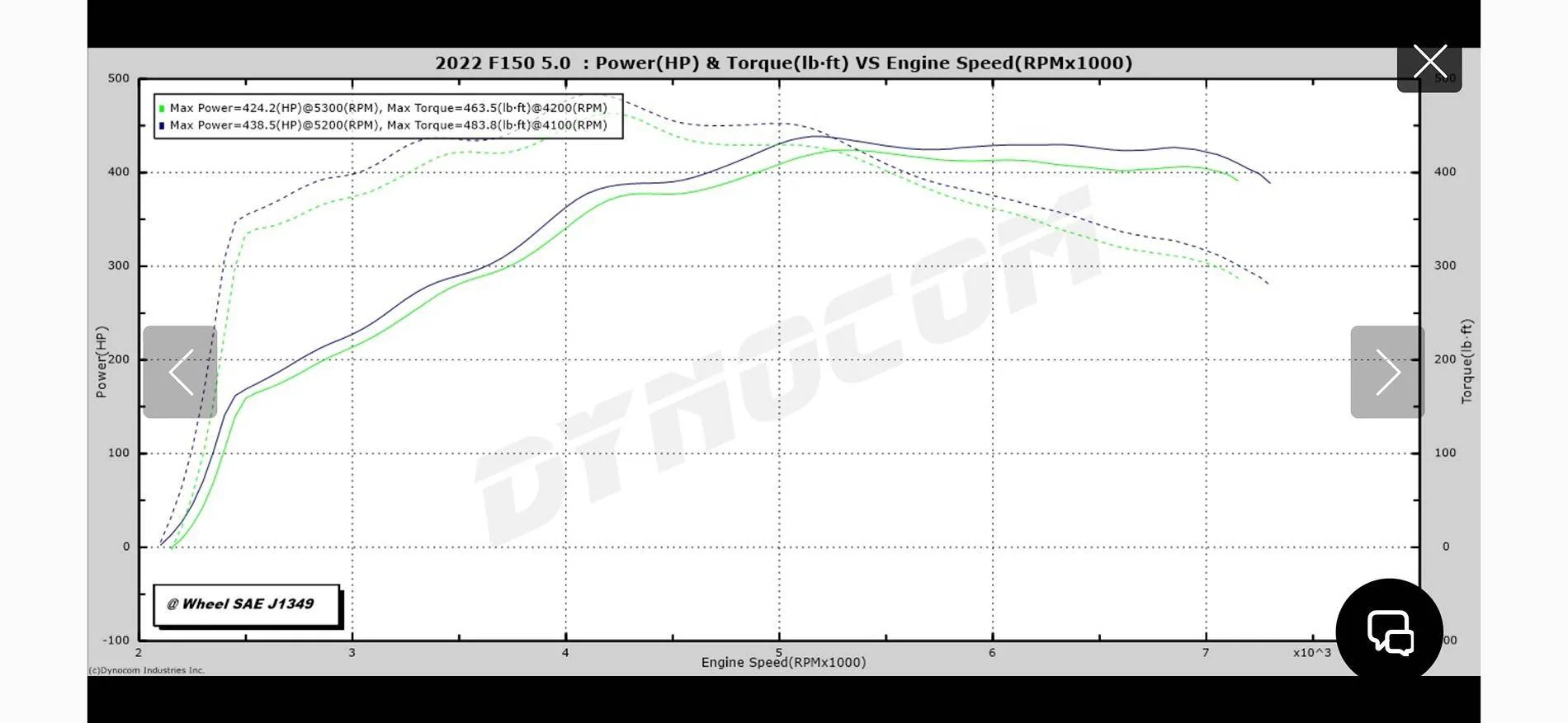

Oz tune is great. Will definitely keep it during the winter for 93 octane.
This is not a jab to Oz. At all.
But the 5 star e85 performance tune is holy shit fast. It’s fast enough I probably need to lower the truck.
All around I am happy. Cant imagine the procharge setup if the 5 star tune is this fast. Just fyi fellas.
