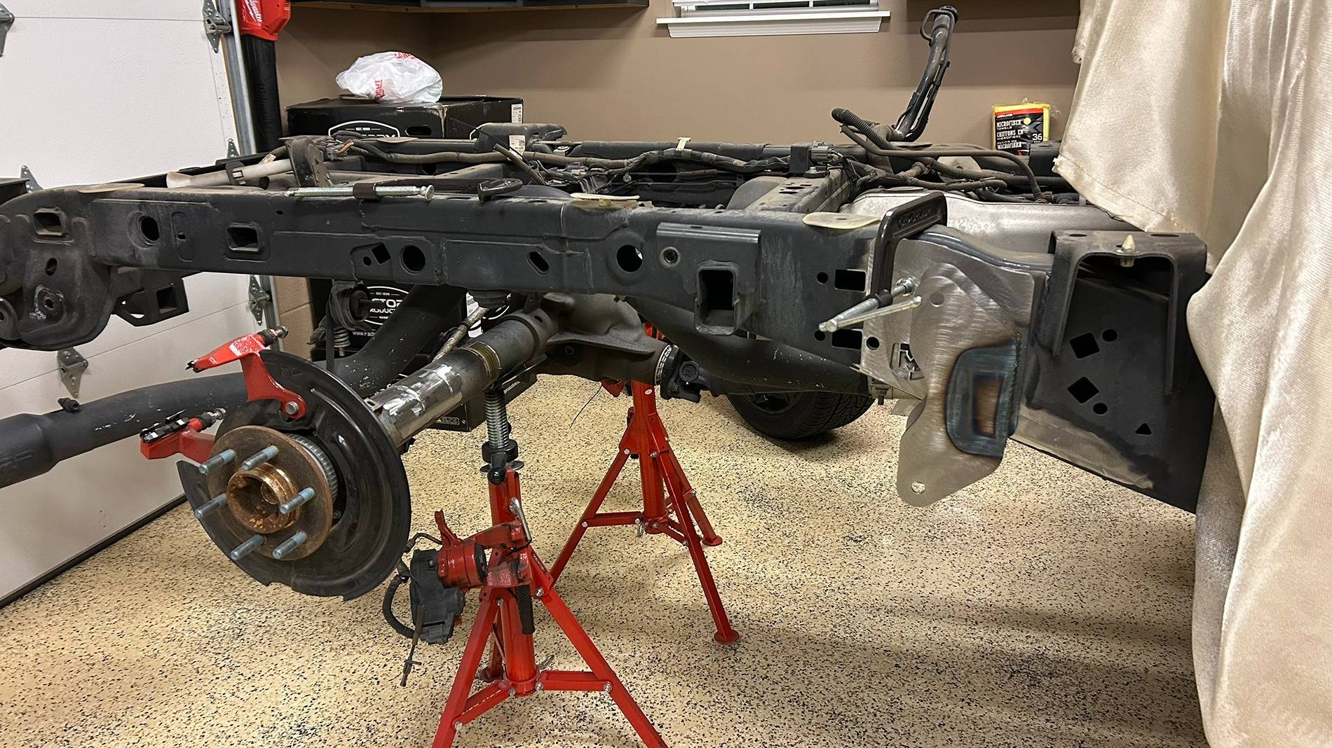

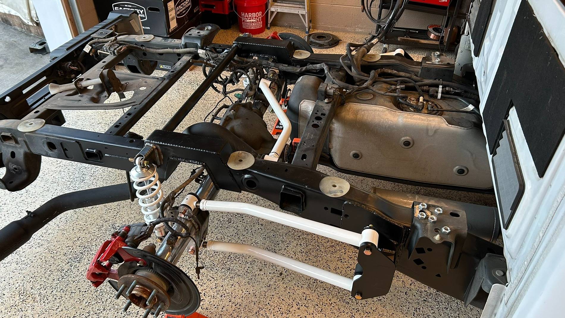

Figured I'd go ahead and post this in case anyone else was considering ditching the leaf springs on their truck. I knew from the start that I wanted something different...I've had several high horsepower trucks dating back to the late 90's. And leaf springs with traction bars always seemed to be a compromise to me...I didn't care for the look, didn't care for the ride quality, and to be honest...it just felt like wagon technology of yesteryear.
A couple of buddies of mine down in FL had some pretty fast Lightnings back in the day, and they all went 4-link and never looked back. So I figured I'd give it a go since this truck is a weekend warrior. (Although, Raul of Twisted Metalworkz says he has customers that tow with their 4-link trucks all the time without issue with the addition of some helper air bags). I have another truck that tows all the other toys...so that wasn't a concern for me.

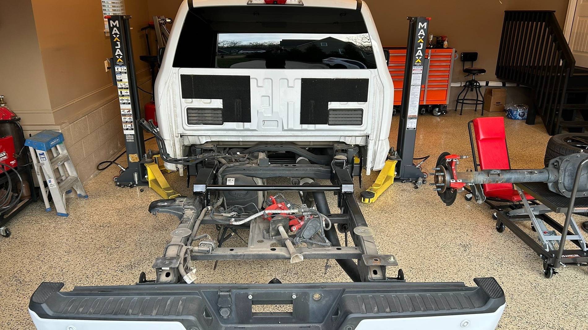

After making a few phone calls to Twisted Metalworkz and speaking with Raul, I was sold. He is very friendly and answers questions almost any time of the day and night. His customer service was outstanding...I will say though, the kit does not come with instructions, so basic fabrication skills are needed. The layout of the kit isn't the hard part, it's all pretty self explanatory. The hard part is installing the C-Notch due to the frame stiffening plates that Ford welds around the frame in the area that the C-Notch needs to be installed. Removing those frame stiffening plates was not my idea of fun! Luckily, I did this during winter and didn't really have anything else better to do... :crackup:

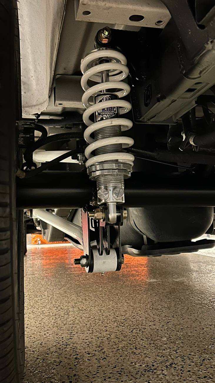

The kit came with pretty much everything I needed to install, one thing to note...this is NOT a bolt-on kit, it requires permanent modifications to the frame. You will have to remove the front leaf hangers along with the passenger side shock mount at the least. So proceed at your own risk! I decided to go with the street kit, it does not have the bar angle adjustability the drag kit does. But it does come with Delrin bushings on all the bar ends...which I was more interested in since this is mostly a street truck. The kit came with 10" 300lb springs with the Viking coil over shocks, since my truck is not as low as others, I felt the supplied coil overs were too short and the springs were too stiff. If going for the slammed look, then the supplied coil overs may be perfect. A phone call to Viking resulted in a much longer coil over which allowed me to gain a ton of travel back, along with lighter springs. I now run 14" 150lb springs, I must say...the ride quality is something I never expected to achieve with a truck. It rides like a sport truck should! The rear end is some much more planted now, and having the adjustability of the Viking coil overs is a huge plus. I have around 1000 miles on the setup now, and I must admit, I couldn't be happier.

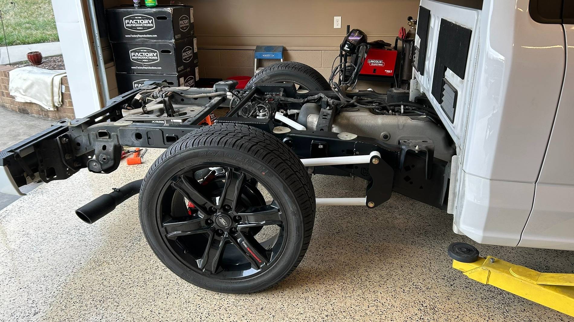

I was pleasantly surprised by the quality of the brackets and how nicely everything fit together. All the bars have an adjustable end so you can dial in axle placement along with pinion angle. Another bonus was I was able to finally center the axle under the truck. My axle was offset to the passenger side almost 1/2”. I tried adjusting when I did the RideTech…but not much you can do if the spring perches on the axle tubes aren’t exactly where they need to be.

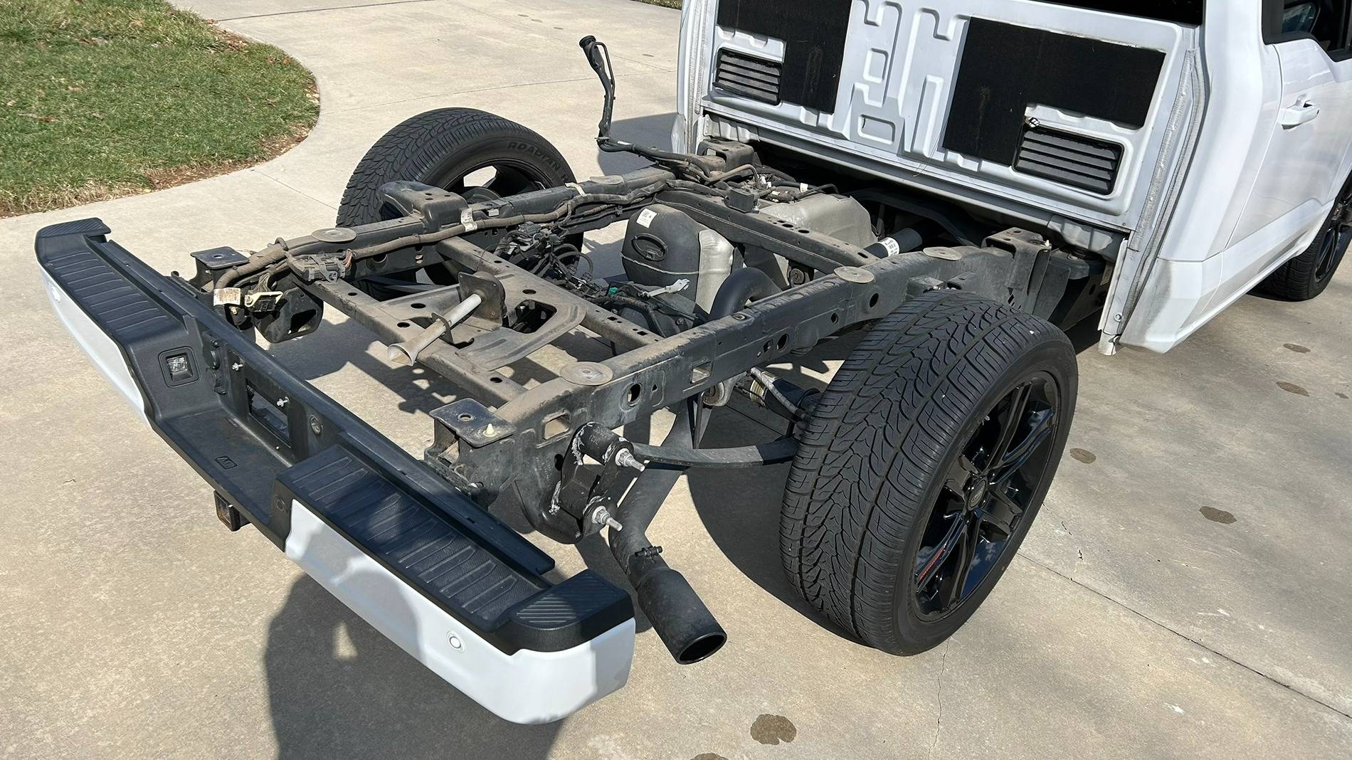

Did you have to cut anything on the bed?
Negative...everything fits under the bed without modification. I didn't have to modify my exhaust either, which was another plus.
If you look on Twisted Metalworkz website, you'll see the kit looks a little different than what mine does. His original setup had the coil overs located inside the frame rails...which meant you needed to relocate the tailpipe over the axle if you had one, and the rear brake line distribution block on the drivers side axle tube. Late last year I found a video on YouTube that they did on a new design that allowed you to leave all of that stuff alone. So I ordered the new upper coil over bracket that mounts the coil over on the outside of the frame rail. So depending on what you want, make sure you specify if you want the coil overs inside or outside the frame rails.
