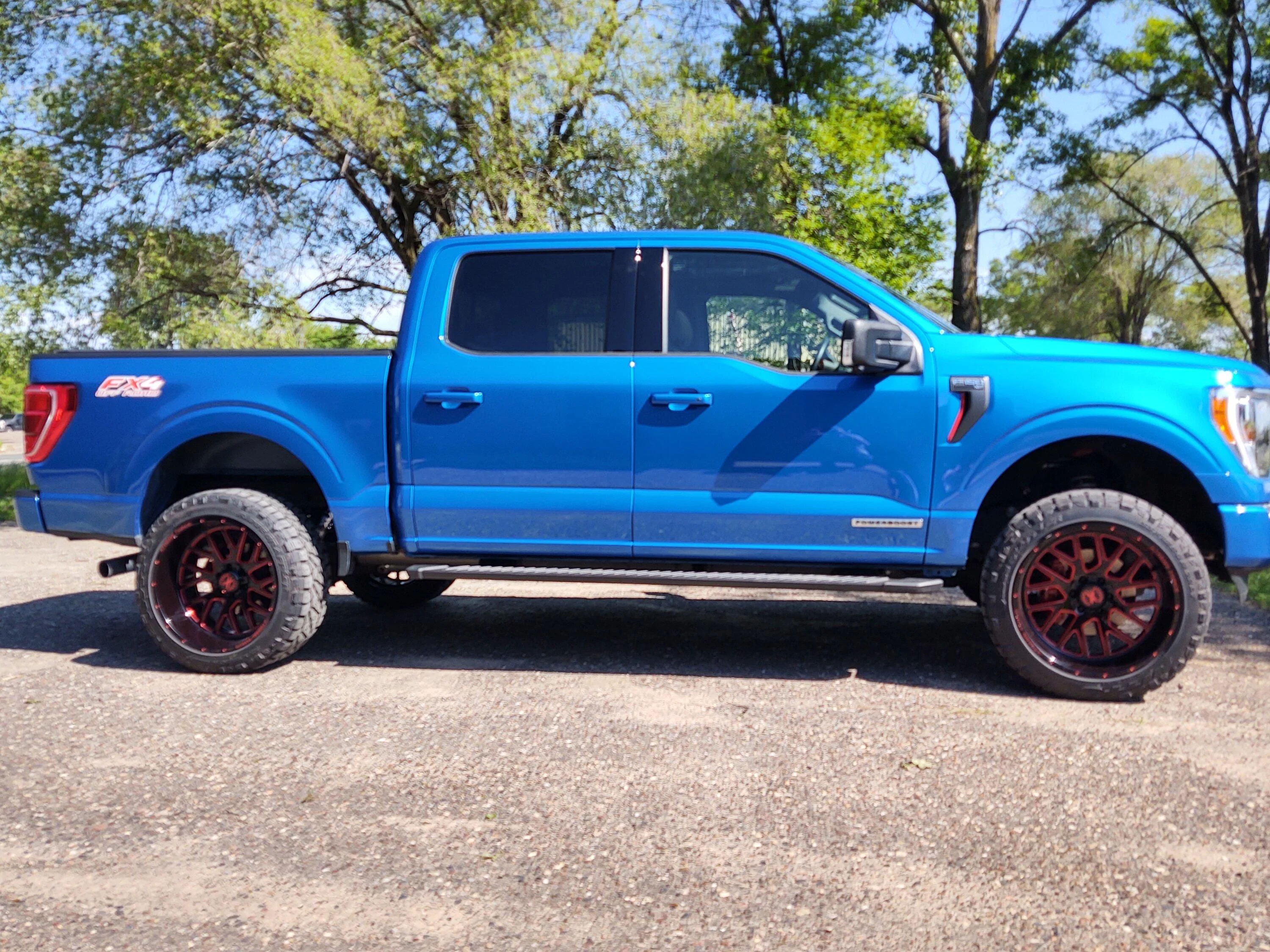

Fox 2.0 suspension. Cranked spring collar tighter another .5" and added a Autospring 3" rear block. Where you take out the factory 1.5" block and replace it with the 3" to gain 1.5" over the factory height.

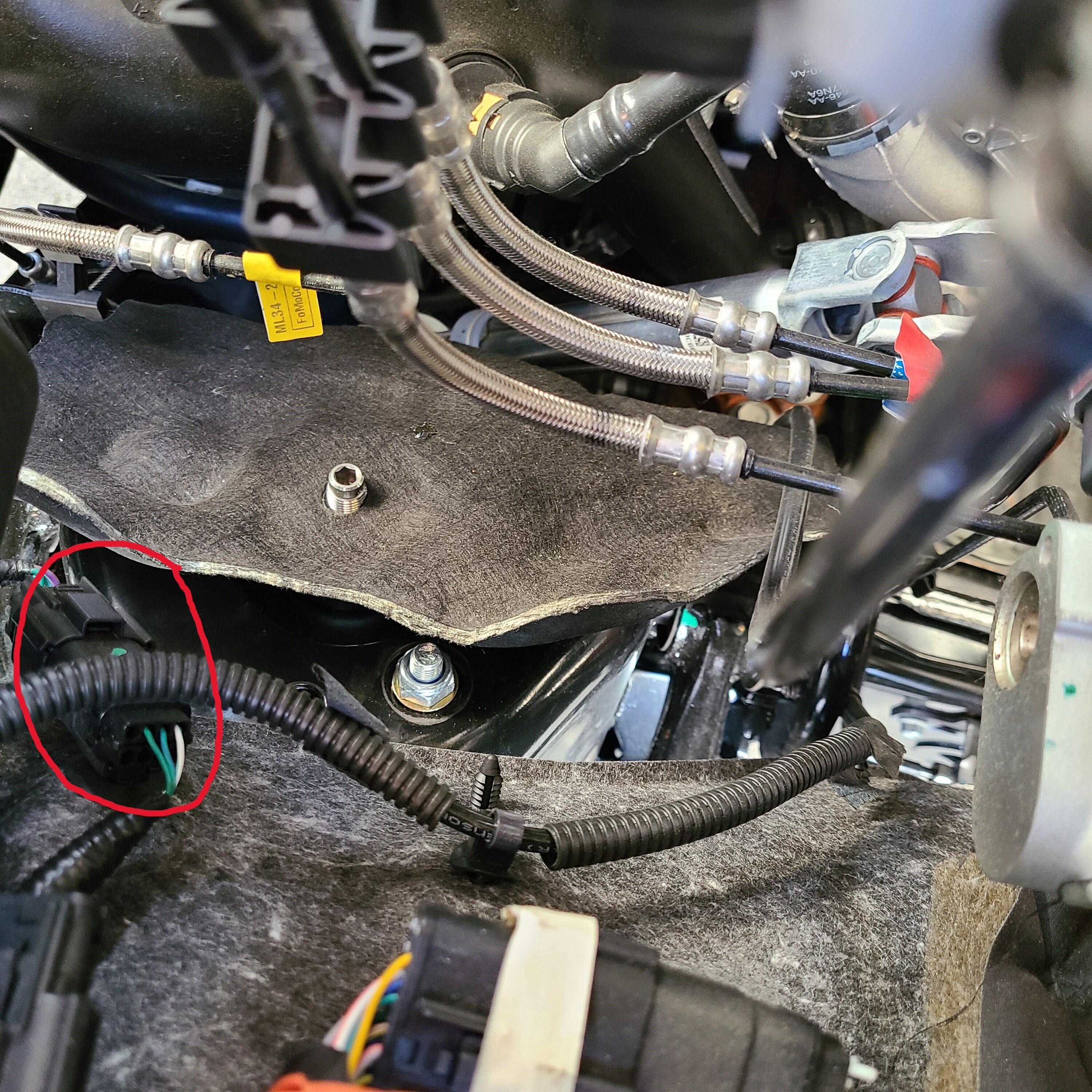

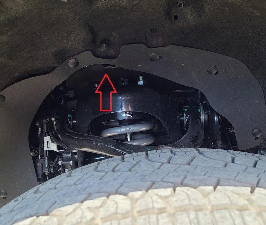

Just had mine installed today. Does anyone know how the shielding/felt on top of the coilover is supposed to look like?
Mine seems to be sitting loose on top for both driver and passenger side. This was installed at the Ford Dealer.

Yea its just loose like that, you can always trim it with scissors if you don't like it. Thats the driver side, there is a plug right there held in with that plastic retainer right above your red arrow so just be careful you dont snip any wire or anything

Strange. Just seems odd like it should be attached. I dont see any plugs from the top view.

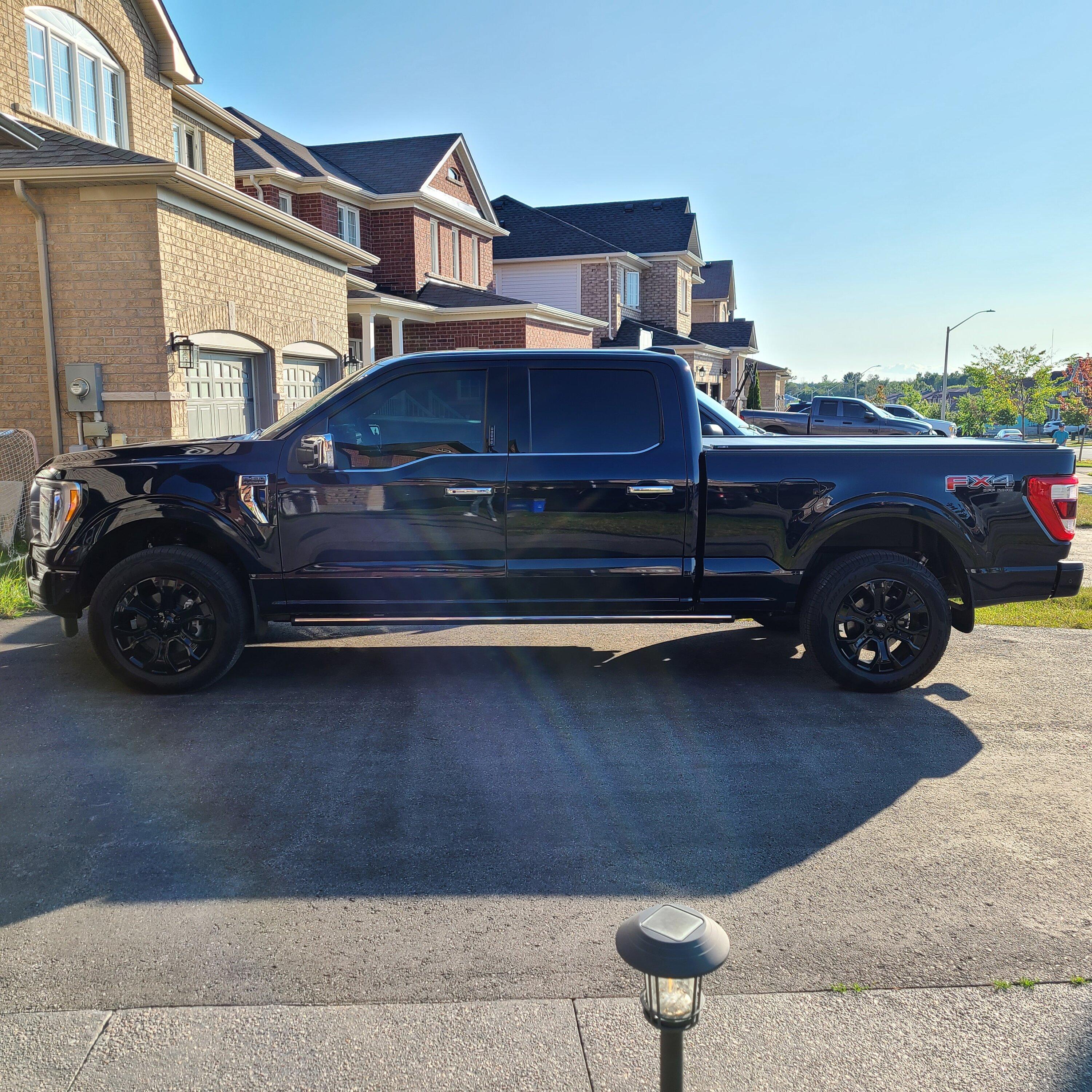

Can you share what trim your truck is and how much lift it gave you? Seems like people are getting less than advertised lift.
Platinum 3.5 EcoBoost
Definately not 2 inches but it is better.
Measures 39in from ground to fender in the front and just over 40 in the rear.

Factory block is only 1.25 so you picked up a hair more.
Gabe,
How much additional lift do you think you got by the extra 1/2”. I did the exact same set up and my rear end sits super high. What size tires you running as well. Truck looks awesome.
Thanks in Advance!

I'm around a total of 2.75"-3" of height out of the front end now. Tires are a 33's on a 12" wide rim.
