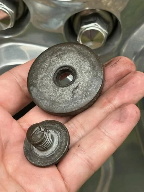

Mine is Max Tow package and the squeaking is most noticeable when brakes are applied. I would have sworn it’s the brake pads being worn down but after close inspection, that is not the case. I am aware of the axle bolt shearing off issue but from my understanding that would cause rather a rattling, not a squeaking sound
