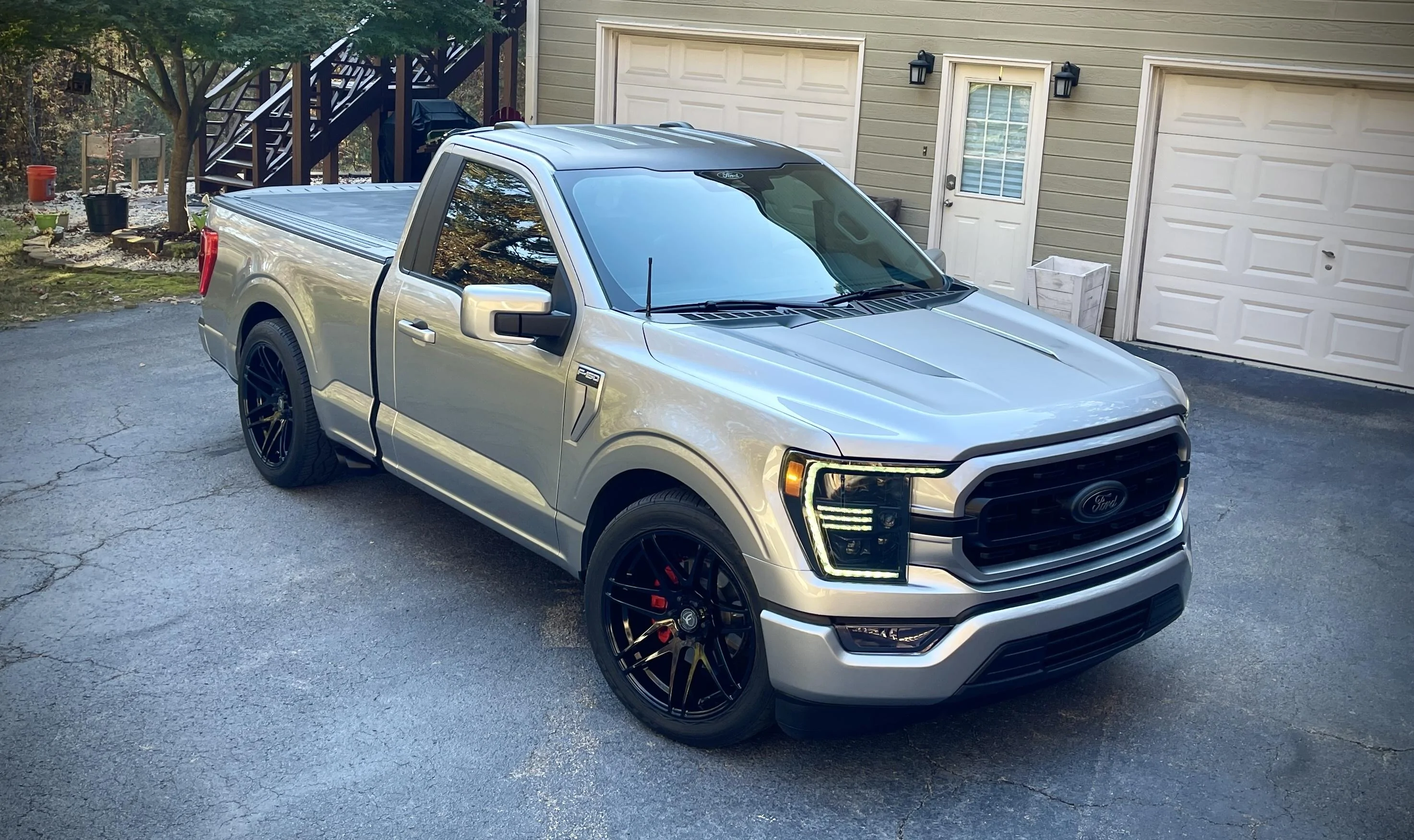

Hi I’ve got the pre axle black street (two muffler)kit from MBRP. No Drone what so ever. It’s quiet till you stomp on it then she gets loud. It’s deeper tone than the others out there. At 70 on the highway you can totally have a regular conversation. its a tight fit had to shorten the kit to fit . Love it As it’s not raspy. Told them to make the tips tight and angled them a bit versus coming straight out. The race kit that is for ours is the same it just has one muffler. if I wanted it louder I could go back and just remove one of the mufflers. Sorry i haven’t had the time to get any good shots from the side but the tips are there and they are nice double walled.

What did you do to the suspension to get that stance?

Hi this is a IHC 3/5 Ride Quality kit on a 4x4 xlt with factory struts upfront. its a flip kit in the back I all so have IHC helper bags in the rear that I normally put about 15psi for every day use. I bumped it up to 40 psi one time with 37 bags of mulch and it didn’t squat at all. 22” wheels 285/45R22. I like a little rake to give it that old school 68 muscle car look.

Love the black on the tailgate! Did you buy that or custom do it? Sharp looking ride!!!
