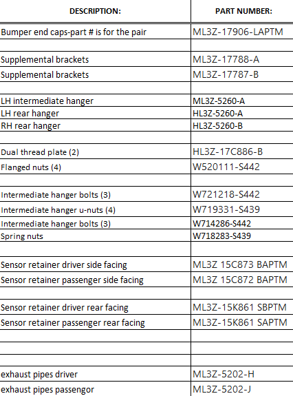

Did you buy the OEM one straight from ford?
I bought all the parts from Ford, except for the muffler and tail pipes. I hunted for months and could not find them anywhere at the time. Then one day a member here DM'd me offering his Tremor exhaust take-off.
Did they do the install?
No, I did it in my garage. I'm sure any muffler shop would do it for a small fee.
What’s the part number for the exhaust system?
There isn't one part number for the Ford "exhaust system" that I'm aware of. The member's here spent the time to research a parts list. A couple of things to keep in mind, what trim do you have? Do you have painted or chrome bumpers? I'm not sure the rear bumper end caps come in chrome.
Use ML3Z-17906-LAPTM if you have sensors on the side.
Use ML3Z-17906-KAPTM if you only have rear facing sensors (back up sensors only).
The rear back up sensors are relocated farther out to allow for the exhaust cut out. Therefore it is recommended you order the new sensor retaining rings to ensure the sensor faces properly. Some owners have modified the original part so it's up to you.
Note: Use ML3Z-17906-KAPTM Bumper Assembly Rear (no side facing sensors / only needs sensor rings SAPTM/SBPTM below)
