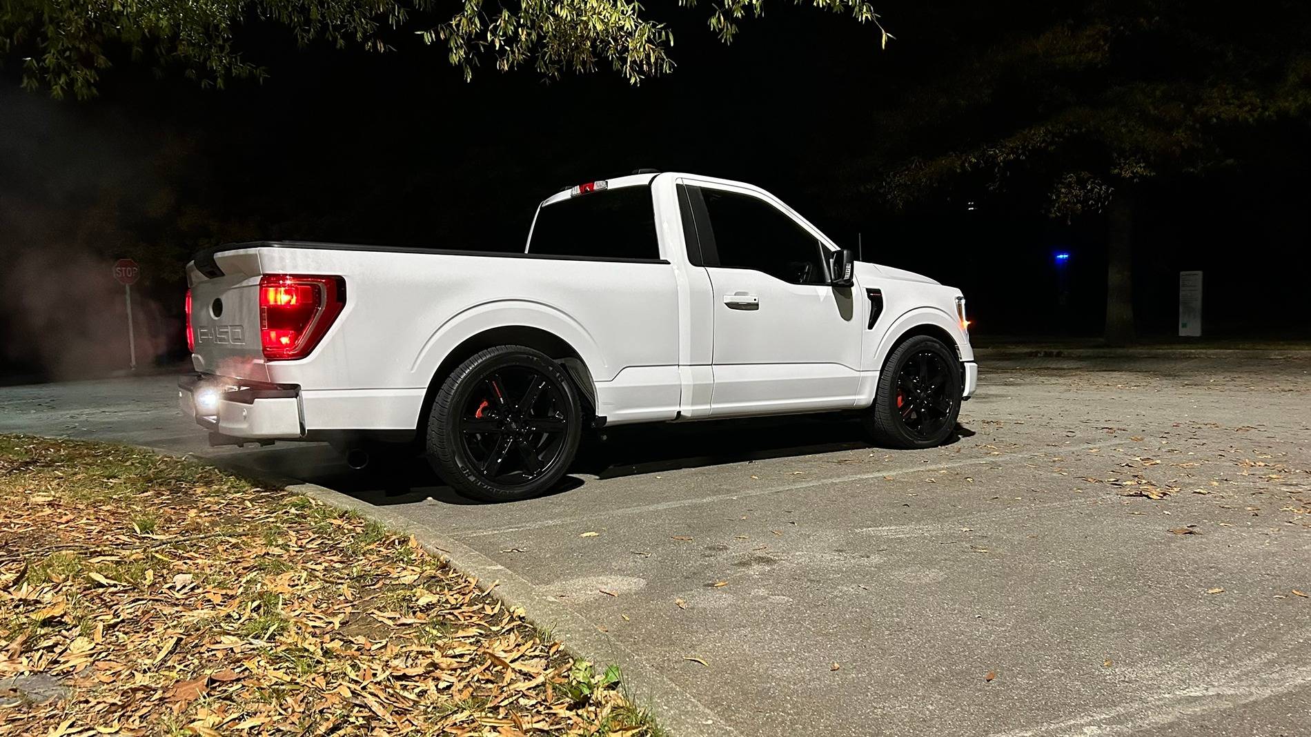

I spent about 3 hours Sunday cleaning all the old wheel weight glue off the back of my wheels. The new tires are taller and I raised my coilers about a 1/4 inch for a little clearance.
I put about 200 miles on the truck this weekend and could not be happier with the tire setup. The truck rides and drives like a normal F150. The tires are smooth as glass from 0mph until the speed cutoff at about 112mph. The ride and handling is 10 times better.

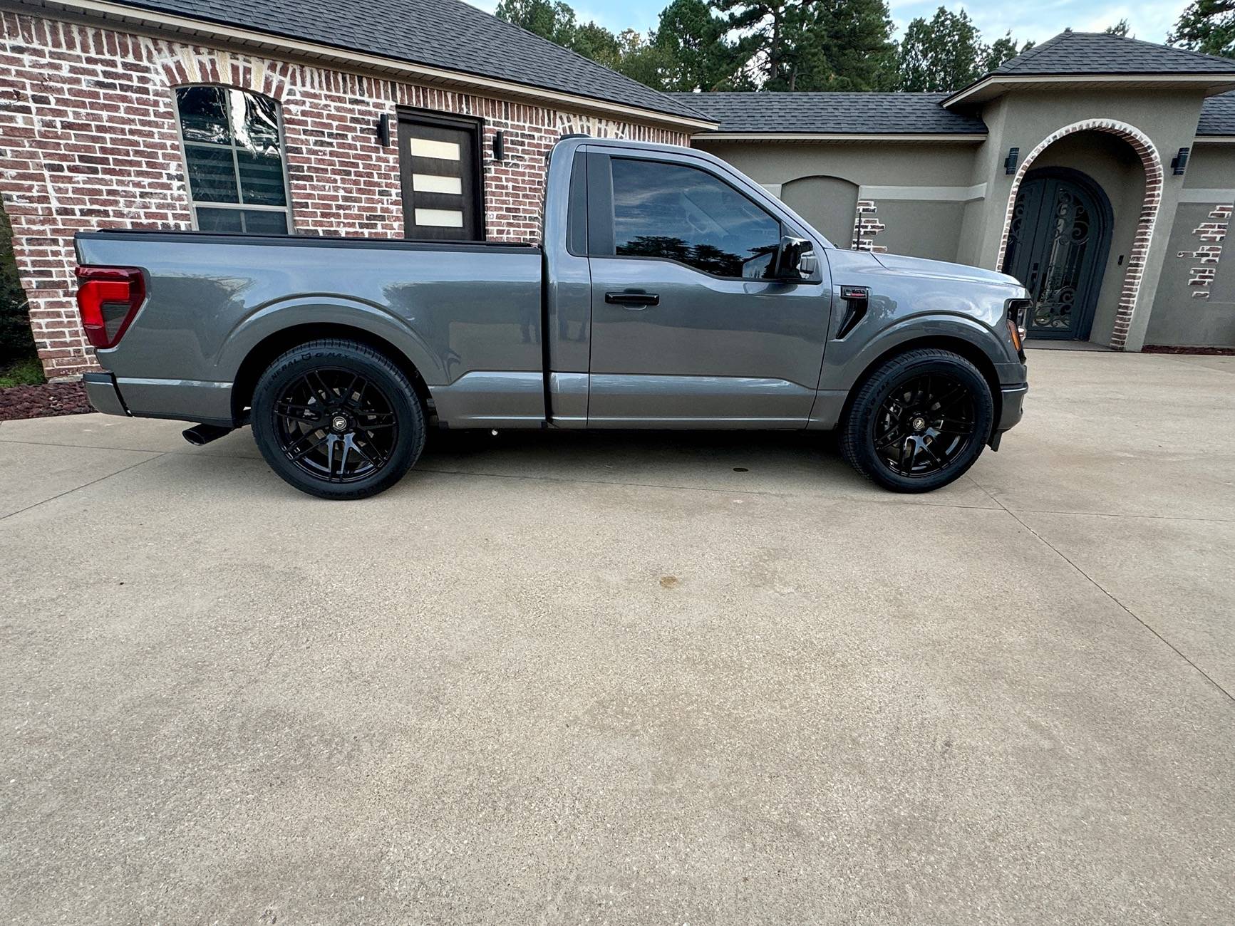

Here is what the ride height looks like with the composite helper removed with stock shackles.

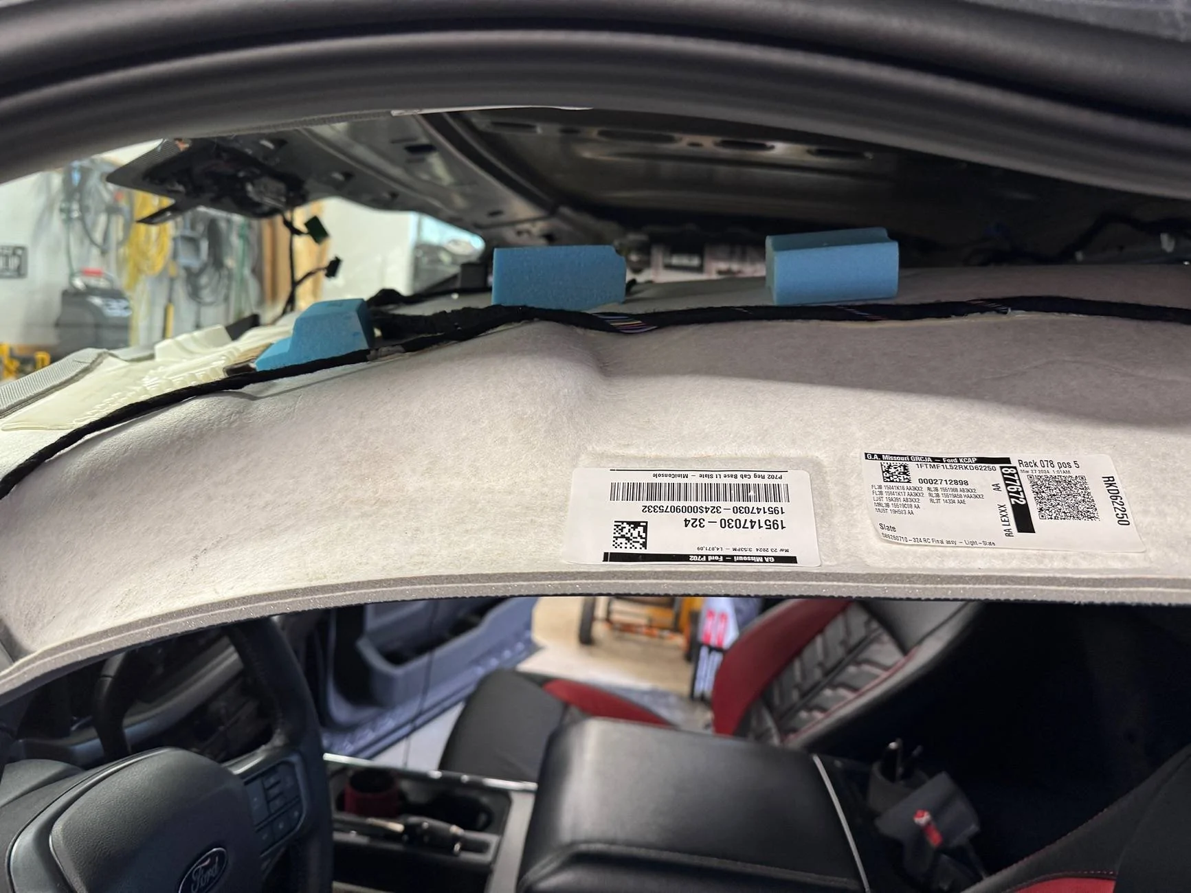

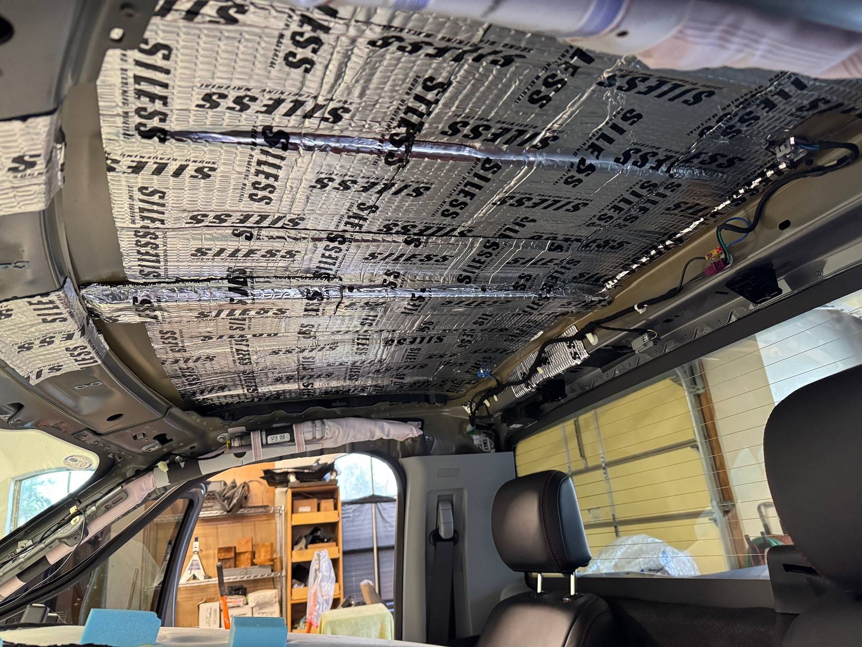

Since my family is not having Christmas until Friday, I spent Christmas Day adding sound deadening material to the roof of the truck. I had previously installed the material every where else.
Dropping the headliner was no big deal, but I did discover that ford glues all the cab wiring to the head liner. I had not seen this before. With the headliner hanging down, it's not much trouble to unplug the connectors except for the back corners. I did not remove the rear cover trim, so I had to stick my arm behind the trim to unplug the corner connectors. Unplugging was fairly easy, but getting them plugged back in took me a good hour.
Once the sound deadening material was installed, I got the headliner back in place, and ran the wiring for my Gentex auto dim and home link mirror that had been lying on the tool box for months. I bought this mirror for my old ZR2 from Bob's mirrors. He sent me a harness for the mirror when I bought the Ford that needed to be run to a power and ground source.
Everything was good went well on the install, other than the mirror does not Work. I think the harness is pinned wrong. I sent Bob an email, so hopefully it can be fixed with a pin moved.
