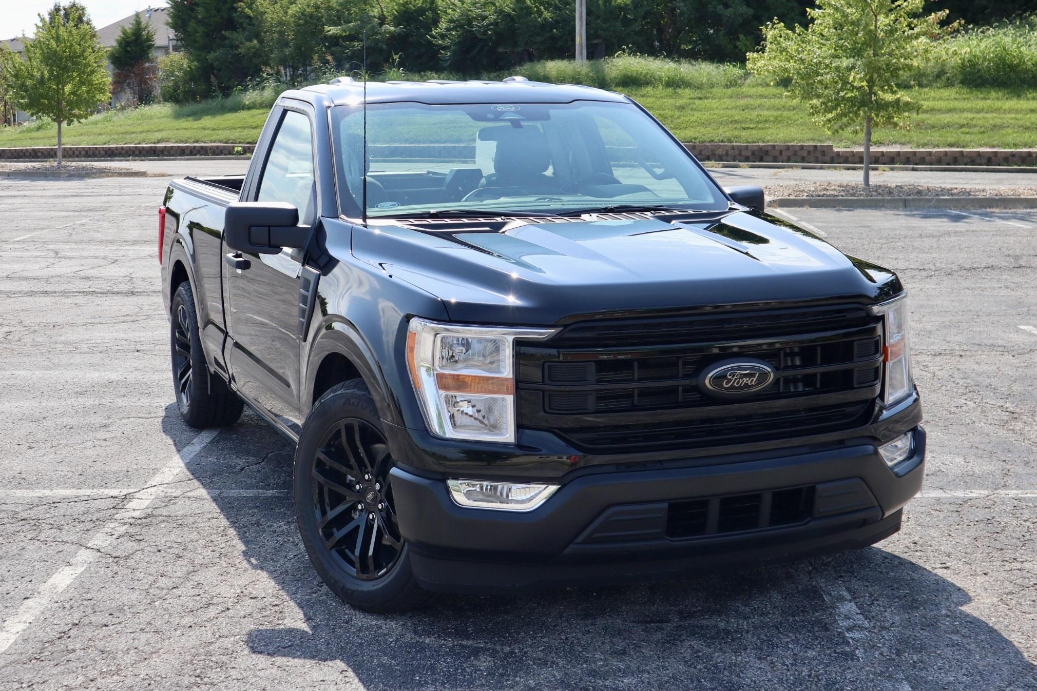

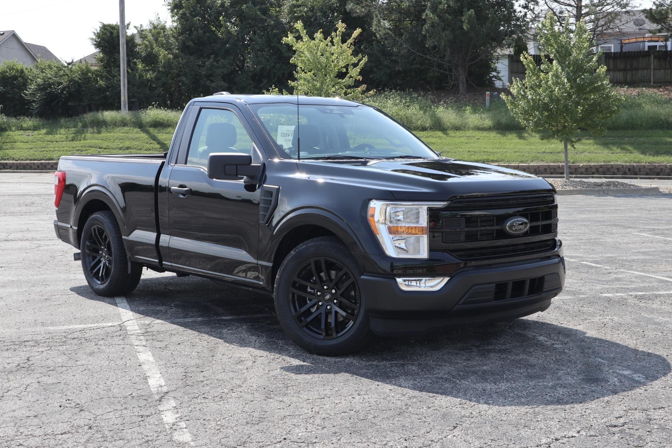

Little to no poke, fitment is very much flush IMO.

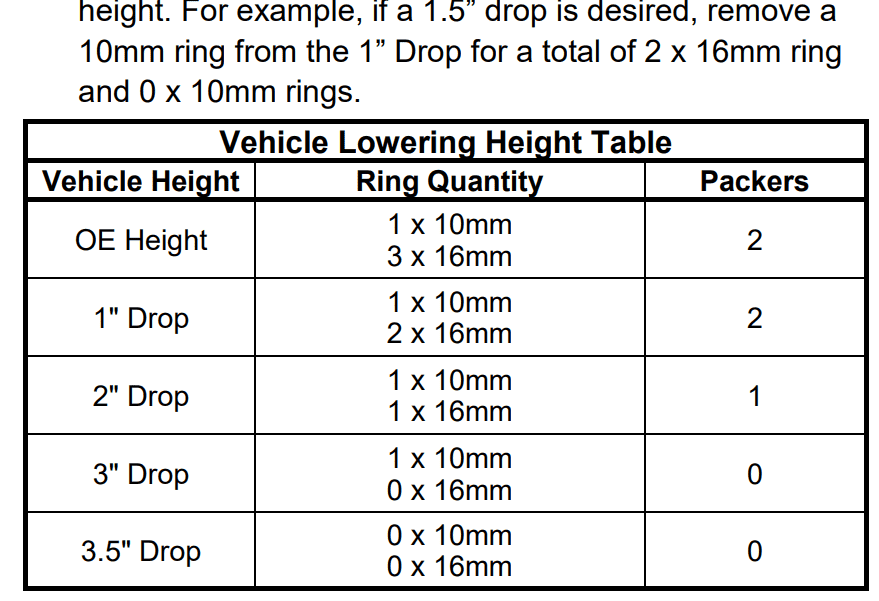

Measurements to top of wheel arch:
Front 36.5" before & 34.5" after = 2" drop
Rear 40" before & 36" after = 4" drop
3.5" of rake down to 1.5"
Belltech's chart for the front struts is not entirely accurate. I followed their example of using (2) 16mm rings per strut hoping for a ~1.5" drop, but after settling I've net a true 2" drop. Not really a big deal, I just haven't seen it mentioned by anyone else. I'm certainly not taking the front apart again just to raise it 1/2" :ROFLMAO: The flip kit was simple enough to install and net a true 4" drop as intended (I installed Belltech 6447, which is technically for 13th gen but everything worked out fine). I also added shorter Fox 2.0s the rear.

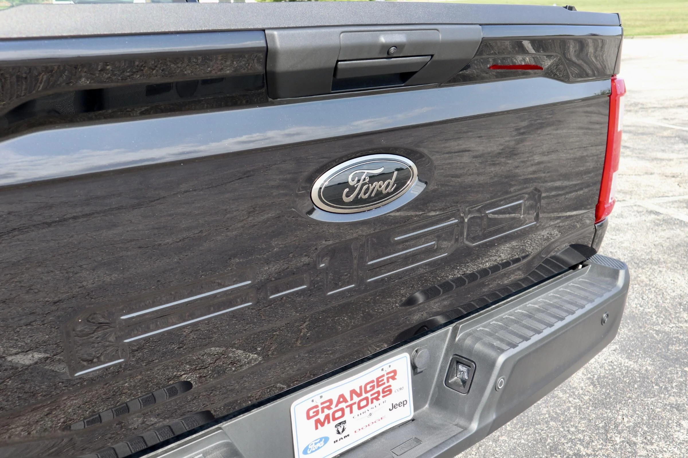

*Obligatory @Granger Ford shoutout :LOL:
I know you ended up modifying your Lariat grill but how did you fill the notch for the hood release on the BAP grill or did you just edit the picture?
