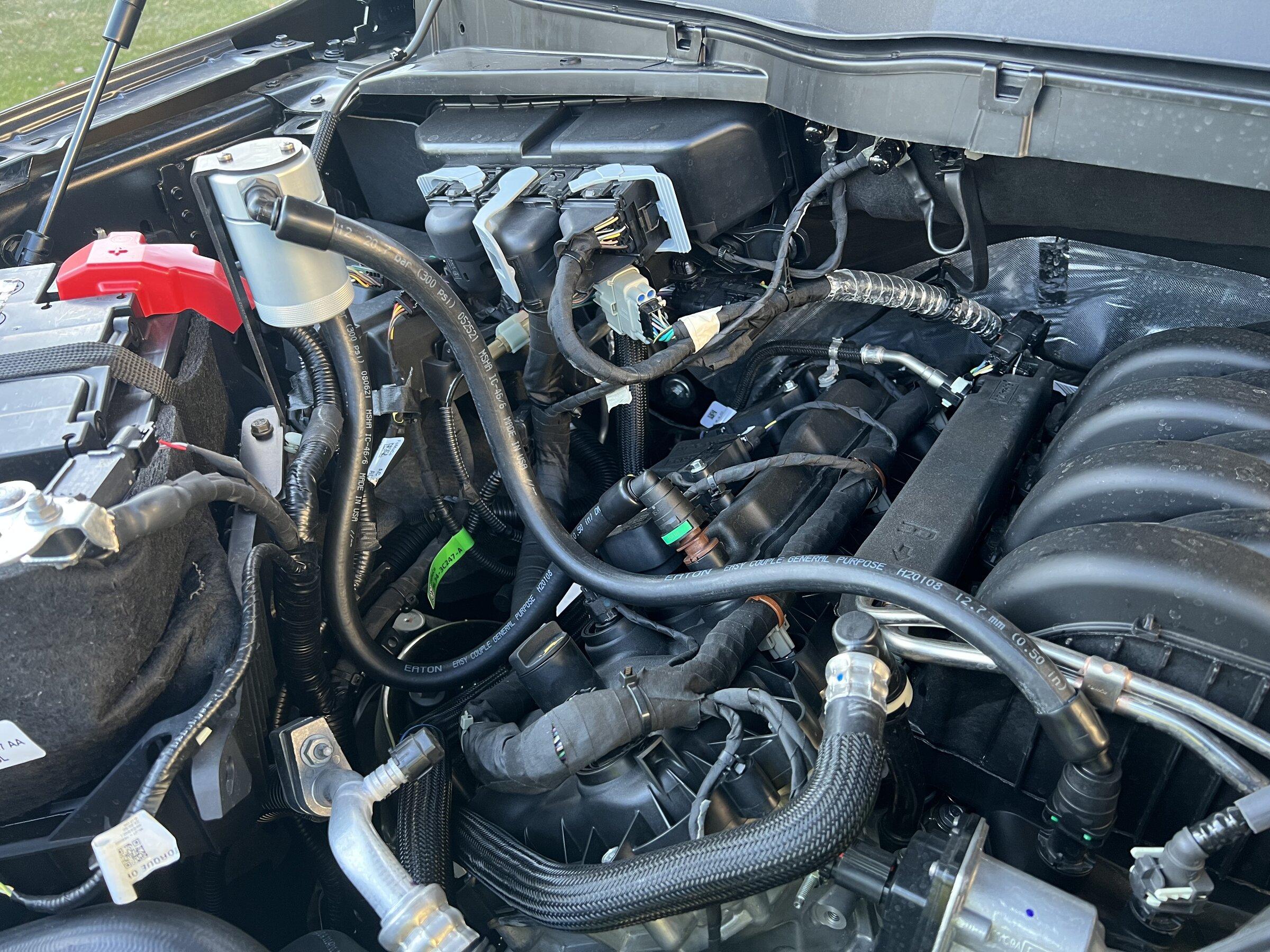

Next was the JLT oil separator. When I popped the hood to install it, I noticed the assembler at Ford had left a large rubber band stuck in the factory hose.
Funny, when I got my 2020 XLT it had a rubber band under the hood but hanging off valve cover for dear life, lol. When I got my 2023 Tremor 402A with 5.0 it was missing the cold crank case vent tube... Excellent QC...

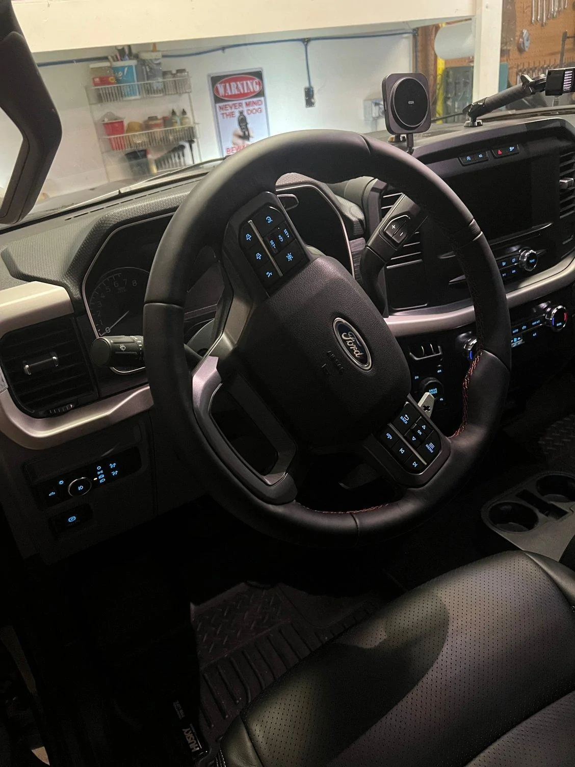

2021 RCSB F150
RAPTOR WHEEL!
I have enjoyed the XLT leather steering wheel but always regretted not having one that was heated in the winter. The Raptor wheels have heat AND paddle shifters that should be fun to play with.
I found this 2024 Raptor wheel from a seller on Facebook. I really like that the center stripe is textured black instead of red like the previous years. I think it will go better with my interior.
My truck doesn’t have all the features that the Raptors do. I also don’t want the trim with “Raptor” on it since I don’t have one. So, I swapped the trim and buttons from my XLT wheel onto the Raptor wheel. It has a lot cleaner look.
To make the paddle shifters work, you need a plug and play harness. CSS Automotive Lighting, LLC offers them in specific versions for column shift or console shift trucks.
In order for the heating work, you need a conversion harness, a clock spring for a truck with a heated wheel, and Forscan programming. I ordered the harness from CSS but had to buy the clock spring from Ford. They used to sell them for $60 but recently jacked them up to $200!
I’m impatient and like immediate rewards. So, tonight I installed the wheel and swapped the trim and buttons just to see how everything looks and feels. I realize I will have to take it all apart again when the harnesses and clock spring show up.
I don’t care! This thing is awesome! It’s way beefier and the leather feels much nicer than my stock wheel. Can’t wait to complete the swap!

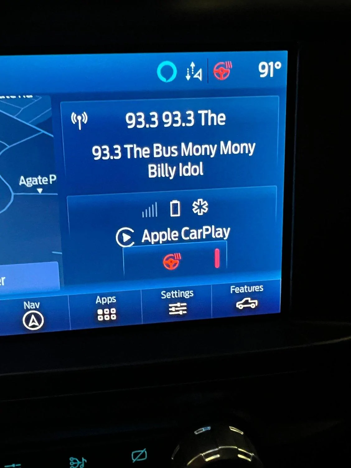

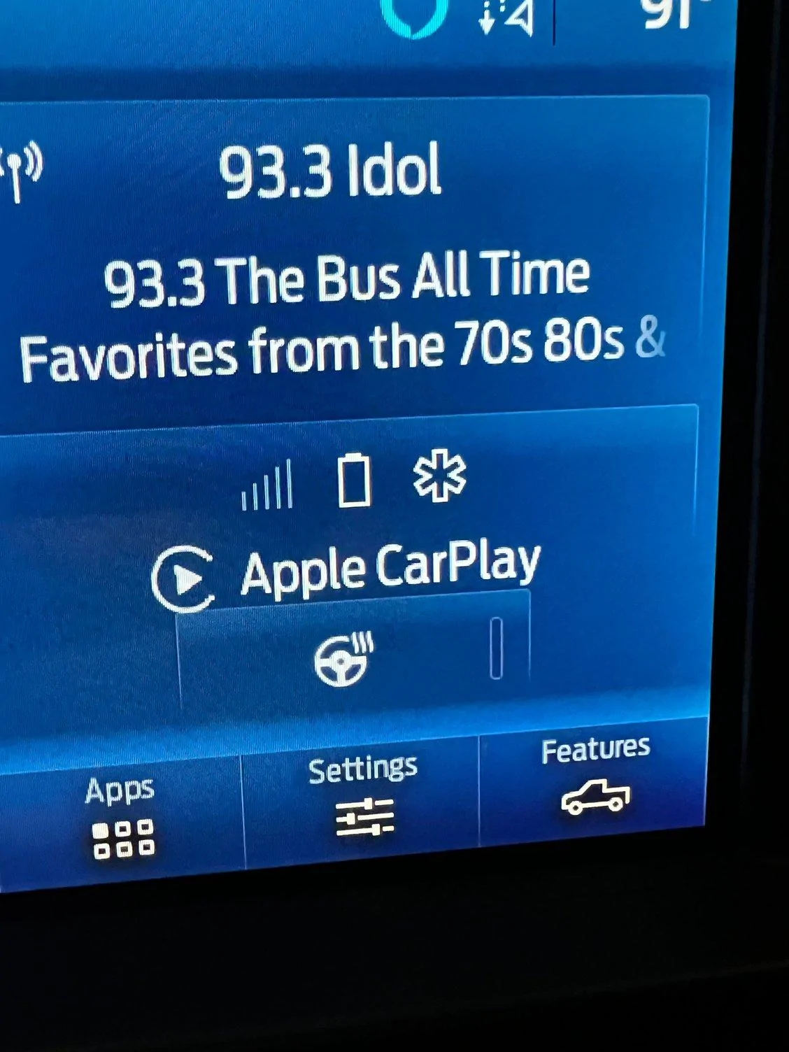

Raptor wheel is fully functional
Today I finally got around to running the wiring harnesses for the Raptor wheel. After some
Forscan programming, everything is working perfectly!
The flappy paddles are fun to play with and the heated wheel gets nice and toasty. Now I’m all set for winter!

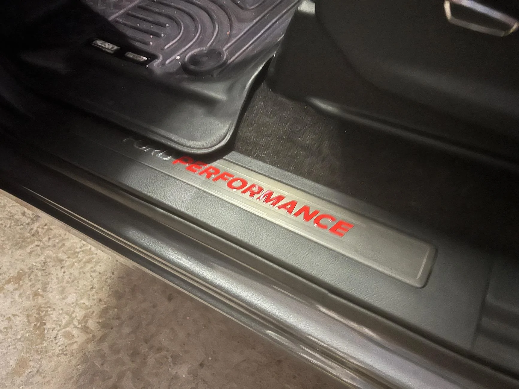

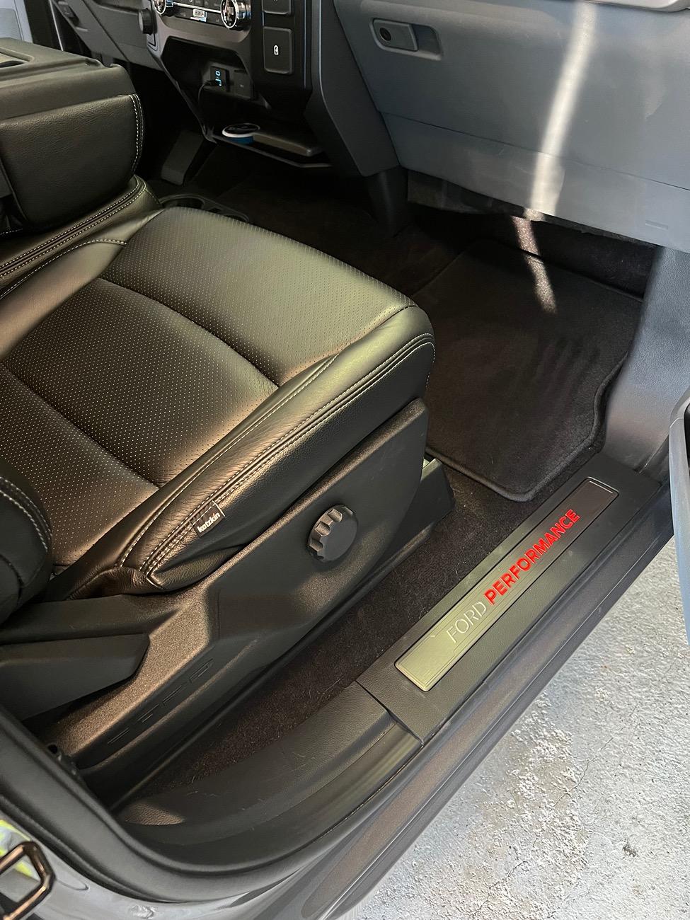

Ford Performance door sills
Picked up a pair of Ford Performance door sill plates. I think they look great!
I was worried the Husky floor liners would scratch them so I put the factory carpet mats back in. I kept the original sill plates and will put them and the Husky liners back in for the winter.

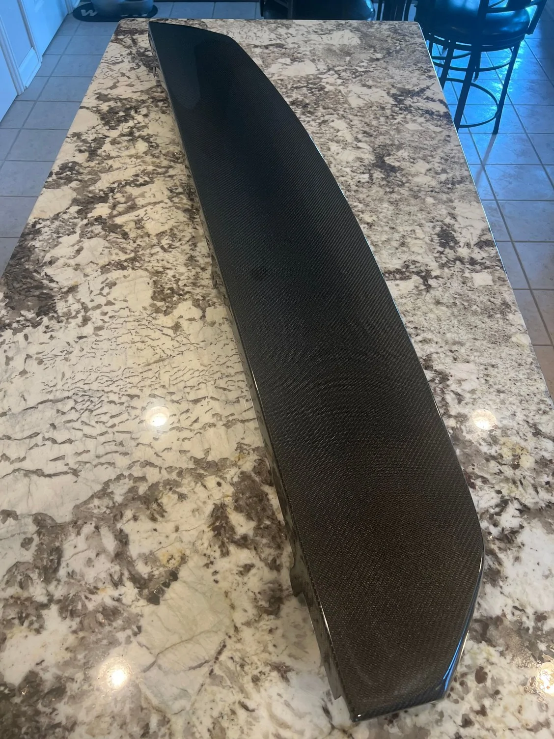

Anderson Composites carbon fiber tailgate spoiler
This spoiler replaces the factory tailgate top cap. I also had to remove the clamp pockets to make it fit right.
It’s really a solid piece as it mounts with 8 bolts through the top of the tailgate and 4 factory push type fasteners in the front edge.
It ain’t cheap but dang it looks good! It really ties together well with the carbon fiber splitter on the front.

This looks like the original Saleen rear spoiler and not like the one they currently offer to the general public which is a copy of the Air Design spoiler. I didn't like the idea of a rear spoiler that attaches with double-sided tape and it didn't have enough "flip" to it. A guy on FB offered one similar to this made of fiberglass, but it also attached with tape. I know I'll get it, but I have to go through the 47 stages of I want it, but it's a grand.....but it will look great.....but it's a grand......but it'll look awesome......it's what I've been waiting for.....but it's a grand......IYKYK.
PS--It looks GREAT !!!!! And I'm glad Anderson Composites did it right.
