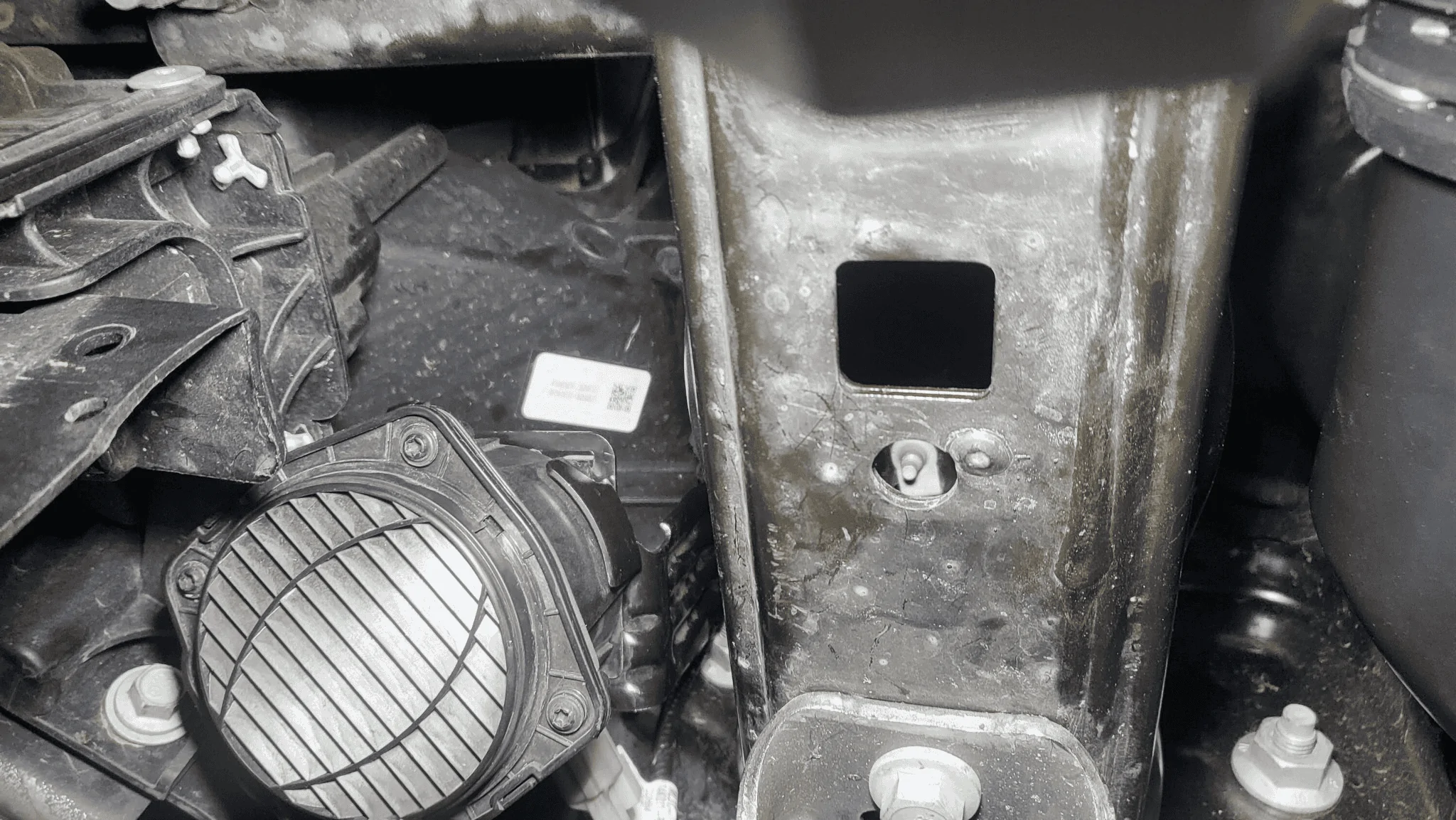

Yes there was an error/warning
I just can’t get my get the pa on the bracket.
did you install the pa on the bracket before putting it back?
Yes I left PA attached to mounting bracket. Also plugged in cable before inserting it into open area. The hole under square hole is one of the mounting hole for PA bra ket. I used just that hole to secure PA it feels pretty solid after tightening bolt. I was going to zip tie as well but felt it was secured enough.
I can remove mine after work and reinstall with recording. It's kinda hard to explain but worked out perfectly once it's in.
Ya I’ll try again later it was getting late last night. The intercooler was the easiest thing to do. But that PA is a pain

I'm installing mine right now and there's no way to get intercooler in without removing PA and mounting bracket. Not sure if wire is long enough to remount somewhere else. I'm leaving unplugged for now.
The Livernois intercooler will clear the Powerboost speaker and you don’t need to remove that rectangular plastic trim piece. Not trying to be a fanboi but it’s a legit drop in. I don’t know of another intercooler where that’s the case.
