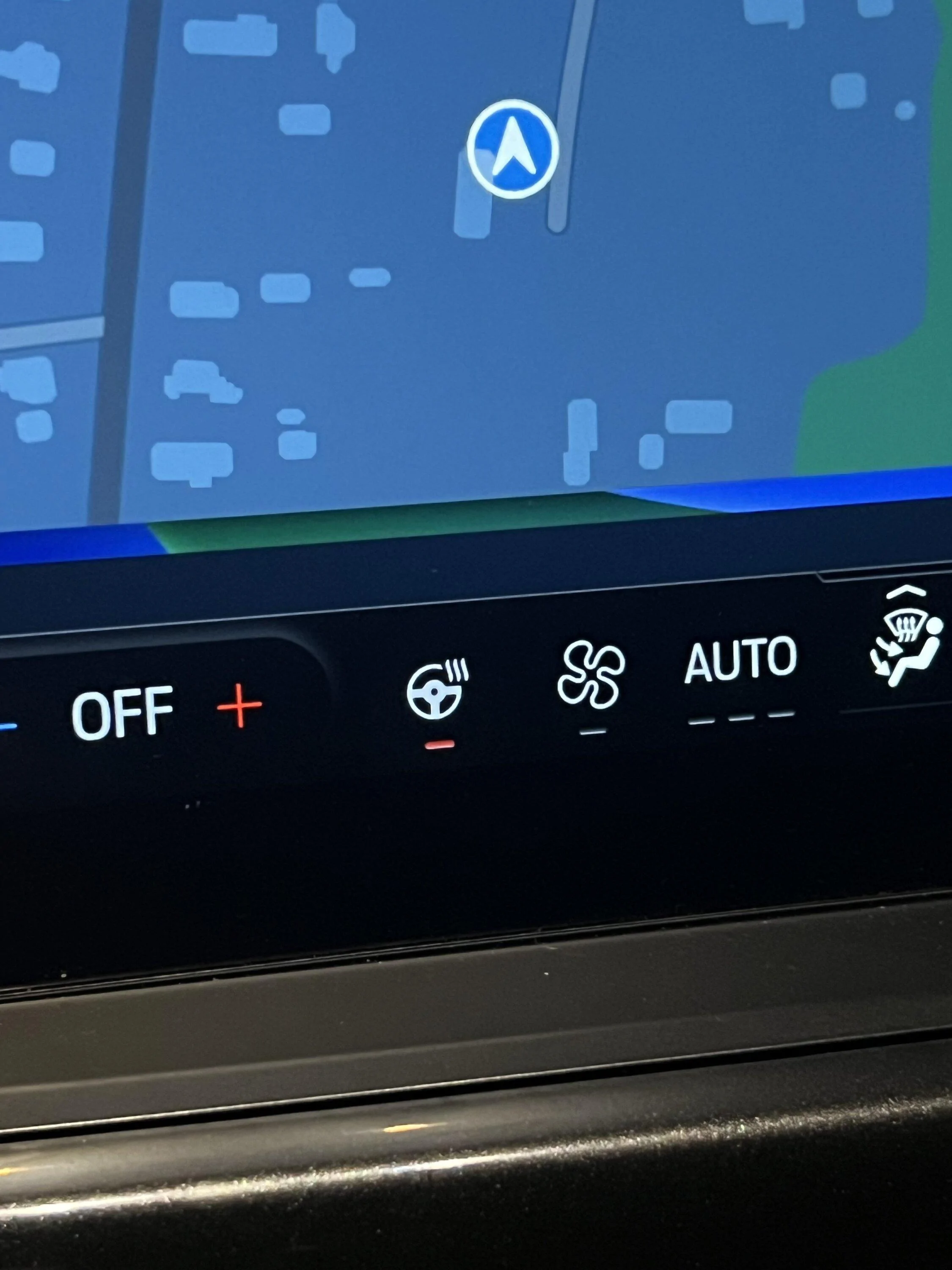

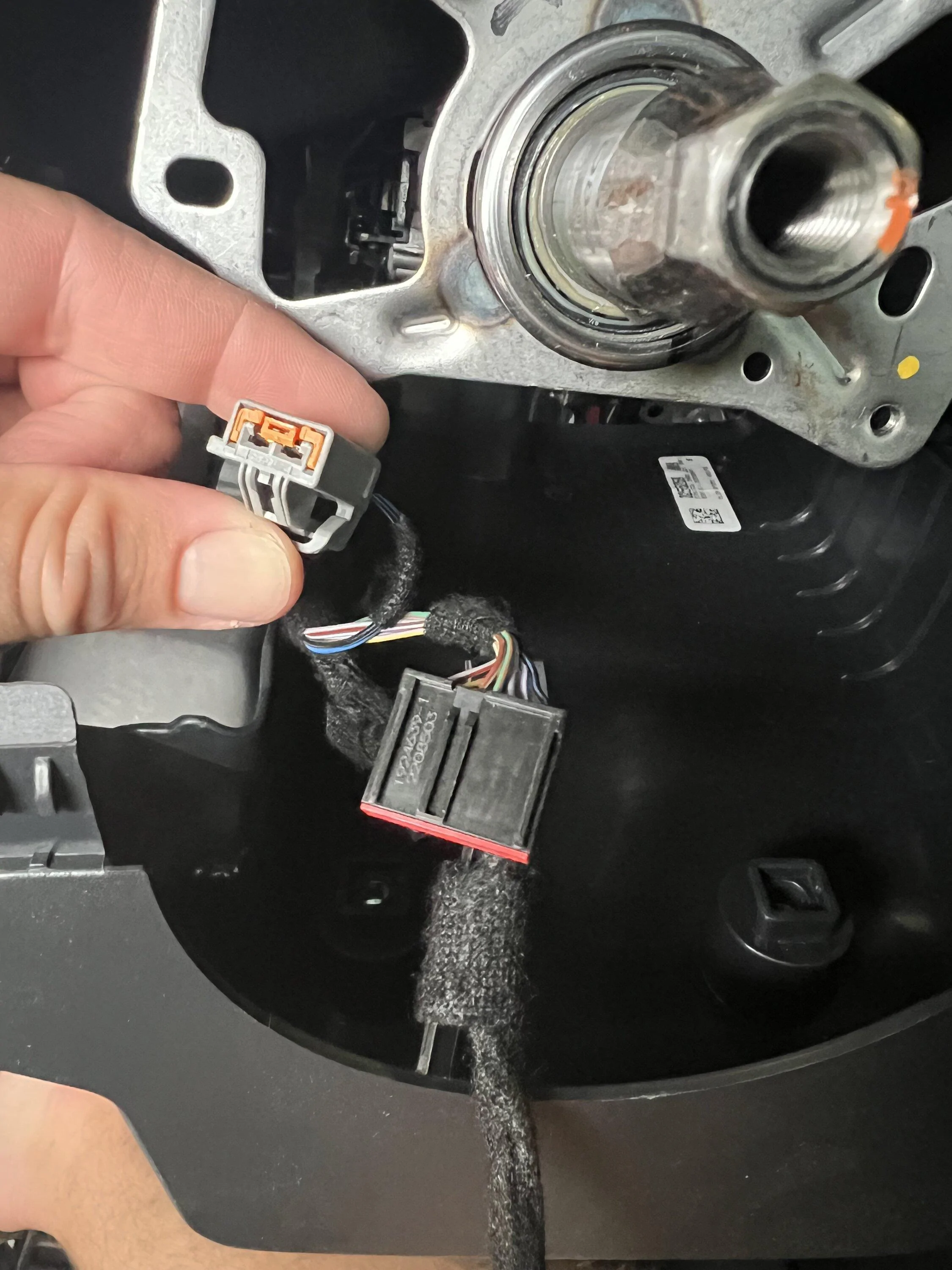

Added the heated wheel to me 2023 F150 Powerboost XLT.
The truck needed the heated wheel, SCCM and the new bolt. I took off the power telescope off the SCCM, not needed. My truck was PREWIRED as an xlt. The harness was in the dummy plug on the back of my original SCCM and already ran to PIN 15 in the respective harness. My forscan changes are below, this added the soft button to the climate bar. Everything works. I just need to see if it works with auto climate on remote start when it gets colder out. Thanks to Livnitup and JMoney17$ for their help as well as the others on this forum!
APIM 7D0-02-03 xxxx xxx1 xx--
APIM 7D0-02-02 xxx2 xxxx xx--
APIM 7D0-02-01 xxxx 5xxx xx--
After changing these values go into the wrench icon in FORScan and reset the APIM. This should add a climate bar on your screen with the HSW button.
Enable the HSW in the SCCM here: 724-01-01 xxxx 8xxx --
Enable the HSW in HVAC here: 733-01-02 xxx9 xxxx xx--
