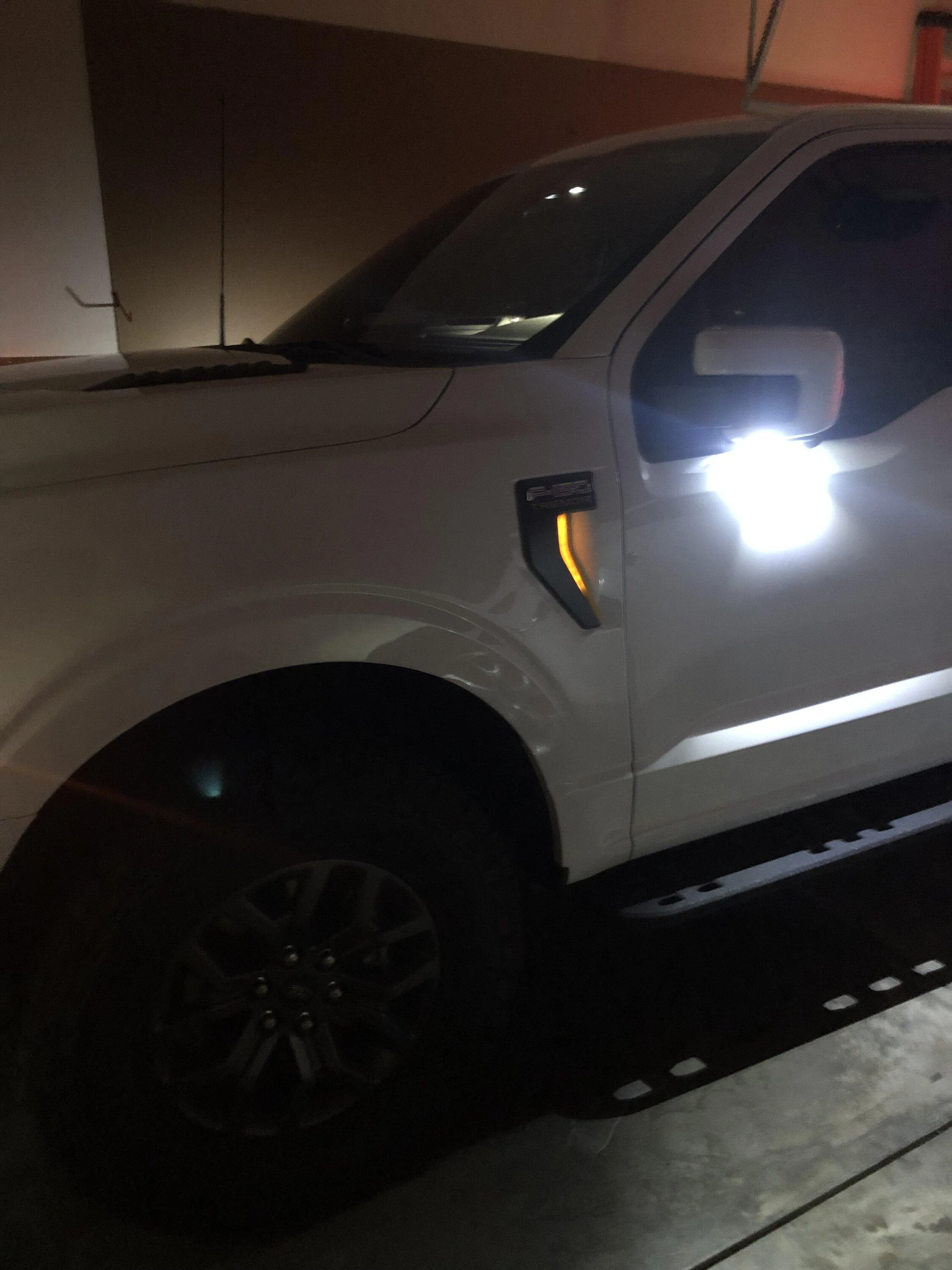

Just wired up my ambient side vent lighting. Terrible instructions for F150Leds, they had no instructions for the led headlamp wiring. Thankfully I found a guy on here with the proper wiring colors. See attached.
Ford F-150 Wired up my side vent ambient lighting LED (proper wiring colors inside) 7D4CF182-F000-4581-BADB-49A37FD3F876
Ford F-150 Wired up my side vent ambient lighting LED (proper wiring colors inside) E2DD77F0-BF1B-4B8F-9C53-8C82B83D405A
Ford F-150 Wired up my side vent ambient lighting LED (proper wiring colors inside) 25C663D2-7C02-40A5-A6F4-2600E5B87150

Did you put the light behind the vent or on the outside back edge?

I side the vent

I can walk you thru it, the kit comes with adapters, but I bought better ones at Lowes. The ones in the kit did not work well, both sides were loose connections

You will like them, very subtle but looks very cool! Keep the post with the wire color guide handy, F150Leds does not send instructions. When you watch the YouTube video it is on an STX without led lights. Totally different

If you decide to do it, I can walk you thru it. Keep the guide I attached with the colors showing ground vs positive. It is spot on

Not sure that you looked into the website or not, but I did mine with leftovers from various LED lighting projects. And I did the entire installation from directions off the website page I’ll list here https://cdn.shopify.com/s/files/1/1754/7317/files/2021_Vent_Lighting_1__watermark.pdf?v=1623940814
Honestly I could not justify paying $79 for stuff I had or would pay$20 total for.
Ford F-150 Wired up my side vent ambient lighting LED (proper wiring colors inside) FD5017E3-0F21-4A50-9717-3DAA9ACDCDAA
Ford F-150 Wired up my side vent ambient lighting LED (proper wiring colors inside) 3CE870EB-0AC3-4F7C-BF9B-FF0E91962BA8
