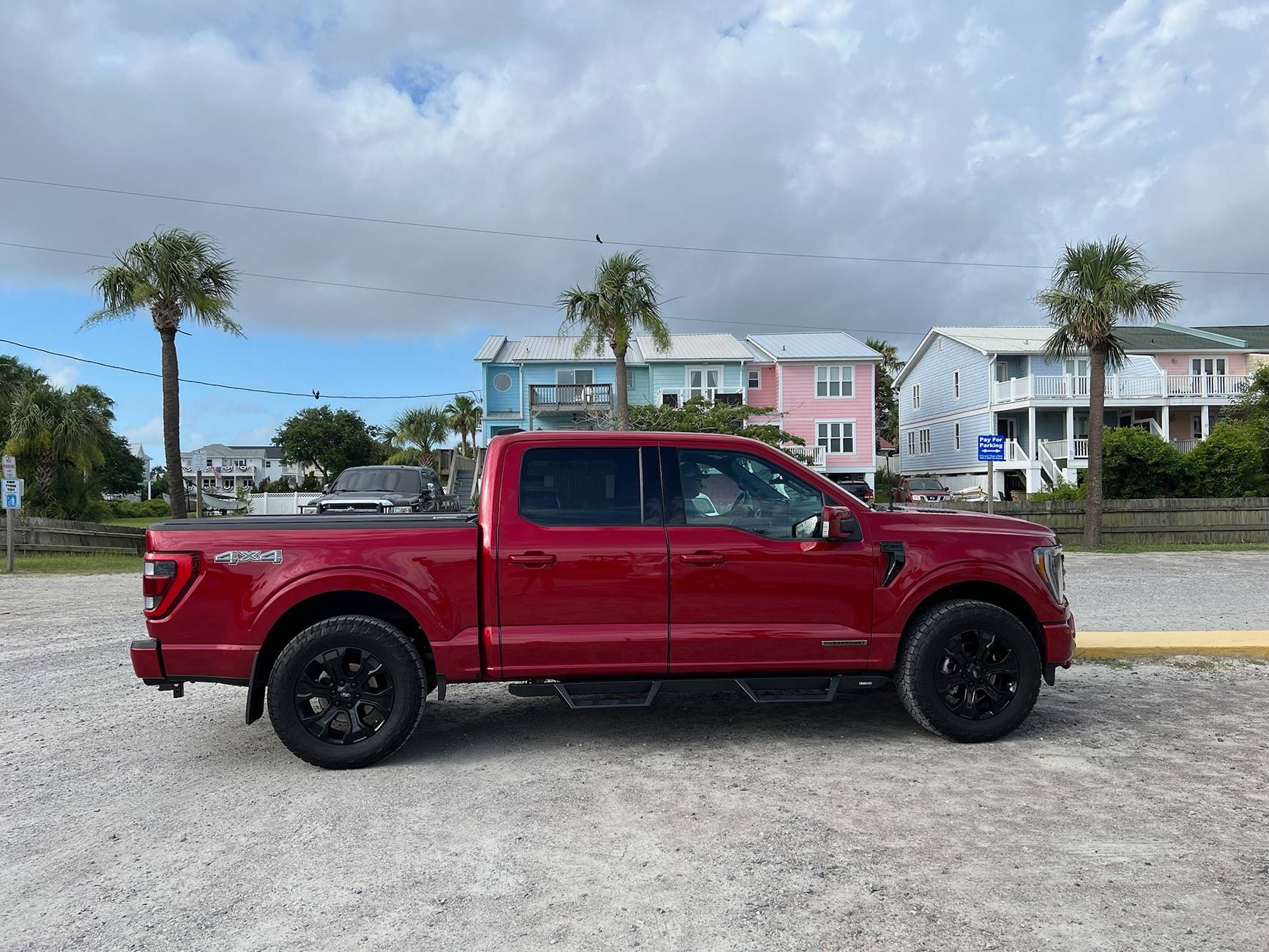

I have 275/65 20 Recon Grapplers- they are the SL flavor, so only 47 pounds- or ~5 lbs. more than stock. Small hit in mpg (~1 mpg). No road noise increase-and actually a better ride in my opinion with the extra sidewall. I think if you go too much beyond that you will start seeing degradation to your mileage.
Don’t forget to recalibrate for the increased tire circumference - pretty easy to do in Forscan.
Lots more info on this in the “Aftermarket tires on stock wheels” thread on this forum.
Good luck with your decision!:

Looks really nice, and you're on the stock suspension?
