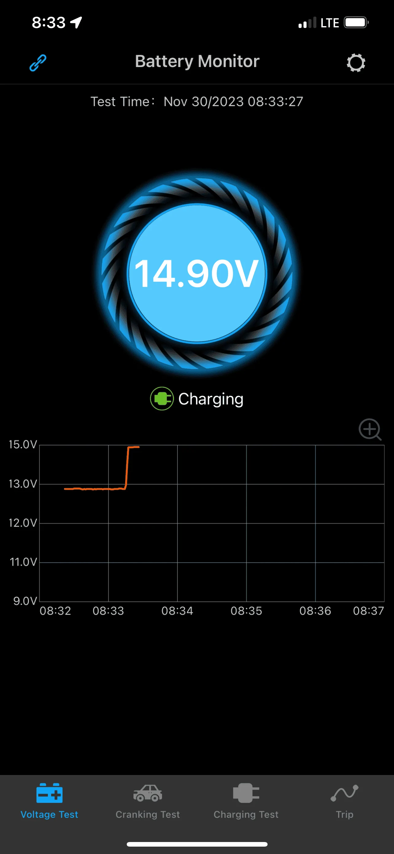

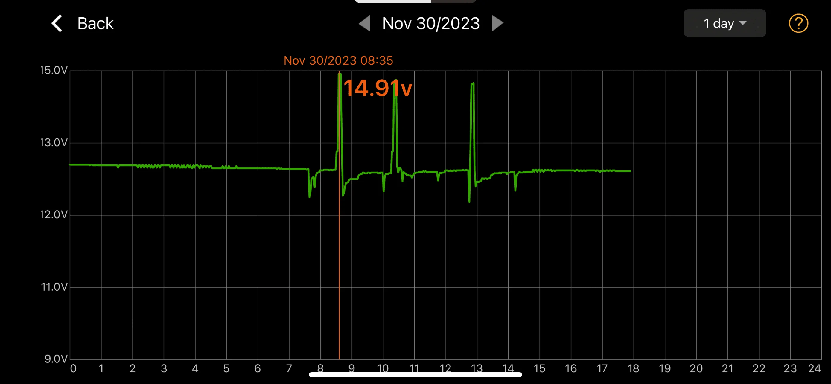

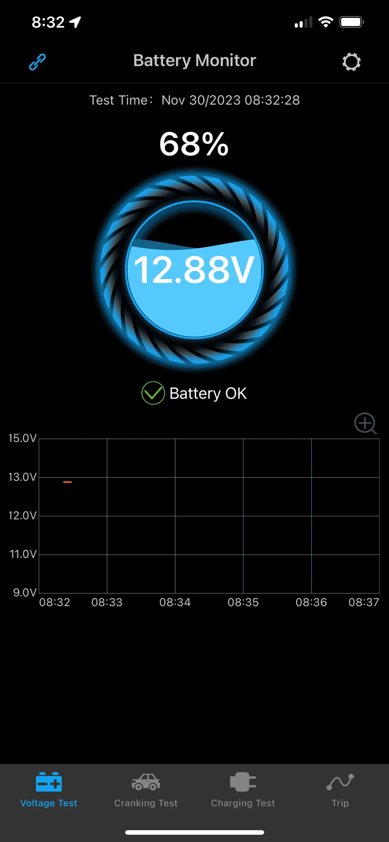

I was trying to figure out the same thing and today these are the reading I was getting from my BT battery monitor.
Before remote start: 12.53V
After remote start: 12.88V
After actual start: 14.90V
There was definitely a spike after remote start but app is considering it to be charging and unfortunately soon after remote start I had to jump in and drive away. I will test the same thing tomorrow morning and allow the remote start to span for 10-15 minutes before starting the truck.

Way to go Shane!
The only thing that we don't know is how much charging current is in play with the remote start?
You clearly show that with the remote start the DC/DC converter is active.
The voltage increased from the static voltage of 12.53 to 12.88
I know folks wish it would increase further, but in my opinion it's more important to see if the DC/DC converter is actually providing enough amps to provide some charge to the battery.
Or put another way, I will take 12.88V with 10amps of charging current over 14V with no spare current (amps) for the battery to consume.
I think we need to remote start and then launch OBDlink to see what the 12V Battery Current reading is.
Is it a trickle?
Or is it 10 amps or more?

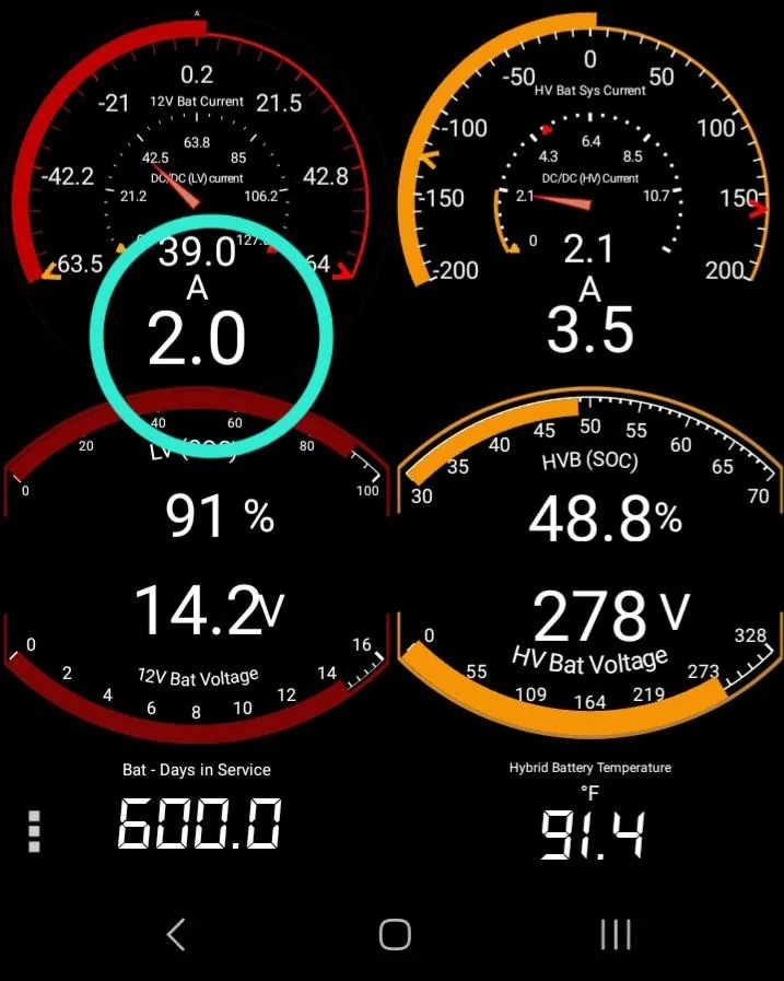

How exactly is the current being limited? Battery positive post measures 12.53V. DC/DC converter output is over 14V. Is there a variable resistor in series?

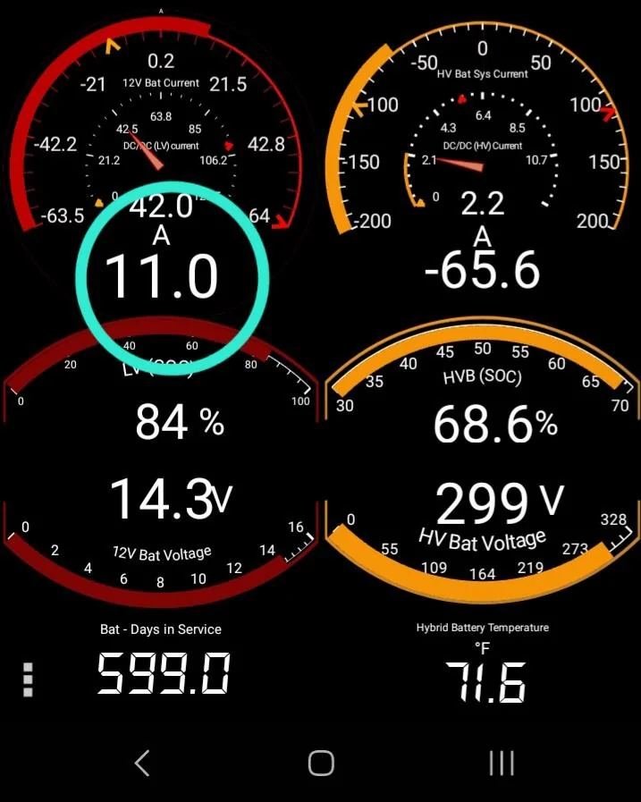

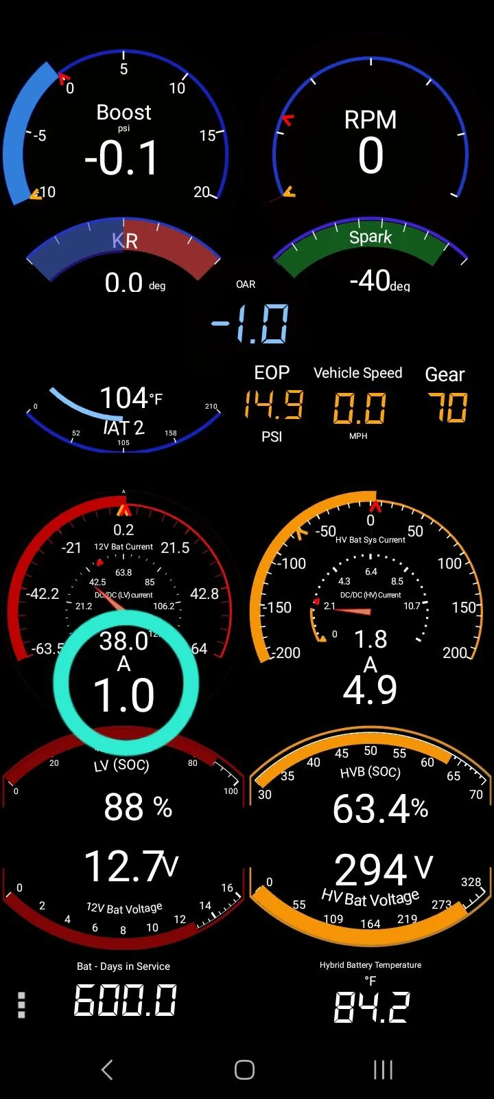

Truck was just outside the RV, instead of the barn. So I checked for AMPs
I've driven the truck a bit lately so my battery is in better health than normal. (600 days old today)
The ICE started immediately since the HV SOC wasn't very high. But the amps available for the AGM were trickle at best.
(you can see the traction motor is in full on charge mode though at 61 AMP @ 300V)
Once the HV battery was full and ICE turned off, I was watching to see if the AGM charging current would increase.
Nope
