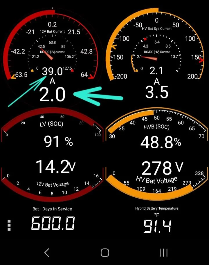

How exactly is the current being limited? Battery positive post measures 12.53V. DC/DC converter output is over 14V. Is there a variable resistor in series?
If the DC-DC is 14V, so will the voltmeter at the battery post.
I look at it like this:
There are 2 PIDs for Low Voltage Current.
(1) is described as "LV DC/DC converter current. It is shown below as 39 amps. It is the "output" of the Powerboost Alternator and is supplied to the 12V side of the truck. This current is being consumed by everything the truck is running on the 12V buss.
(2) is described as "12V battery current". This integer can be positive or negative. So it can be amps being drawn from (discharging?) the 12V battery, or current going into the 12V battery. (charging?)
I personally am convinced that the LV PID for DC/DC current does NOT include the additional amps that include the battery charging amps of the second PID. I explain why with the math below the screenshot.
Note that the INPUT to the DC/DC converter is 2.1 amps @ 278V
So V*A=Watts
2.1 A * 278 V = 583.8 watts (HV side)
583.8/14.2 = 41.11 amps (LV side)
39 + 2 = 41 ?
PID 1 + PID 2 = 41
Pretty cool stuff!
