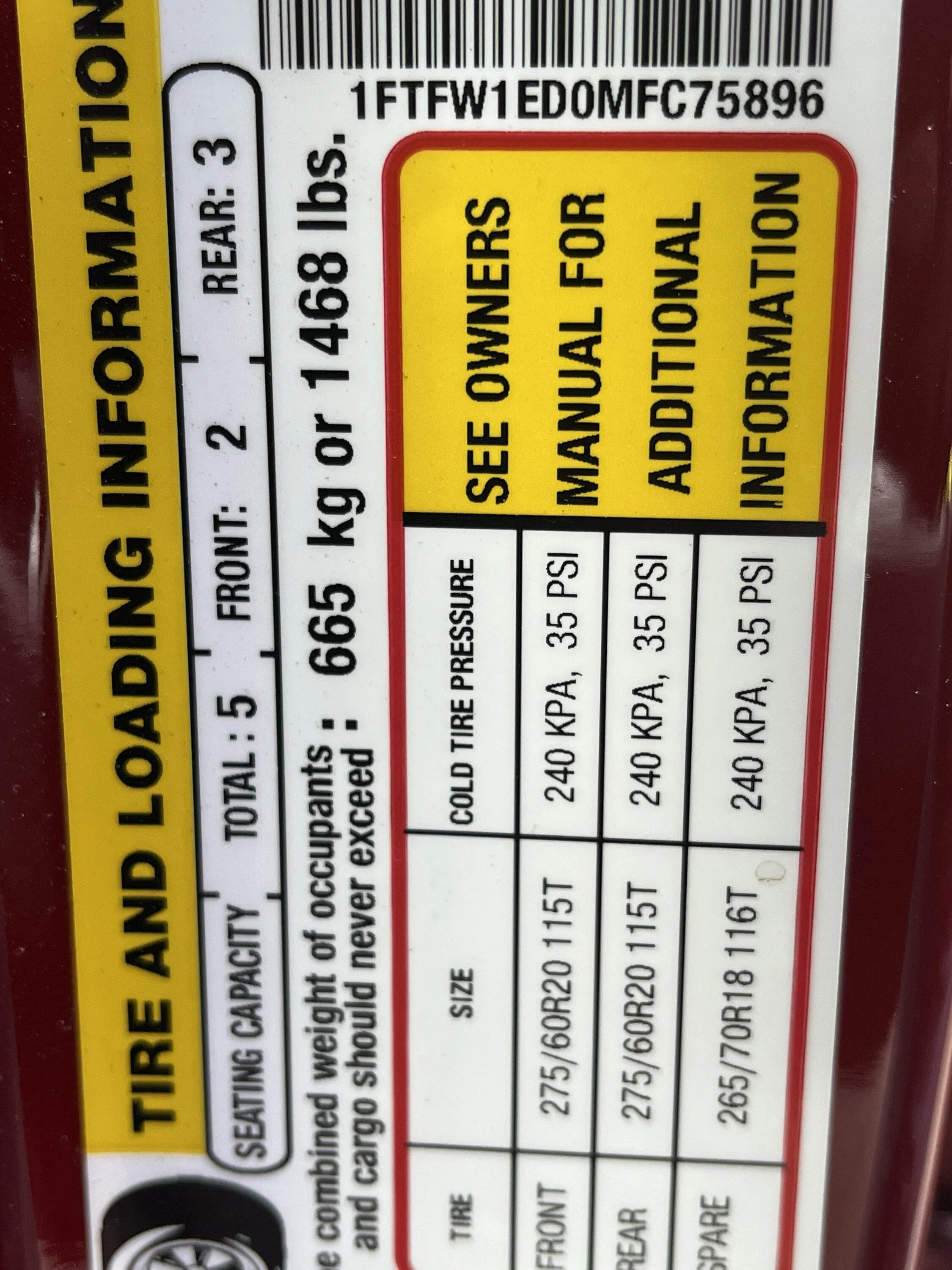

Well, I thought I was gonna get a prize or something until I saw Mtnman1's sticker. I'm in high cotton and didn't know it!

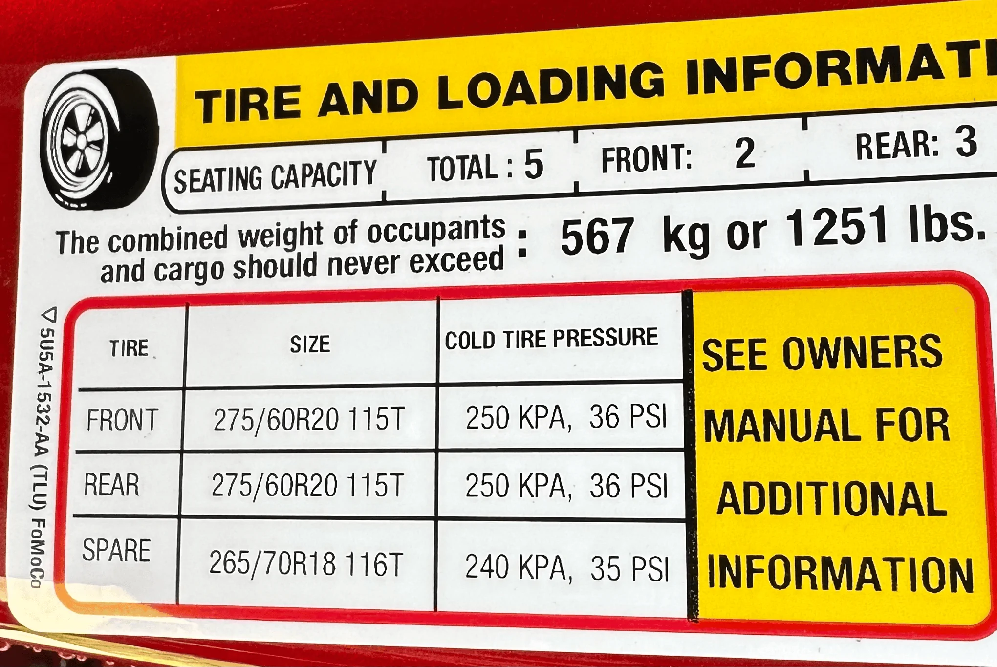

Most everyone on here has a high payload. My payload from the factory was 1251. I added a tonneau cover, bed liner, sway bar and Blue Ox baseplates. From weighing the parts and from the CAT scale my payload now is 1050.

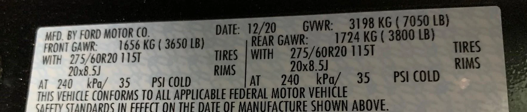

One ting I had never noticed is the numbers don't exactly add up on the other label.
Front GAWR 3650
Rear GAWR 3800
Adds up to 7450
GVWR 7050
Where did the other 400 lb go?

GAWRs almost never add up to GVWR.
Since static loading is really all that’s been practical; they provide all those different numbers to make it easier to stay safely within the dynamic loads that the vehicle actually experiences.
Going up or down a hill, taking a turn; accelerating and braking are all going to make those loads completely different in motion.
It’s why many people can get away with overloading their half ton trucks for a couple miles with a ton of topsoil or gravel as long as they creep over speed bumps and generally drive like they’re hauling old dynamite.
Unless you are preposterously overloaded, the truck can carry a lot more than the rated payload as long as it’s standing still. It’s when you get out into the real world and start driving around where it will be a problem.
Fun fact: even if you are within the GVWR, but you bust one of the GAWRs; the vehicle is still considered overweight. Though; it rarely happens with consumer and light commercial trucks. However, there are some anecdotal accounts of overlanders in midsize trucks/SUVs with ladders, rooftop tents and winch bumpers getting pulled over by bored state DOT officers; weighed on mobile scales and getting violated. Otherwise, it is usually only a problem if there’s an accident with injuries and even if it’s the other driver’s fault, there’s a good chance that an astute officer or injury lawyer would make it your problem.
