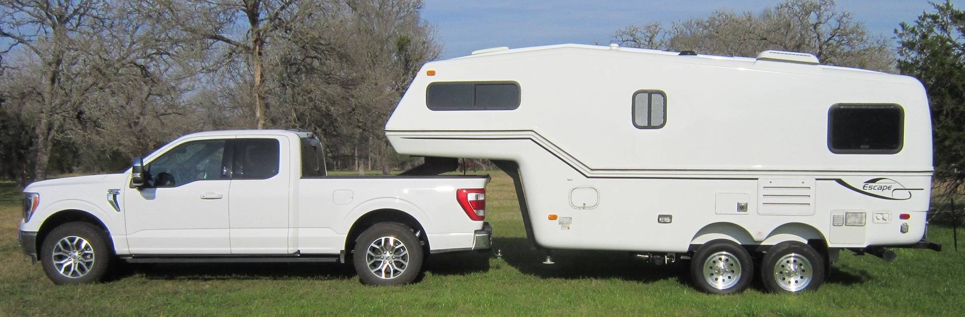

I plan on towing a 5000lb fiberglass fifth wheel (escape trailer 5.0)
Congrats, It's a great trailer behind an F150! ( :D see my signature block)
Just curious .... ordering the Escape 5.0 new or buying used?
BTW, I've not suffered a bolt-break yet on my 2022 3.5EB with Max Tow. ?

Hi Buyer 2021 - YES!! That's the exact RV we will be purchasing as soon as we get our truck and then get a (I think) turnover ball and an Anderson Ultimate hitch in it!! I'm 6'6" tall so I don't fit in many fiberglass rv's. We currently have an "EggCamper brand, and LOVE it. But being one year from retirement, we need more room in our camper setup for longer trips. The EggCamper is good for about two weeks.
As for buying the Escape 5.0 new or used. We are open to either, as long as a few of the options are as we like (manual awning, 2-way water heater, 12v compressor fridge, NON-U shaped dinette, etc). But gently used would be OK with us as we are aware Escape has been having quality issues since being bought out by the big guys, unfortunately. We also looked at the '23 but again, being 6'6 my head barely can touch the headliner, and with the A/C sticking down, I'm ducking under it. So the ONLY FGRV's for us are the EggCamper or the Escape 5.0.!! We love em!
I hope you are enjoying yours - it looks like a beautiful rig in your signature!! I see you went with the Supercab 6.5 bed vs a SuperCrew 5.5. Very nice!! We considered that same truck due to the 5er, but have been assured it will turn 90 degrees with a 5.5 bed. I sure hope so!!!
I'm very satisfied with the B&W Turnoverball / Andersen Ultimate hitch combination. Many 5.0 owners happily use that setup in 5.5ft bed F150s.
I, too, am a huge fan of molded fiberglass trailers - I bought my Escape after 20 happy years with a 17ft Casita, would never consider any other RV construction. (y)
My Escape was ordered after Reace and Tammy sold the company back in 2018. IMO Escape, like most RV manufacturers, has suffered some "quality issues" both before and after the transition, but in Escape's case those are infrequent and usually addressed under warranty or easy to DIY remedy. Personally, I think any year Escape 5.0 offers overall great quality; I'd shop based on features / options / price rather than corporate ownership.
You do follow / participate on the Escape Forum, correct? I'm "Centex" there.
As to the F150, even though the 5.0 pin-weight is relatively modest I still recommend you be attentive to the truck's payload rating. I'm happy to have a generous 1848# payload sticker rating but if not careful with trim / option choices it's easy to find oneself with a very much lower payload rating.
As to Max Tow, I ordered mine before the issue was well known. I honestly don't think it's necessary for comfortably towing the 5.0. I've not suffered a bolt-break, and though it's still pending I'm reasonably confident Ford will eventually deliver a final remedy. I have no regrets whatsoever, I love my can't-be-built-today Lariat SuperCab which, like my trailer, was built to my spec.
I won't speculate about what, if anything, changed after 2023 in regard to the Max Tow axle and associated component differences it includes because Ford has not been forthcoming about that and they're demonstrably capable of changing anything / everything along such lines in these days of penny-pinching. :facepalm:
Good Luck, Happy Shopping! :)
