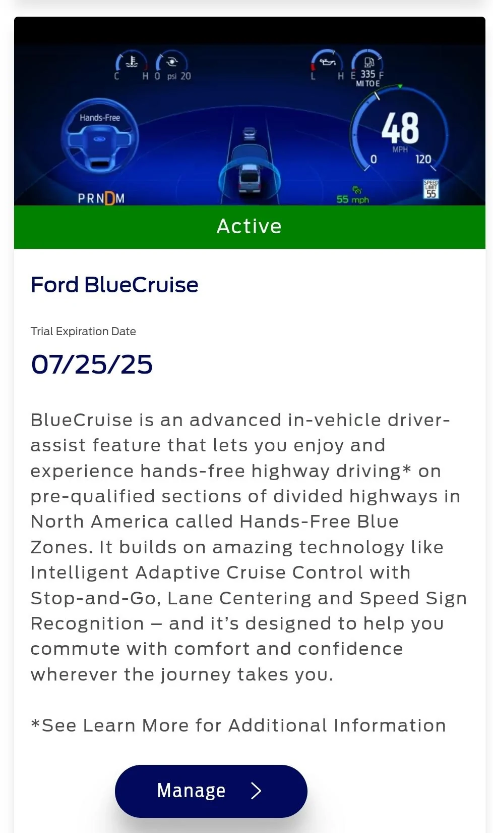

My 3 year complimentary BlueCruise subscription ends in 2027.

I think most trucks get a 3 year subscription to BC..
