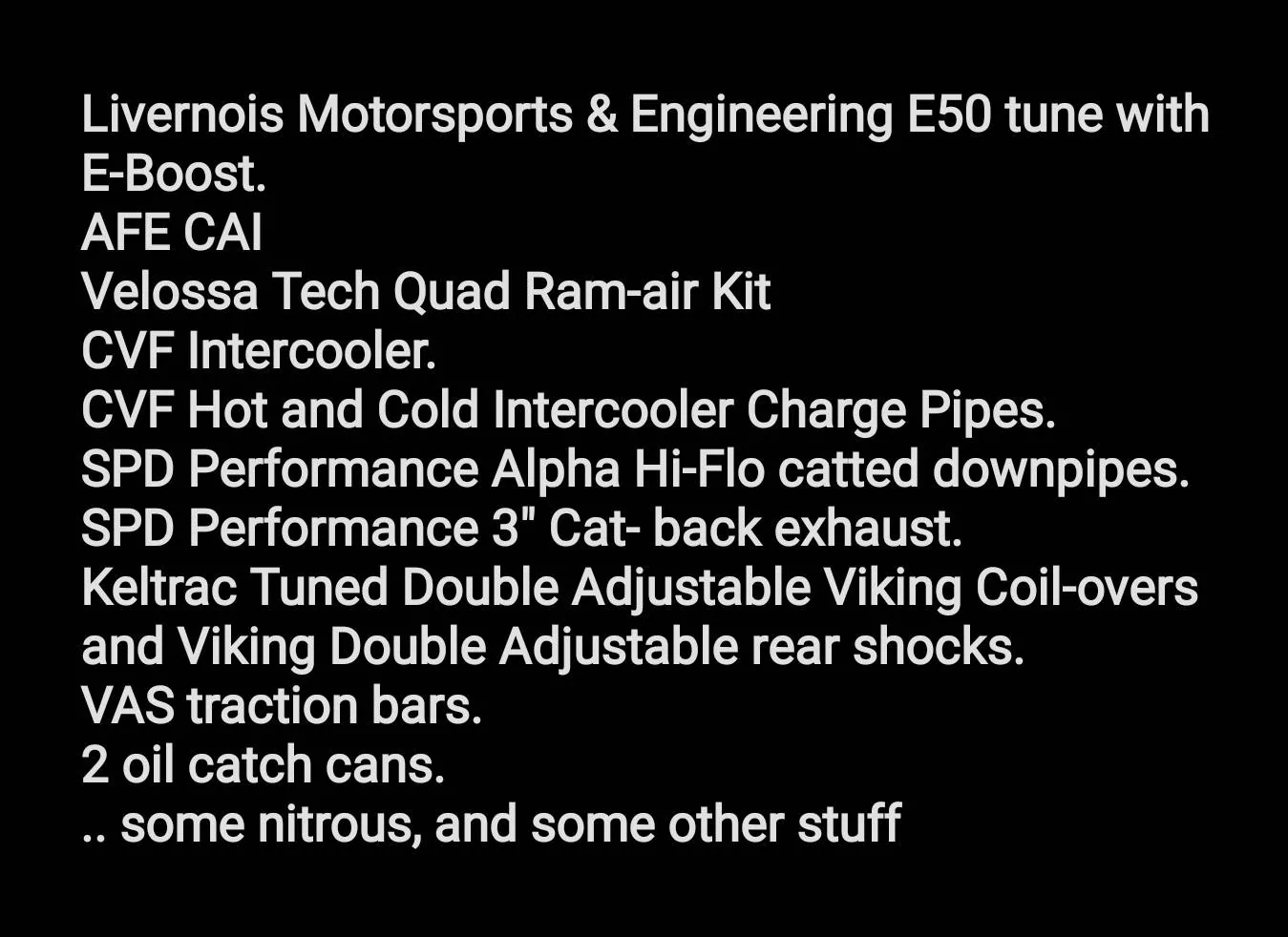

Between all the damn Holidays, Birthdays, Anniversaries, and unexpected personal issues that have popped up...I packed up my truck for a little road trip.
Left Louisiana on Saturday for a 20+ hour drive to Livernois Motorsports & Engineering in Michigan.
Livernois is installing CRP Stage 5 turbos, FIC Injectors, and a fuel pump on my 2021 F150 Powerboost.
Then some tuning adjustments and a few dyno pulls.
https://www.facebook.com/share/p/18MeFucokA/
Last year I set the record for Fastest and Highest Horsepower F150 Powerboost, I honestly didn't think I would hold the record this long, I thought for sure someone would have taken the crown by now, but to my surprise, no one has...
Currenty I'm at 647whp and 715wtq, with an 11.6sec 1/4 mile...
...it's time to pump those numbers up....?
