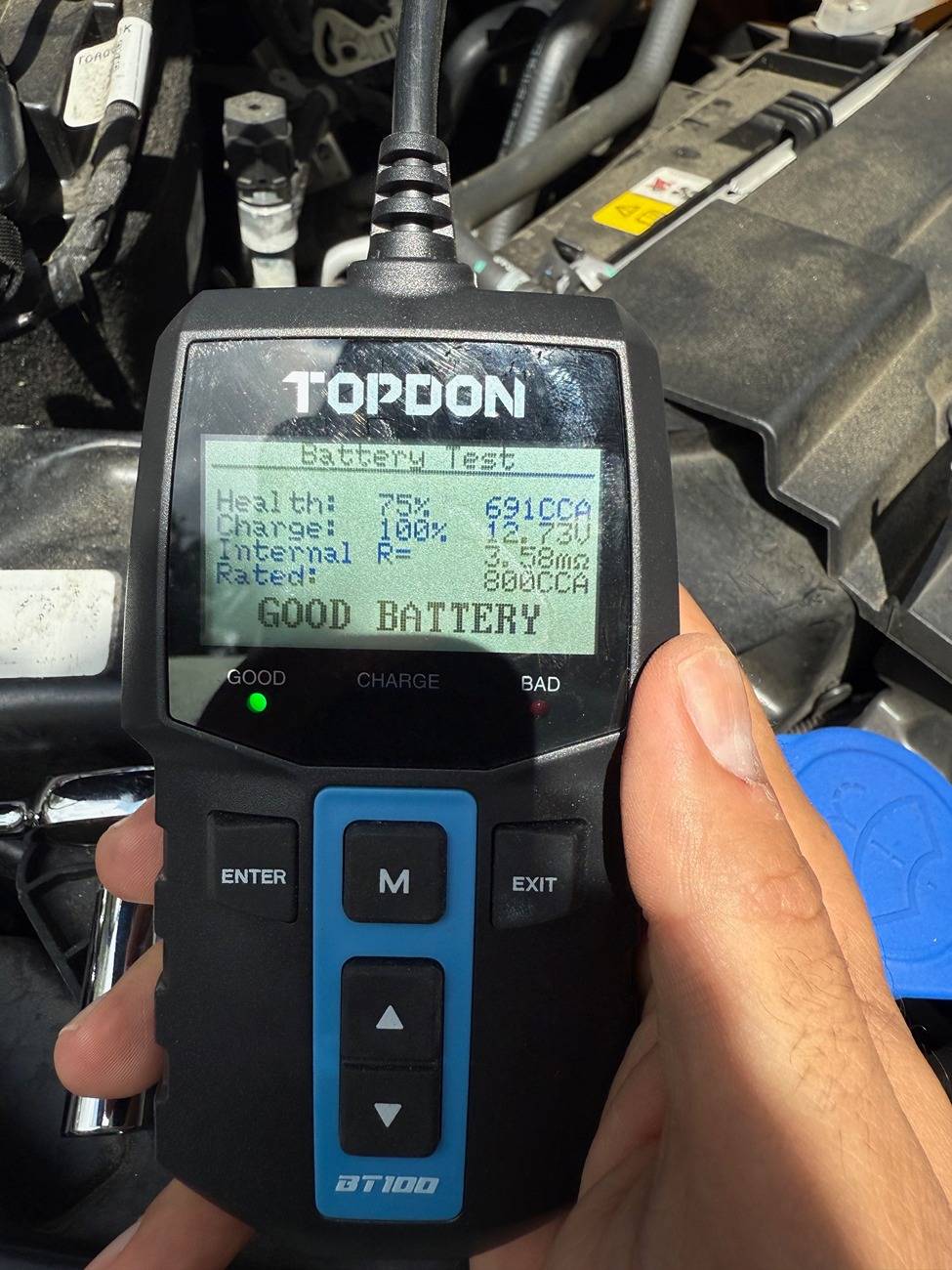

I tested both the battery under the hood and the aux battery (I disconnected them before testing) and they both tested good. Is my tester giving fake news? I forgot to mention, that for parking mode on the dashcam I have the low voltage cut out set to 12.2 V.

JohnTrigger
Oct 14, 2024
467
381
MD
‘24 F-150 STX 2.7L SCREW
The 18.07 milliohms on the one test output you show is not good. Should be generally less than 10.
even for a battery that small? It’s fixed at 125 A, so assuming 125 A current * 0.018 ohms = 2.25 V drop at max current, which doesn’t seem totally unreasonable.

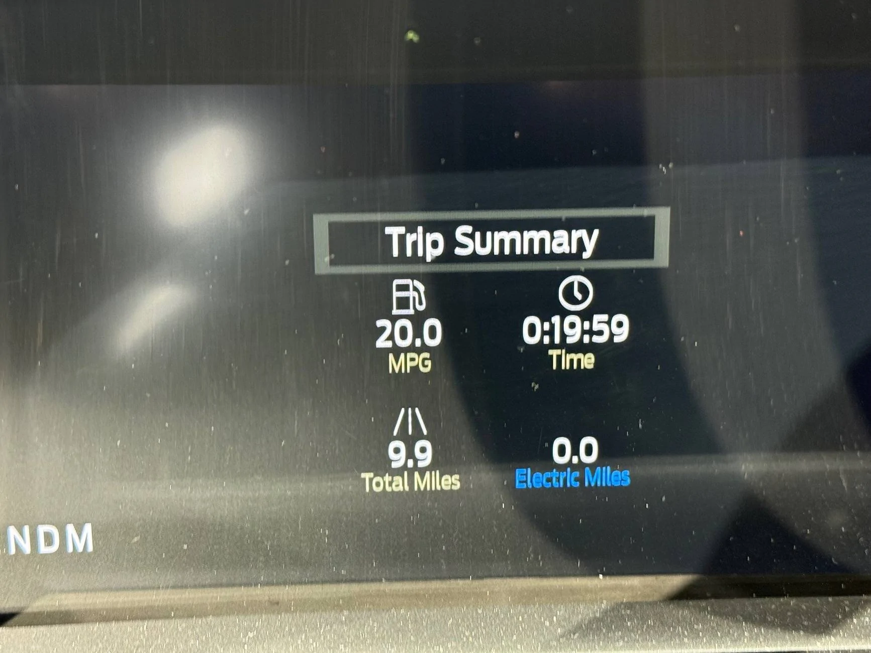

I went on a 9.9 mile drive, which had a good bit of highway driving so I didn’t expect much electric miles. But it didn’t enter electric a single time, not even slowing down to stops. I made an appointment at the dealership and we will see what they say
Ford F-150 Truck won't go in electric mode IMG_6765
