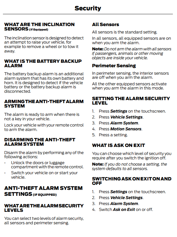

You would think glass breaking and someone inside the truck the alarm would go off. Here is the Manual about the two levels "All Sensors" & "Perimeter".

When you locked the truck, did it “double honk”?
Its an indicator that the system can not arm the full security system or a door is not locked for some reason.
I have done extensive research into this after having my locked 502a smashed and grabbed last year. No alarm. Dealer can’t explain it and I can’t recreate it. I’ve been told there is a way to broadcast interference so the locking doesn’t work, but I have no clue how that would be a thing.

I tossed a shirt into my mach e w/ sensors on and the alarm went off, yet doesn't detect impacts. It does know if it's being jacked up. Haven't checked to see if it's using they gyro or the suspension sensors. I suspect it's suspension.
The shirt triggering sounds like an ultrasonic sensor.
Movement of the vehicle is likely an accelerometer, both use very little power.

this thread had me curious. I checked all settings and i do not have this either. :( I have a 2023 platinum. I remember my 2018 raptor always popped up asking something about sensors. Am i just missing something? I went and tested on my truck yesterday. I opened driver window, closed door. Locked with the button on door handle. Waited several seconds, started waving my hands on driver side. Nothing. did this for about 1-2 mins. Then opened the door on the inside. An alarm sound inside the truck started going off and a message on instrument cluster said something like vehicle alarm going off. This continued for about 30 seconds and then the truck horn started going off.
edit - also went into owners manual and found there where it says to find the setting, under vehicle, but i dont have that setting.

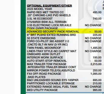

You might want to double check your window sticker. There were several months Ford removed Advanced Security Pack and gave you a small credit. Many have added it back fairly easily.

Ask On Exit is what you need to prompt you to enable (default)/disable the motion sensors. Yours is off so it doesn't prompt. Mine is on since I have my dog with me a lot. I disable them when she's in the truck and I leave her for a few.
As far as opening the window, setting the alarm (locking it) and trying to get it go off, that is weird. I have forgotten to disable my sensors and after a minute, the alarm is going off and the dog is freaking out.(she moved and set off the alarm).

Do you really have the alarm? It states in the brochure that the perimeter is standard equipment on the Lariat and up, but due to chip shortages it was deleted in production of my 2023 Lariat in Nov 2022. Operation of the alarm is in the manual but I got $50 credit for the removal. Like $50 would give me enough money to reinstall it!
