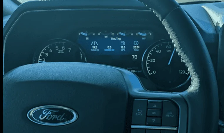

When people say "This Trip", it is on the Powerboost when you cycle up from Trip 2 to Trip 1 to This Trip.
Got it. I have a 5.0 but, I swear somewhere on my display I seen "This Trip". Just don't remember when or where. It's not there when I cycle through the screens. Thanks for every one's help...still learning the new whip. :D
