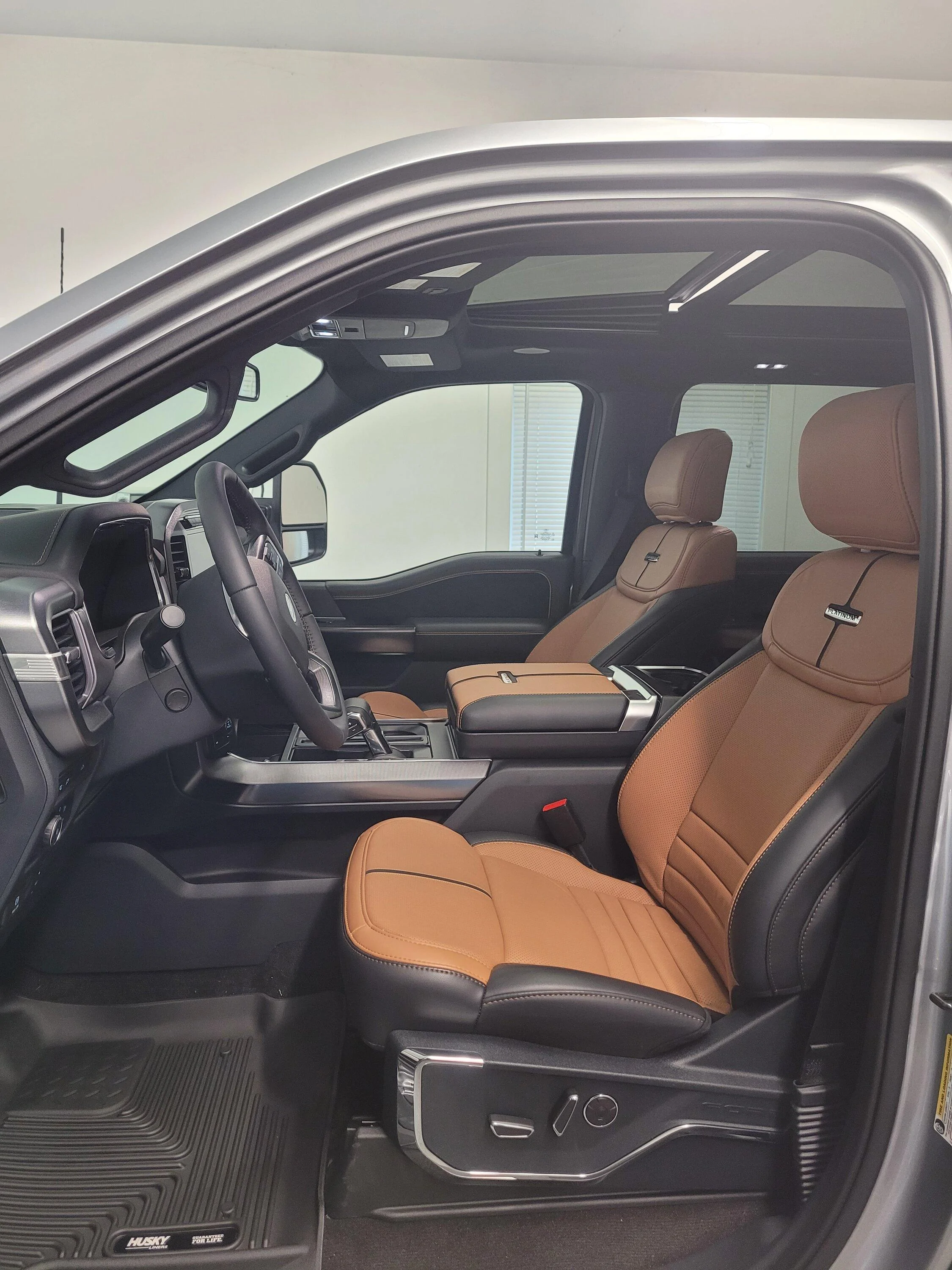

The wings are just part of the "multi-contour" design of the seats. The wings are wide at the shoulders and can be positioned similar to the adjustable headrest. I think 3 clicks protruding forward, then the 4th click they return flush. (zoom in on the passenger wing and you get a better idea of how those wings are independent of the lumbar portion of the seat)
But these same multicontour shaped seats also include the massage option and the max recline.
The max recline I could live without, but the functions of the multicontour wings, headrest, and massage is a big loss for a KingRanch, Platinum, Limited in my opinion. And they really dress the truck interior up.
The wings are part of the max recline. I have massage, but not max recline. I wish I would have checked that box after seeing them.
Ford F-150 Tremor suspension on Powerboost 20210728_202008
So those seats aren't the multicontour delete seats?
Thanks for the clarification.
I had always assumed the wings were an aspect of "multi-contour" since they provide yet another contour, literally.
Bitten by logic and assumption again. Naming nomenclature in the automotive industry is so confusing at times.

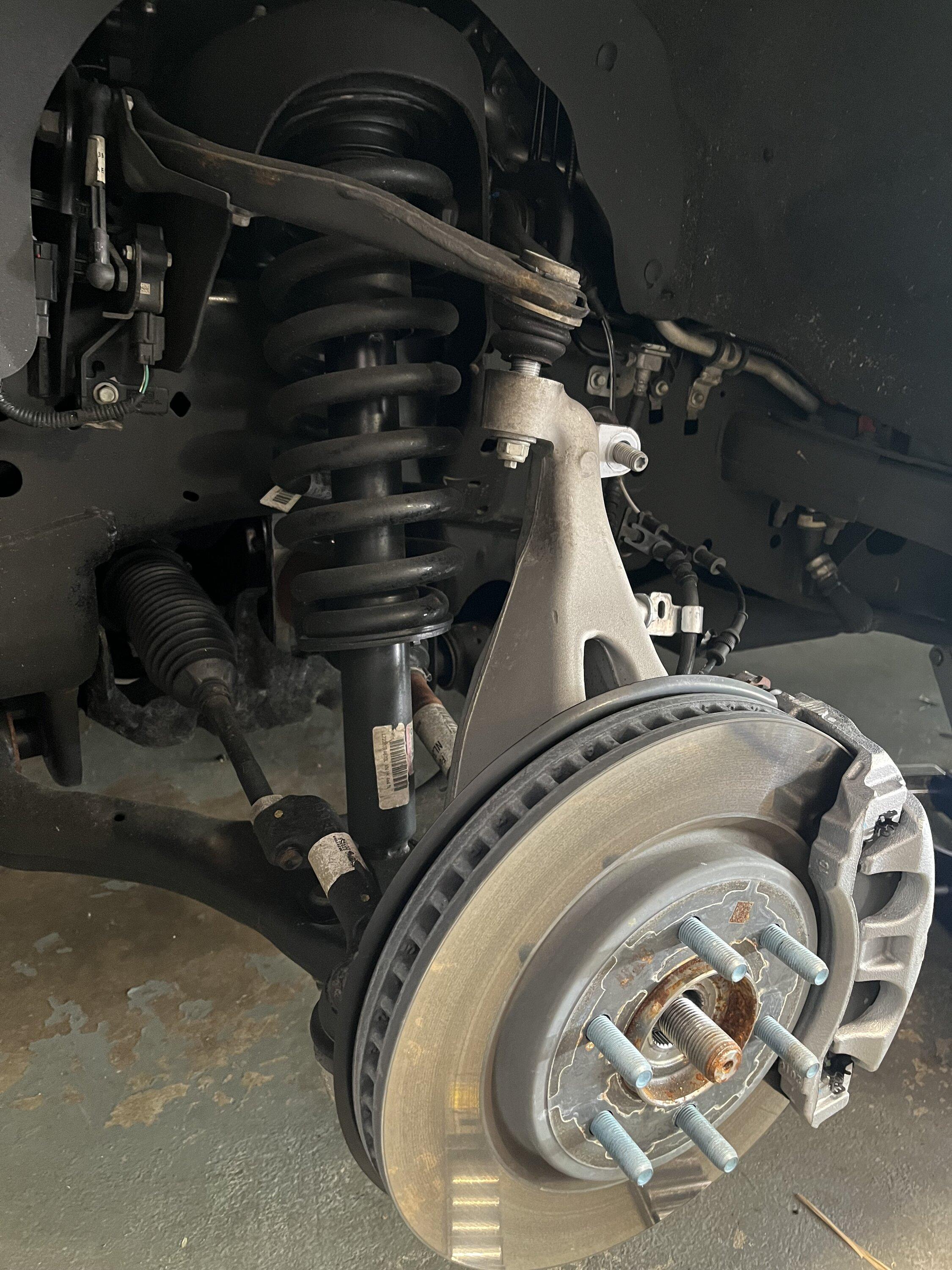

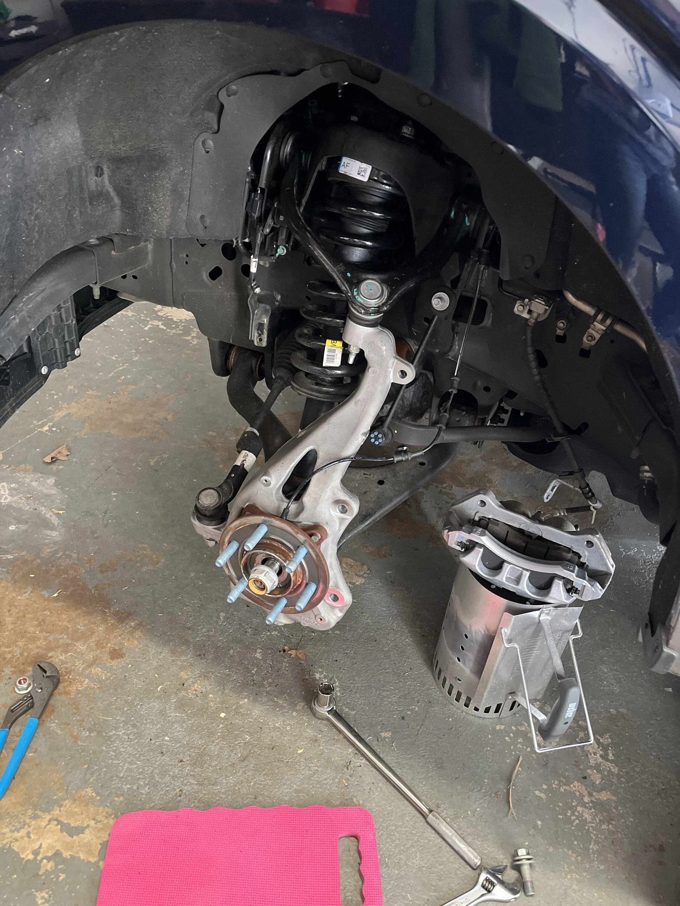

Here are the additional pictures. It’s been a busy weekend. I am still getting tires and alignment worked out so it’s taking a while for me to collect my thoughts on the swap.
I’ll get more pics later today.

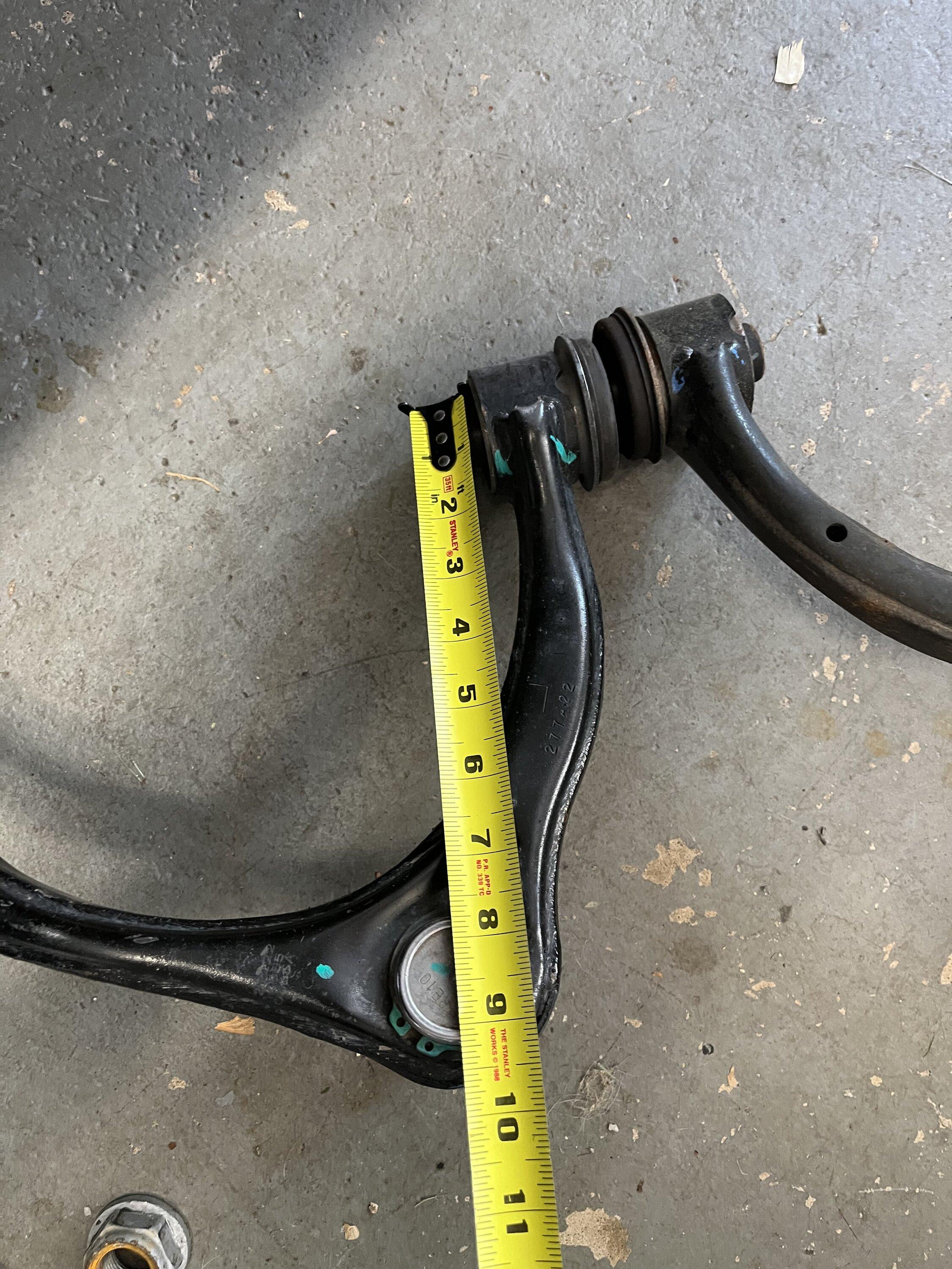

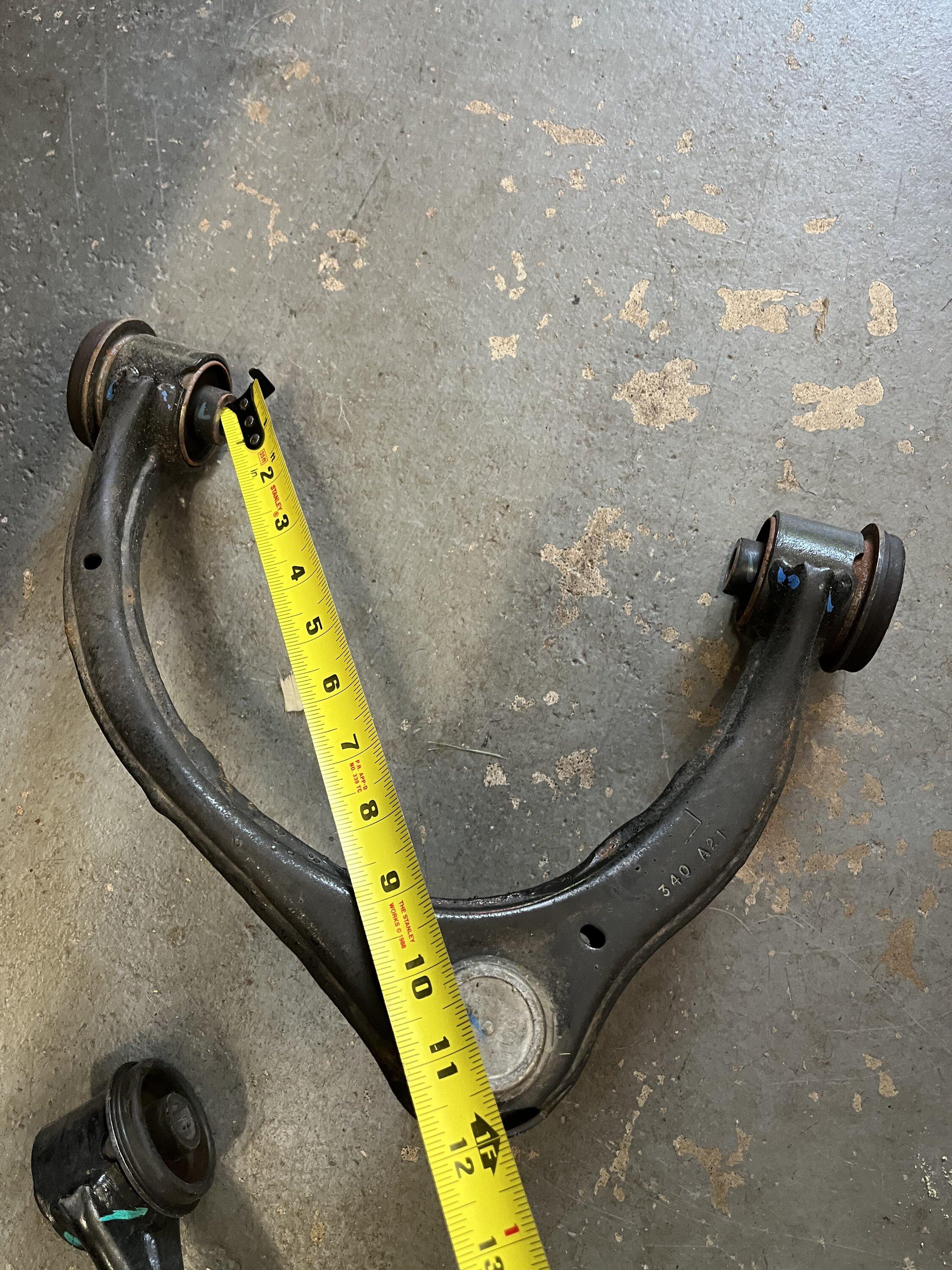

The uca is definitely shaped differently. It’s hard to get a grasp on it. I really wanted to measure the ball joint range but I forgot to do that but did get a tape measure on them.
All said, I think the knuckle is the real difference maker.
Ford F-150 Tremor suspension on Powerboost IMG_0669
Teal marker is tremor uca
