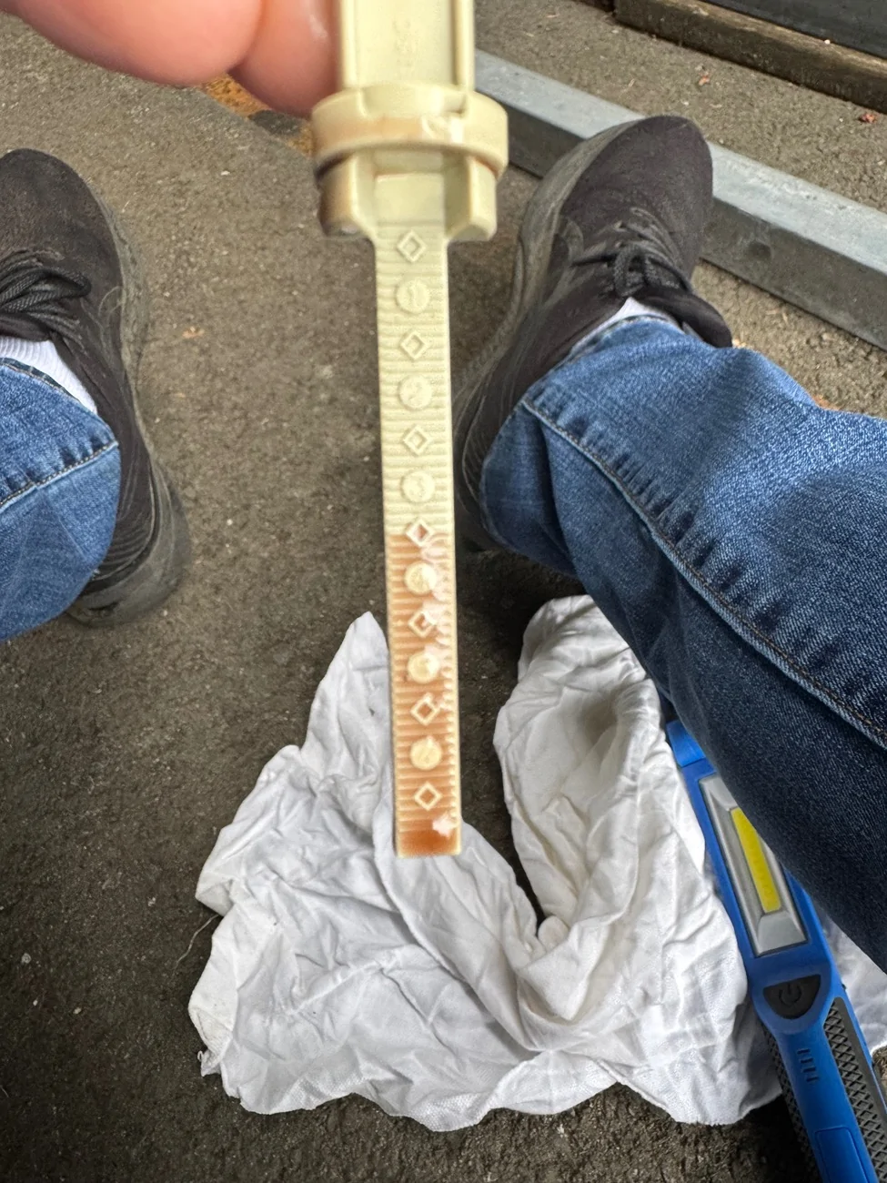

I know that the proper way to check these transmissions is to have it level and at 205 degrees.
But I let it sit over night so it was cold. Check the fluid just to see where it would fall on the stick.
If I understand the correct level is between 5-6 on the numbered sticks. And the fluid will expand as it gets hot so mines seems to be way over full even at cold.
I have about 5 and a half quarts in already and it is at the bottom of the stick. Still have a few more quarts to go if I am going of what’s was taken out.
I did drop the pan and filter.
What do you all think 🤔
Maybe because I didn’t have it running

Yeah, it needs to be hot and running.
Fluid drains out of the transmission components and into the pan when the engine is not running.
If I remember correctly when I helped the son-in-law do his truck it took right at about 7 1/2 quarts after a pan drop and filter change

I did put what I pulled out back in and checked it while running and at 205.
It was over full but I have a drain plug on the new pan so I just drained and checked until it was within range.

Does each graduation mean a quart? Like from 5 to 6?
Not sure but maybe
If we are going off of that measurement. I drained about half a quart to get it within range.

Just to be sure…between 5-6 hot is correct, unless powerboost then it’s between 3-4. What engine do you have obert?

5-6 is correct from what I have read.
I have the 2.7L
