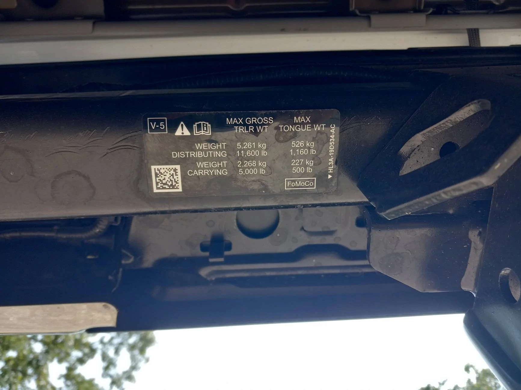

Hey guys, so I just bought this truck, and even though it doesn’t have the trailer tow package, or the max trailer tow package, it seems to have a couple trailer features such as hitch assist and whatnot. I need to tow my RV with this, and noticed before delivery that it didn’t have a brake controller. So I got the dealer to install one.
Ford F-150 Trailer tow package vs piecing together IMG_0307

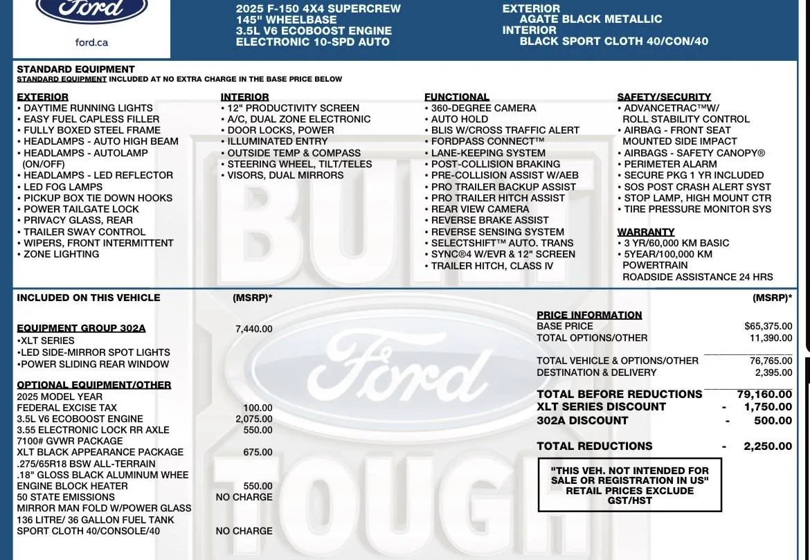

My window sticker essentially shows every tow option other than the tow/haul package, and the TBC
So I’ve got them to install the TBC, before I even pick up the truck.
The door sticker has over 1900 payload, and towing of 10,400.
The only unknown here is what the tow/haul package would add here.. I’m not understanding why your saying the truck can’t tow??

I have found the info in a 2025 sheet from ford.
basically, if you add the tow/haul package, you get the TBC and all that, but what you get above and beyond that is:
A reinforced hitch, capable of towing up to 14,000lbs instead of 11,600.
apparently an option to add a “max tow axle” which I haven’t seen yet. Which would also bring your GVWR up from 16,800 to 19,400, allowing you to tow up to 13,100 instead of 10,400
So long story short, what I’m missing is a reinforced hitch, and a stronger axle. Which would all bring my max towing up 2,700.

As suspected, all of the stuff in those trailer tow packages: Max tow axle, and 53T package while some is useful, it's not necessary for the everyday guy towing an RV. It just pushes the ratings higher over what I think most people would consider safe for a half ton. The most valuable thing I see is the 53T and raptor auto trans oil cooler (listed as standard on f150). Otherwise I'm not actually seeing anything that would make or break it for most people other than the trailer brake controller which can be added.
Ford F-150 Trailer tow package vs piecing together Screenshot_20250710_170225_Chrom
Ford F-150 Trailer tow package vs piecing together Screenshot_20250710_170252_Chrom
