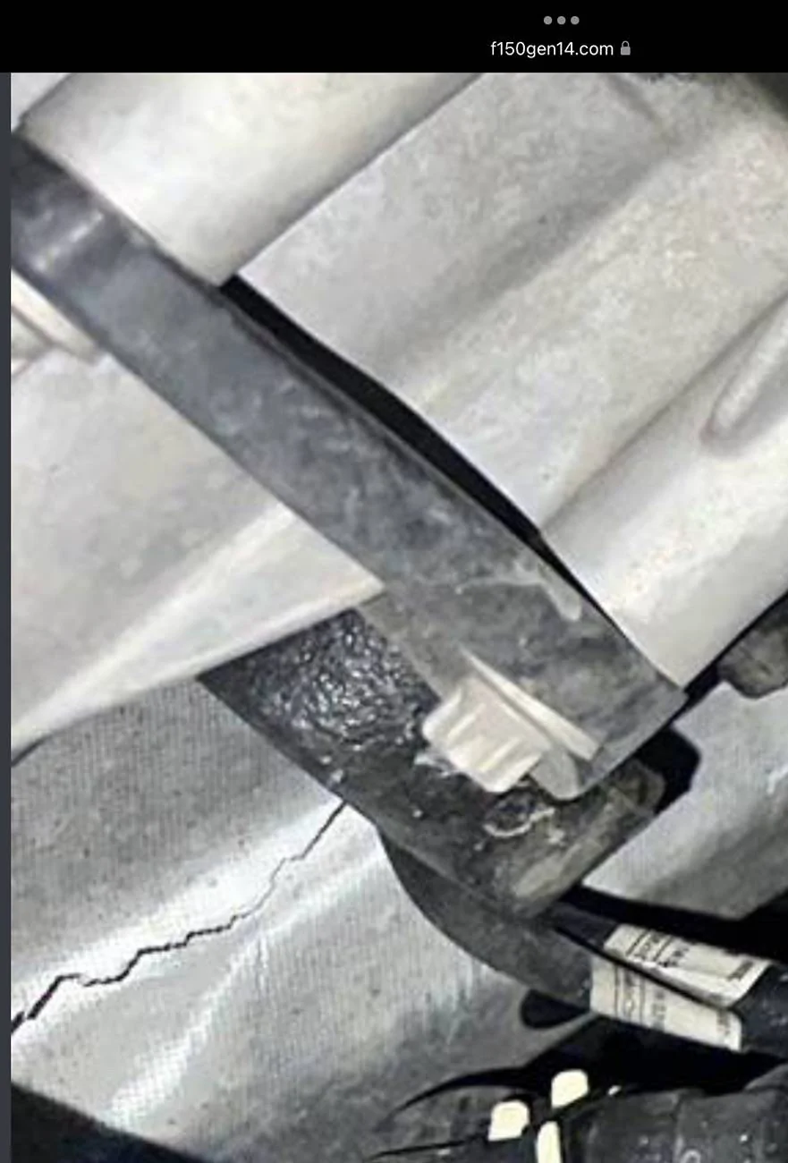

Anyone have an idea on what maybe happening here? It’s a 2021 F-150 with 60k miles.

Yeah, oil level was good. I actually took it to ford quick lane Friday to get an oil change and have them look at it. About an hour later I got a call saying they couldn’t diagnose it and I needed to get in with the service department.

Worst case rear main seal. More than likely a crappy oil change and the residue is blowing back and catching dirt. I’d clean the area with some high pressure water and a degreaser making sure you hit as much area on top of the skid pans. Give it a few drives and see if it comes back.
I am a little concerned with the crack in your photo though?

Transfer case leak. Also is something cracked on the left side of that picture?

That crack looks like a heatshield to me

Good eye! I’ll be sure to point that out as well!
Crack is the stick-on insulation.
Looks like t-case RTV seal is caput. If it were a shaft seal it'd be leaking from the front or back. It's originating from the propellor output shaft area.

Looks too pronounced down the seam of transfer case to be a splatter of oil from an oil change......probably a leak thru the seal
