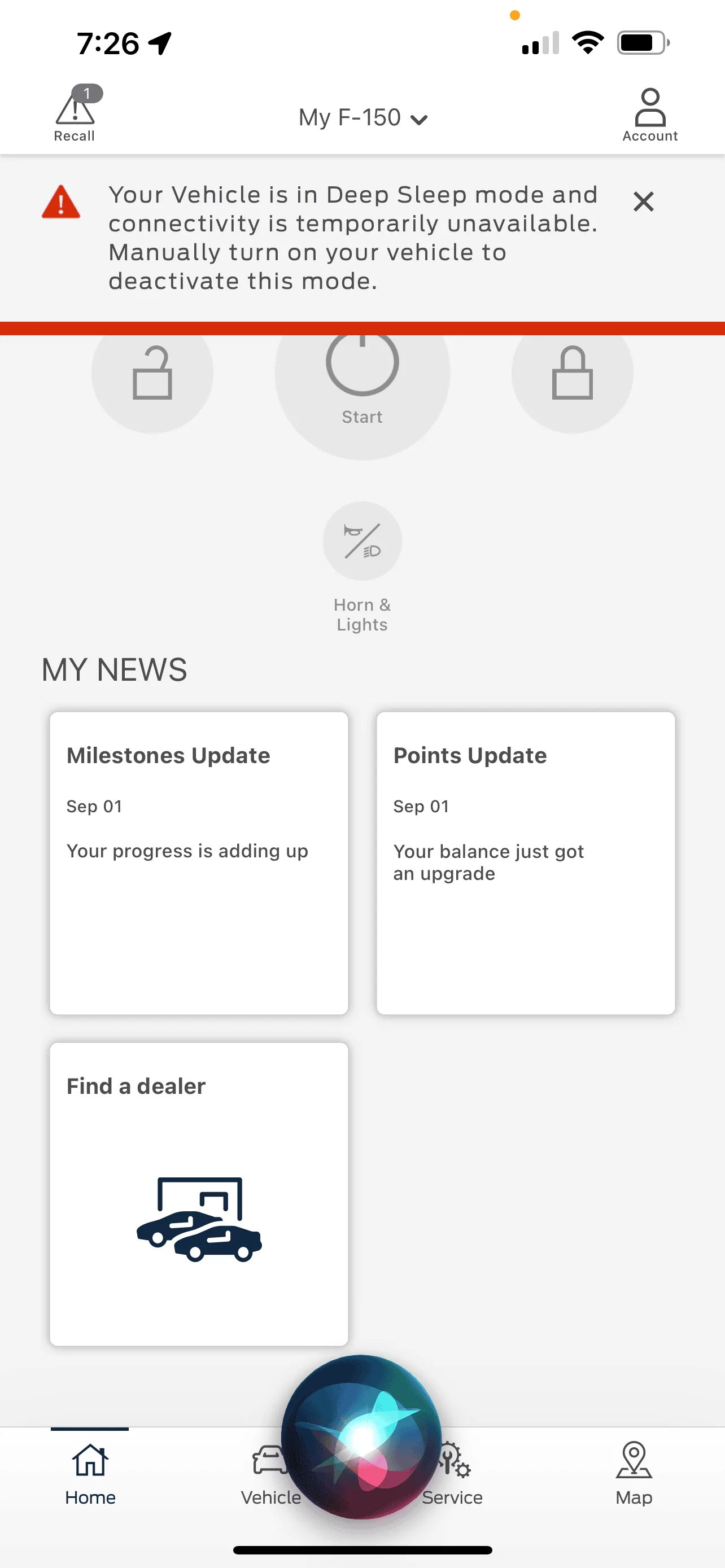

Took the truck to dealer to test battery. They just said it's low, but I can buy a new battery if I wanted. 300 Euro... ended up getting a different battery for 235 Euro (still a bit pricy compared to the states). All the issues are gone, didn't wanna deal with it anymore. Larger heat shield on the way.

i’m at the dealer for unrelated work and they said I need a battery service. The SA said they are charging the OEM battery to bring it up to 12.5 and if I experience another deep sleep warning (which I mentioned to the SA at check-in) to bring the truck back and they will warranty replace it. Two months ago I did a BMS reset because I was regularly getting Deep Sleep warnings on the FordPass app. Not sure how long it will be before the message reappears.
2Lazy2P
Apr 24, 2022
394
247
PNW
Il Dolce Far Niente
Update. The battery was tested and showed 45% so they brought it up to 80%. Then, irony of ironies, while the SA was walking me through their work order for sign off, I got a message from FordPass that the truck went into Deep Sleep owing to SOC. The SA then did a step-back dance and agreed to replace the battery next week.
