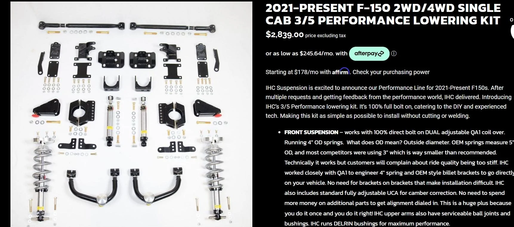

What version of IHC suspension kit where you running? Was it an earlier version that reused the stock front struts? Currently, their website shows a complete kit with QA1 double adjustable 4" coilovers for the front, as well as double adjustable rear shocks. I bought this kit 3 months ago, and yet to install it due to my '24 not arriving yet. I wonder if you would have raised your previous kit to a 3/5 drop, would it have handled better and avoid the axle from hitting the frame. I plan on lowering 3/5 to avoid alignment issues and harsh handling. I'll see if I need the helper bags after some driving.
I was running their 4/6 kit, which isn't adjustable, and is still available. The kit you purchased is their 3/5 performance kit, but I didn't want to run that kit as it uses the shock relocation and you have to remove the spare tire, and it's also not adjustable height in the back, just the front. I didn't feel the IHC kit was worth almost 3000 dollars for what it was.
Also, I didn't like that the traction bars hang under the leaf springs and I've been hearing about quality control issues with the QA1 shocks, and went Ridetech because they use Fox. There's also quite a few complaints about the IHC spring plates bending and breaking as well. Can't say I trust that at all.

I figured the IHC kit would be best for my needs since it its aimed towards drag racing and the adjustability for when not running the truck hard. Not a fan of removing the spare tire, but a small sacrifice. I plan on running a tire plug kit with compressor similar to what I run in my other F150 4x4. AAA membership also helps in case of a blowout.
In your opinion, what was worse on the IHC. Was the compression too stiff or rebound too soft, or vise versa?

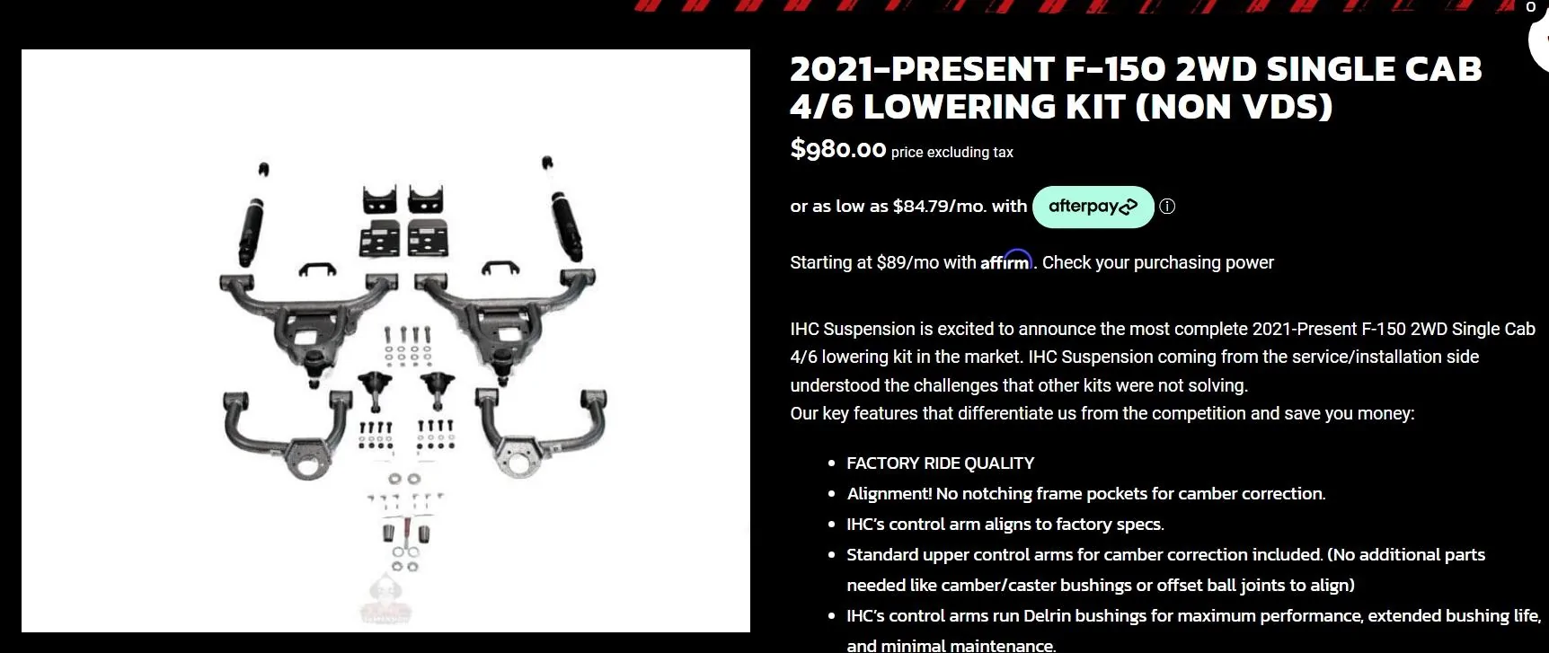

I'm starting to second guess my purchase :facepalm:
Were you guys running this kit? I can see how this kit would ride horrible.
Ford F-150 Suspension mods for 2WD Screenshot_28-5-2024_85630_ihcsuspension.com
I purchased this kit from Steeda website for 2600 shipped to my house. Price has now increased to the price shown on IHC website.
Yes, I had the 4/6 kit. In theory it should ride as good as stock, but definitely not the case. It rode like crap. lol
