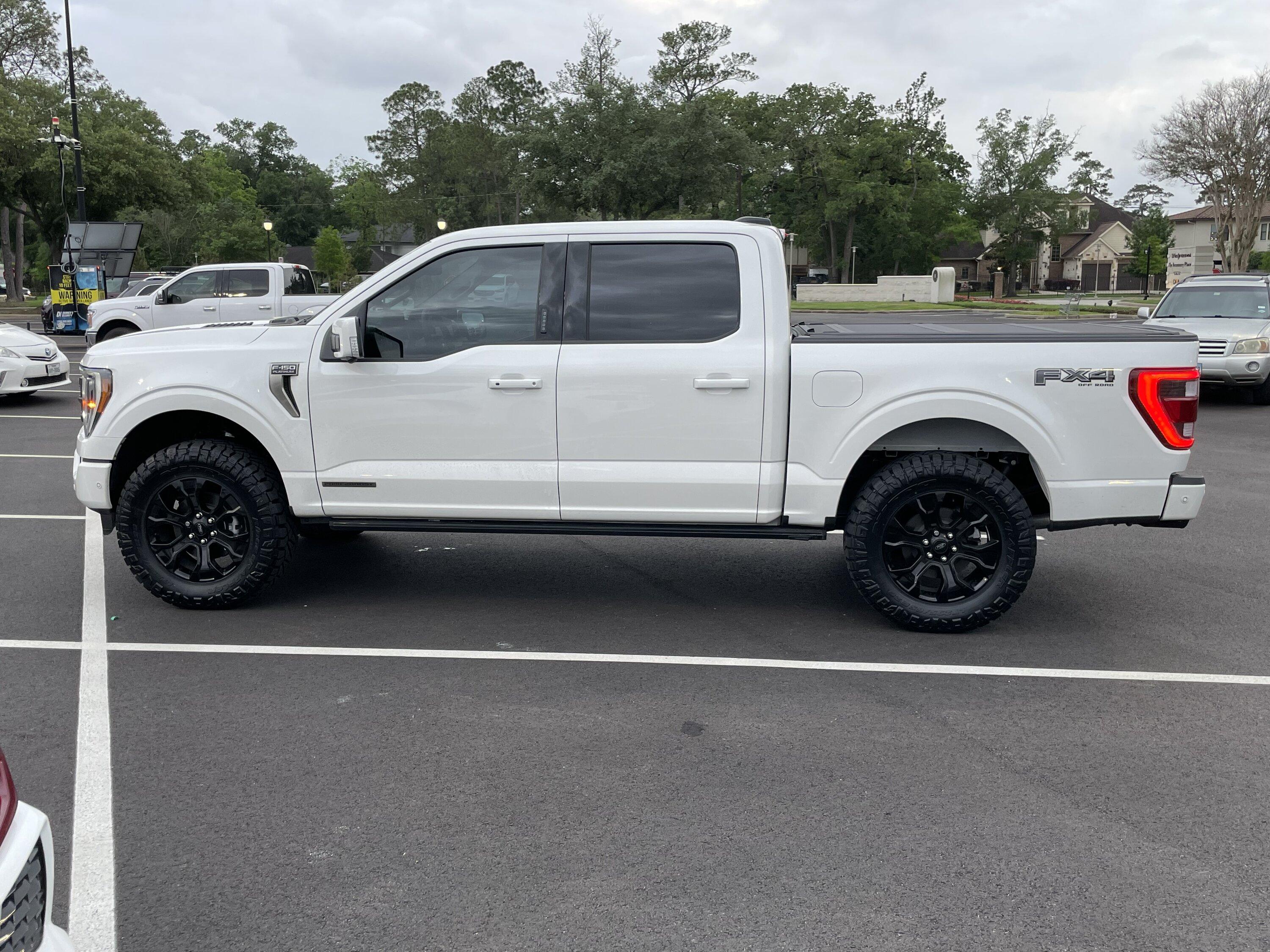

The FRPP Bilstein Kit is awesome. I put it on the 2.5" Groove and got 1.75" of lift. Truck rides absolutely amazing on 10 ply 35's. Check Lethal Performance for pricing as well. I paid about $1350 shipped IIRC.

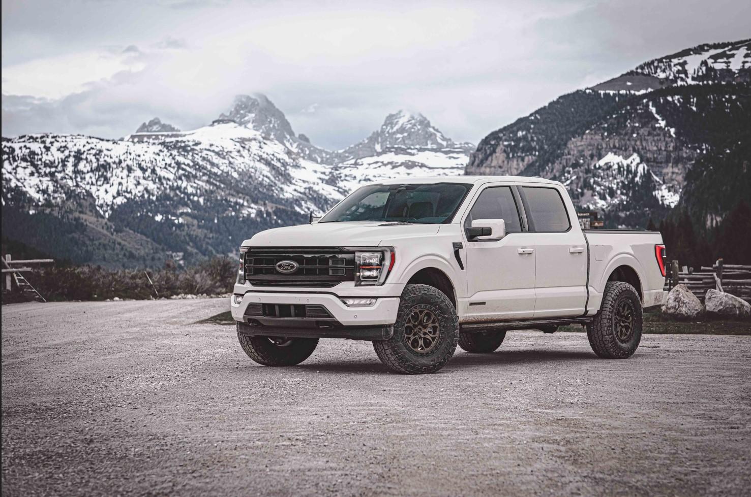

Looks great. Here’s mine. Level and 35s
Ford F-150 suspension mod for 2023 Powerboost IMG_7759

Looks great. Do you have any additional lift in the rear axle? What's your wheel offset? And did you have to remove the crash bars?
I'm curious because I'm interested in 275/65/20 LRE tires which are 34" in diameter.
I like the Venomrex 20" wheels but I believe they are a +18 offset and I don't know if I'll have rubbing issues
