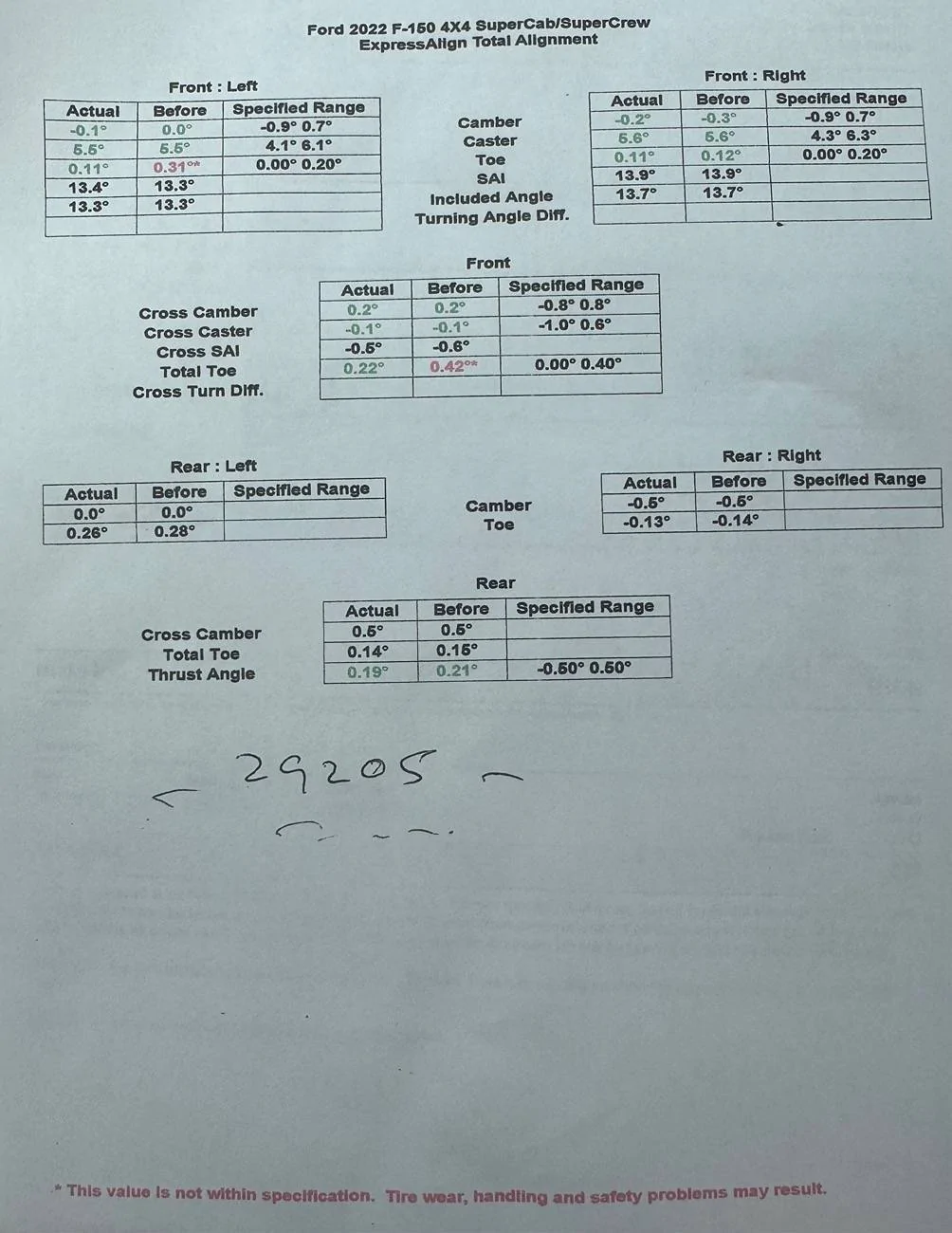

Just installed Eibach Stage 2 Pro Truck coilover kit on my 2022 Platinum FX4 PB. Max setting get me exactly 2” of lift. Only 15mi on them but ride quality is terrific. Very happy with result.
Ford F-150 Strut and shock upgrade help IMG_4643
Ford F-150 Strut and shock upgrade help IMG_4630
