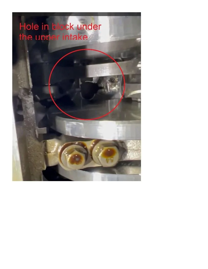

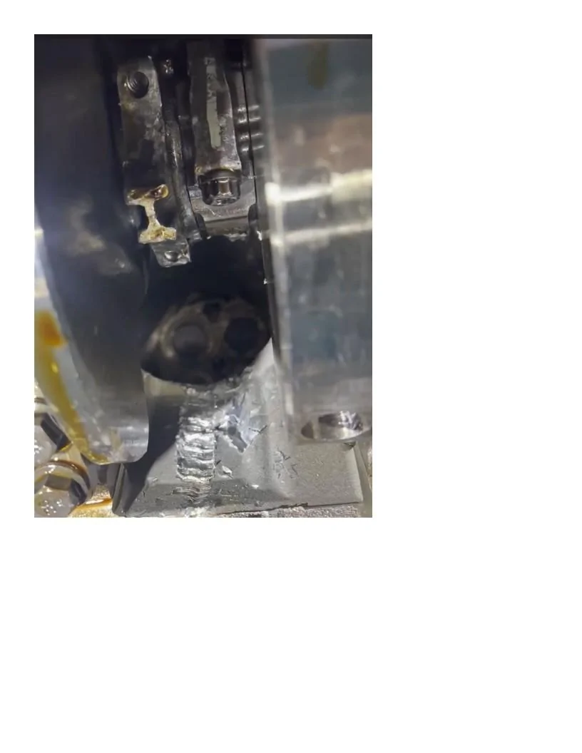

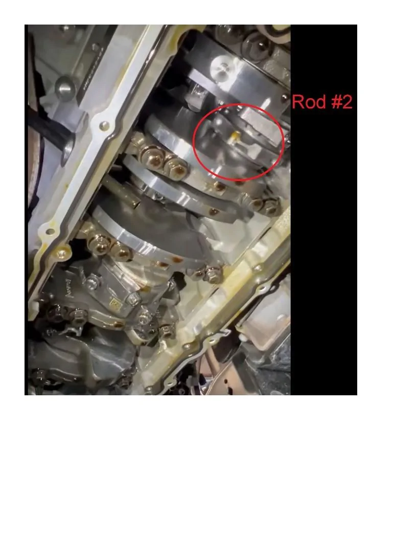

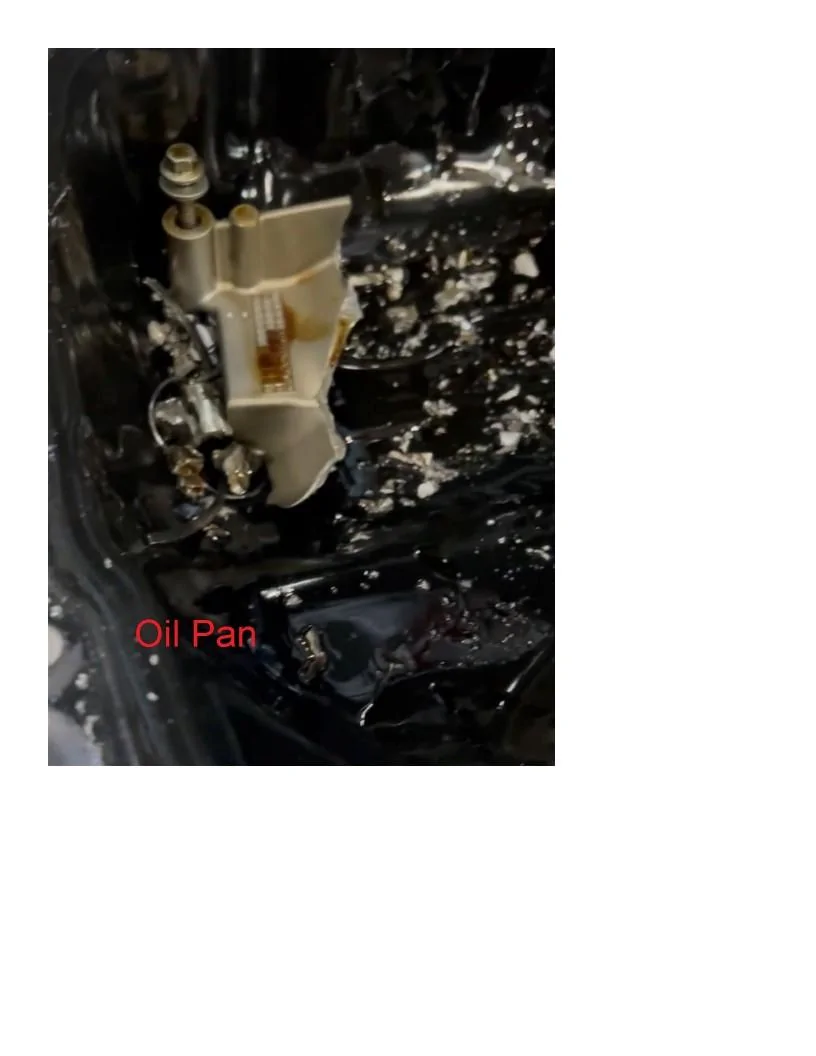

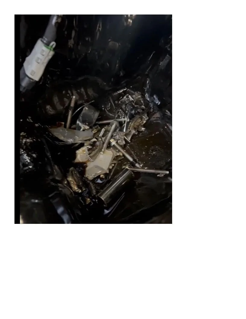

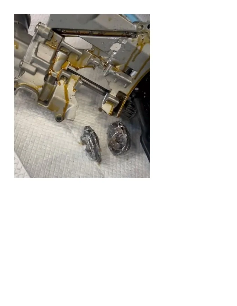

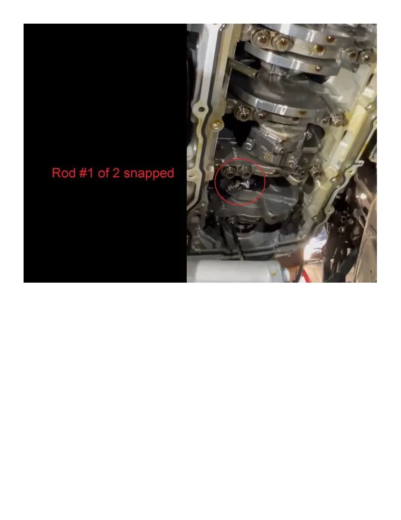

Truck has 12,XXX miles
Whipple Stage 2 for over 10,000 miles
Livernois Tune for 9,000 miles (to eliminate the gear skip shifts)
Never had detonation or a check engine light at any time ever on the truck.
WOT getting on the freeway and it let loose.
Whipple were fantastic at no cost to me (Stage 2, No warranty) they rebuilt the supercharger and also powder coated the unit from Black to Blue.
Livernois said a "known" issue are the cats plugging up...back pressure etc... but that Was Not True in my case...cats were not plugged or damaged they work fine now on the new engine.
Trying to figure out as best I can how to avoid it happening again if I...aka when I put the Whipple back on.

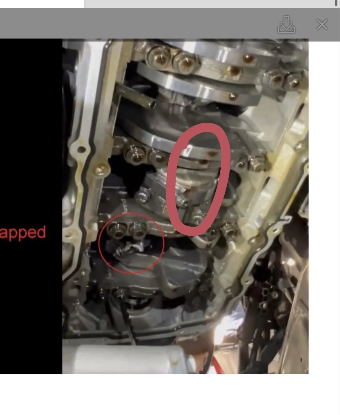

Good to see actual verification they are running a nice forged crankshaft in the truck motors, that large parting line tells me it’s a fully forged unit. A stage 2 is pushing what 800 horse?
Probably set of 5.2 rods from Ford performance or Manley H-beams and rebalance crank for the beefy rods if you want a long life of pounding on it. Mahle pistons probably wouldn’t hurt either. The rod likely failed when the piston exploded anyway.

Good to see actual verification they are running a nice forged crankshaft in the truck motors, that large parting line tells me it’s a fully forged unit. A stage 2 is pushing what 800 horse? Probably set of 5.2 rods from Ford performance and rebalance crank for the beefy rods if you want a long life of pounding on it. Mahle pistons probably wouldn’t hurt either. The rod likely failed when the piston exploded anyway. Could have been a poorly sintered rod from the factory too and just a crazy one off, you are testing the limits a lot more than N/A will never find.
What is the large parting line you mention in the crankshaft? I have looked 4 times through those pics and can't tell what you're referring to
See below circled. Cast cranks have a razor sharp parting line, forgings have a large parting.

I can really only think of 2 possibilities there;
1. There was a defect in the piston or rod that was un-noticed by whatever manufacturing quality checks they do.
2. The stock parts can't handle the speeds (piston speed, not vehicle speed) your running. Does the tune you have raise the redline? The simplest solution might be to just lower the redline, or change the transmission shift points to keep your max rpm's lower.
I'd lean more towards No. 1, cause your piston is still 'intact', so likely also a forged piece. Lowering your max RPM is still the simplest solution to avoid a repeat, unless you can discover exactly what went wrong.
