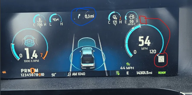

Somehow my speedometer has changed. There is no individual speed limits showing. Where did they go?

Here your cruise is set to 44 mph, vehicle speed is 54 mph and the truck has read the speed limit as 60 mph. What do you believe is missing?
You have navigation on in your main screen which shrinks down your speedo on the right. Turn off nav/apple maps and it will return to regular size. Top icon 0.3turn right ....

The individual speed indicators. 25 30 35 40 ect
The dial looks plain.

I also had more information ribbons inside the speed indicator.

I'm not sure what you mean about turning off my nav. I only use android auto. Are you talking about ford's nav?
I will but how?

Your speedometer is shrunk down when using AA or any navigation to put the turn icons in top center.
When not using navigation you might see the speedometer view you are thinking you should see.

When did this change take place? I liked it the way it was before.
I think you must have been dreaming or something, there have never been tick-marks, speed indicators on the digital display (10,20,30,40,50,60 mph etc). It only ever shows the posted speed limit signs. I wish they had options for different display types, I would like to have my Tach and Speedo look like a traditional old school version, with the tick marks and numbers.
The speed limit indicator (SPEED LIMIT 60) in this case, is usually in the correct spot on the speedo, indicated by the red line, however sometimes it gets stuck at the end of the speedo, either because the speed limit is only GPS indicated, or potentially because you are using GPS navigating in this instance (blue circle) which shrinks everything down and the 60 MPH limit would interfere with the fuel gauge.
Driving past a posted physical sign the truck camera can see will 'fix' it, turn navigation off could fix it. Or possibly just shutdown/restart/ and will be back to normal on your next drive.
