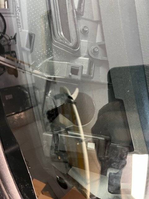

I'm been updating my sound system and bought an unleashed dash panel that has the speaker grill install so I can put my midrange in stock location. I got my speaker mounts ready to go and pulled off old dash. My question is what can I use to attach the speaker mount screws. Sorry for the bad pictures but you can see the little squares where I'm assuming some type of clamp goes that the screws can go into. Any suggestions?

I would just order the clips. I don't see any other option other than making your own holes.

Yeah I think it’s part W715835-S300 not sure though or maybe

Yes! The little silver threaded square LOL. You wouldn’t happen to have a part number for that ?

Yes see attached W705093-S403. I got the brackets from MTI Acoustics who specialize in Ford trucks. I'm picking up the nuts this weekend.

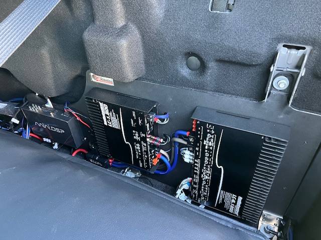

I will definitely take pics. Are you talking about Crutchfield?? My front stage will be 3 way active and will be using an Xcelsus XXM 325 in the dash corner with an XXM 875 in the doors. I have an XXt30 tweeter but it's so big that I will have to do some type of fabrication or pods to mount it. I have both the cross firing and the B&O A pillar which is the one sticking out. Currently have Morel tweeters mounted in it. I like the B&O pillar because it puts tweeter more on axis. I have a Mini DSP with DIRAC live as the brains of my system. I've been really trying to keep stock locations and stealth. Here is my current amp rack configuration behind the rear seat.

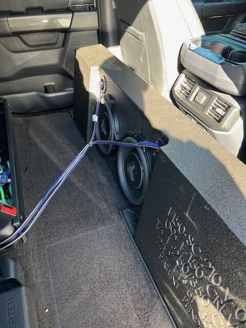

Outstanding! Love your set up especially your subs in the back. Assuming components on passive crossovers? I wrestled with getting subs mounted like yours but needed the space for my growing amp collection so did this instead:
