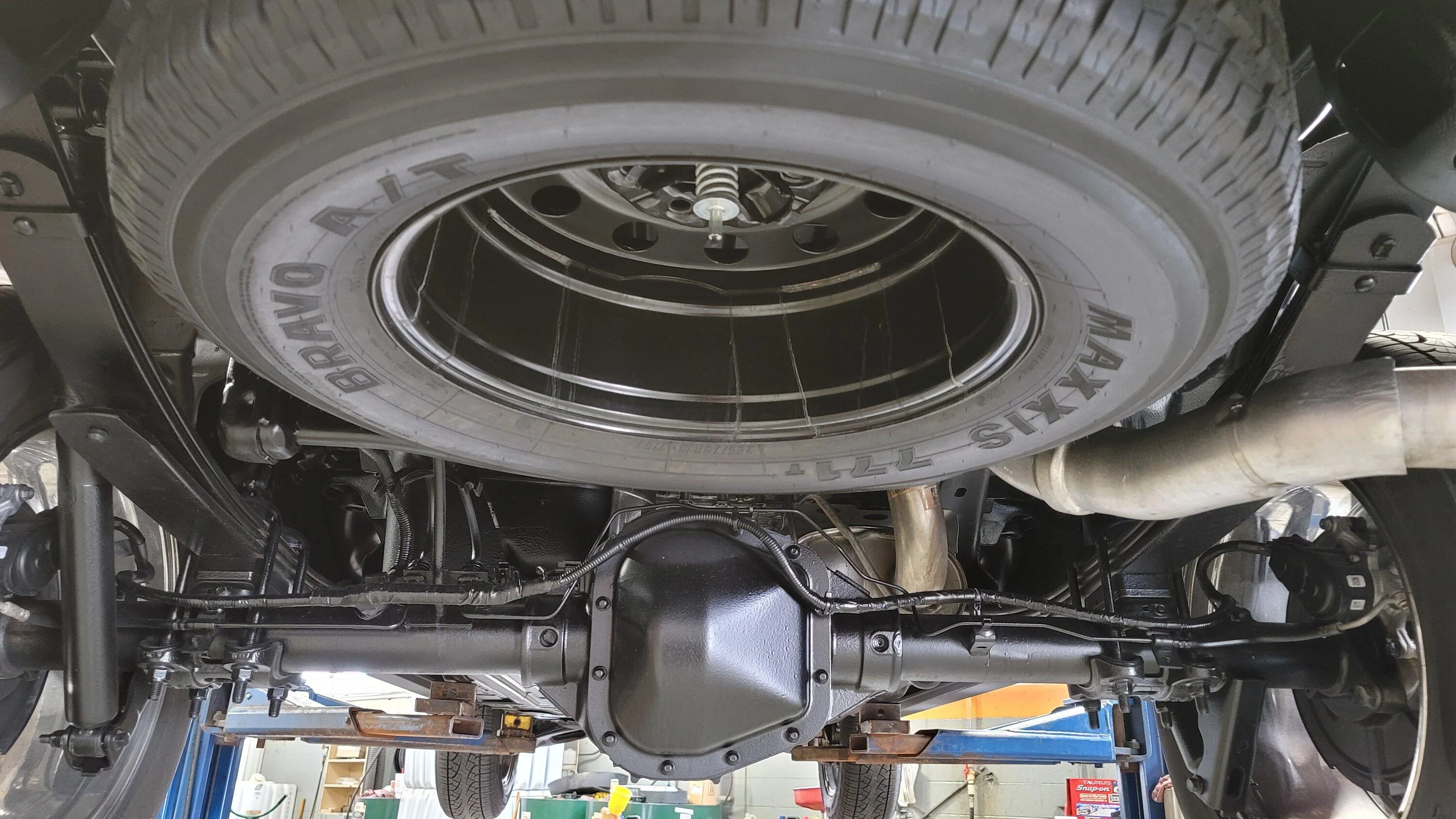

I have had my last three trucks done by Line-X and my wife's Escape. Looks as good today as when done. Saw my prior 2015 F150 at the dealer for service and it also looks the same as when I had it done.
Here is a month after being done during the first oil change (we drove to Key West, FL, and back for vacation).
