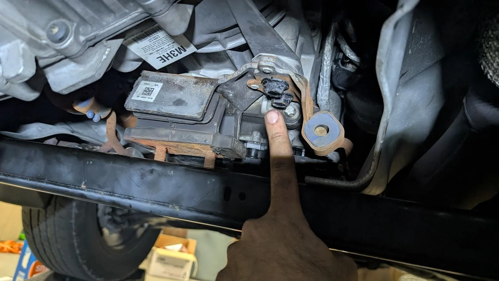

I did this today but with limited success. I could not get the pan to clear the exhaust cross tubes. I think the hybrid components were in the way at the rear end of pan.
I went in to replace the parking solenoid and was lucky that there was just enough space to access it with the pan kind of hanging forward.
There was no chance of getting to the filter bolts so I put it back together and top off the fluid.
Did you have to move the cross tubes or jack the transmission to get your pan to drop off all the way?
Here’s a pic of my experience

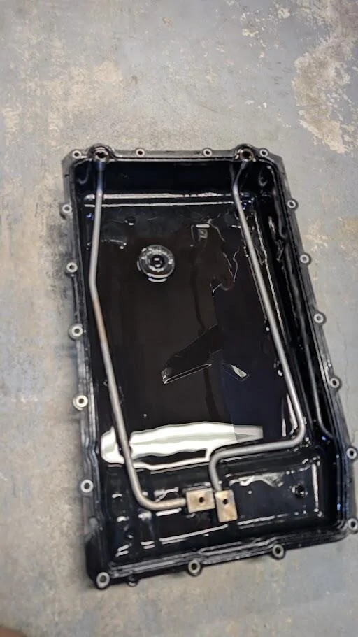

I'm debating on doing this myself on my hybrid or letting the dealership do it. Based on this thread, I need 2x7G199A in addition to the filter 7A098, and the filter o-ring 7Z302 Where does the 7G199B go, and does it also needed to be replaced like the A ones?
It looks like a bigger diameter version of the A ones:
https://parts.ford.com/shop/en/us/t...ube-(at)-p-l1mz7j135a?pdp=y#/collapseRelated6
Also based on the above I need to unbolt the trans from the rear crossmember to allow the pan to sneak past the exhaust (like Makuloco's video on a previous gen 5.0).
Assuming 8-9 qts of fluid, I'm seeing ~236 bucks for parts vs ~450 quote for the full service at dealer.

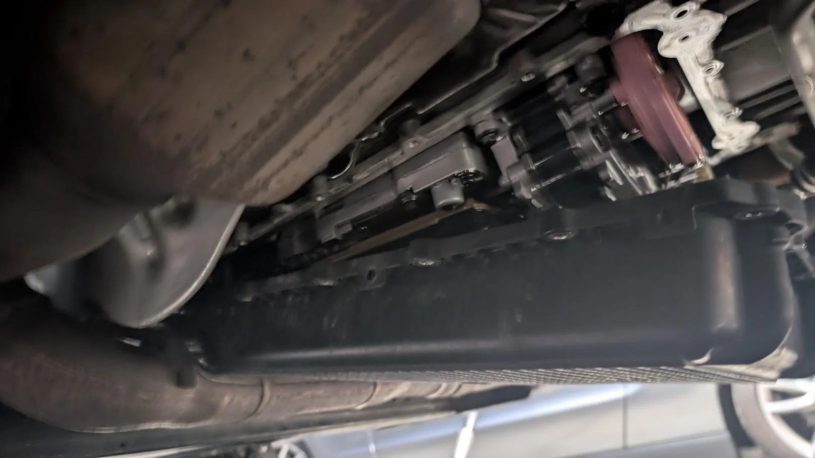

Can confirm this is a pitta. After sucking the fluid out and loosening the bolts, this is how far the pan is able to hang down:
Ford F-150 Rubber Tubes in Transmission Pan 1755526177062-ex
I was able to get the pan out with just prying on the exhaust and losening the trans mount
Ford F-150 Rubber Tubes in Transmission Pan 1755526255465-9
Ford F-150 Rubber Tubes in Transmission Pan 1755526269033-r

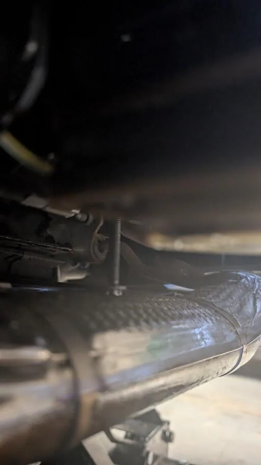

I ended up having to unbolt the rear trans mount (that also doubles as exhaust hanger) and pull the exhaust off it to allow the exhaust low enough for the filter bolt to come out. The loose tubes do fall out easily, so at reinstall i used a dab of grease to hold in place.
Ford F-150 Rubber Tubes in Transmission Pan 1755526582714-q
Ford F-150 Rubber Tubes in Transmission Pan 1755526303879-g7

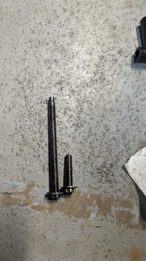

Whoever designed the rear long bolt for the filter to be directly in line with the exhaust pipe has never worked on their own stuff.
Ford F-150 Rubber Tubes in Transmission Pan 1755526409906-2
Ford F-150 Rubber Tubes in Transmission Pan 1755526437201-2g
Heres the size difference on that rear bolt:

The official writeup is to unbolt the RH cat at the turbo downpipe, but I feel thats just asking for a broken bolt.
