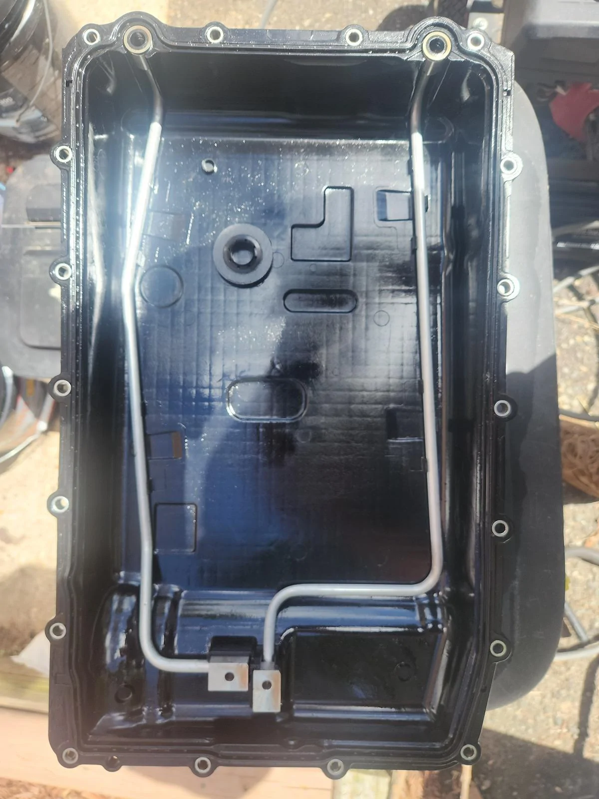

I drive a 2021 Powerboost and had a hard time getting the transmission pan off. Found these rubber tubes in it. Not sure what they came off of. Anyone know? Thanks in advance for any help.

The third image is under the exhaust and looked like the only two channels the tubes would fit, but they fall out. That was my only guess.

Sorta appears that way. I believe those are the lines that run to the electric motor for its cooling. It's cooled by trans fluid.

My guess would be those 2 holes line up with the 2 little boxes with holes at the end of those lines on the inside of the pan you took off, and I would think those probably sit inside those when the pan in place

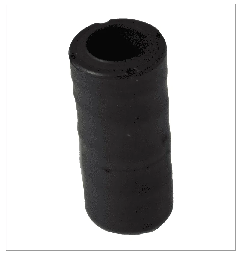

Those are as suspected - on parts.ford.com searching BL8Z7G199A should take you to this page

They look identical to the (4) that are inside a BMW trans between the mechtronic unit and trans. If you google BMW Mechtronic sleeve repair, you will see something nearly identical. Most trans’s are similar with these 6,8 & 10 speed electronic trans.
Thanks, this helped immensely.

Tubes might need replaced. The trans operates hot and I'd start with replacing those. This is a good heads up to the PB guys wanting to enter the trans. The fact yours fell out may indicate they're spent.
transmission guy I know stated that they replace these anytime they drop a powerboost pan
