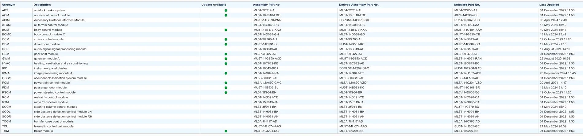

@jfalat was able to provide me with a list of updates but recommended I post on here what to update first as it’s a long list. This truck was owned by an elderly guy before me therefore makes me believe he didn’t activate anything not even ford pass here’s the list he sent me
I followed this the first time I updated everything.
The APIM is going to be a problem and is the first thing that should be updated. FDRS will make a USB update that you insert and then will have to leave the USB in for a few weeks until it decides to take the update. Once the APIM is updated, you will need to update the GWM, TCU, IPC and APIM over and over again until not more updates for those modules pop up.
At that point, you can update the other module. If you want to update the other modules while you wait for the APIM, you can, but it may cause some incompatibility issues because the GWM is very out of date.
