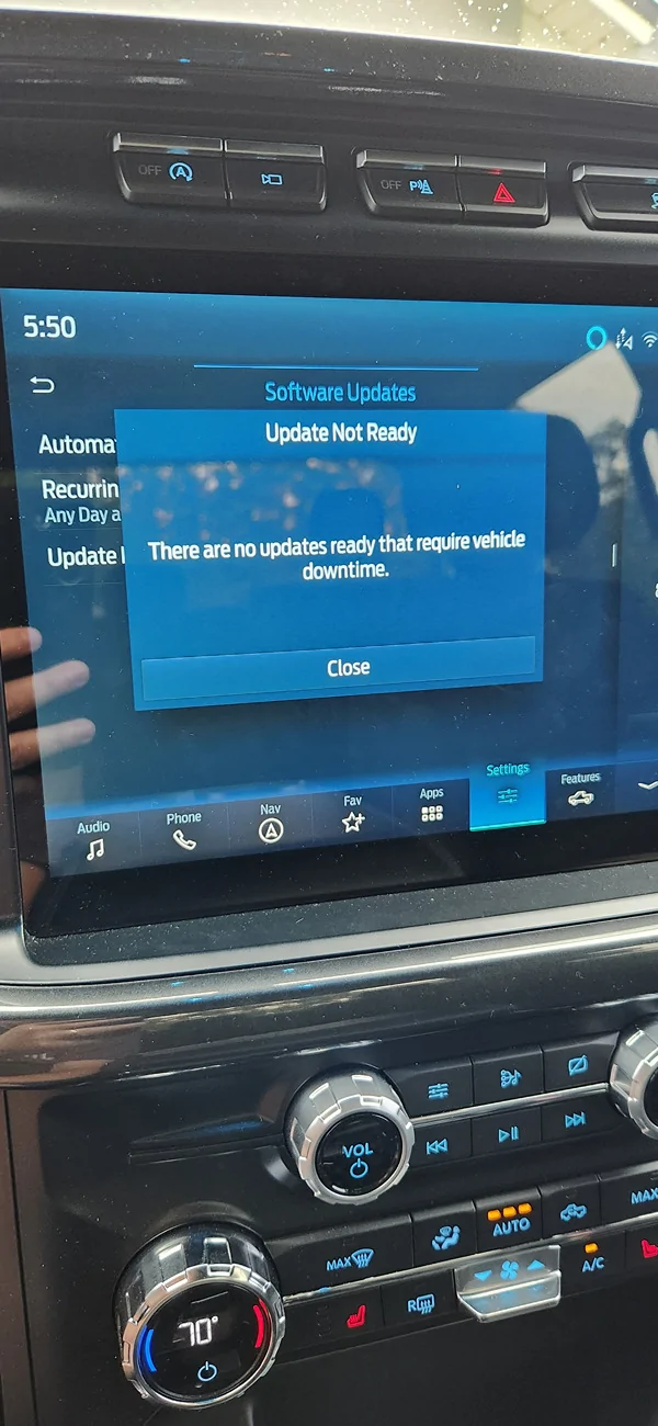

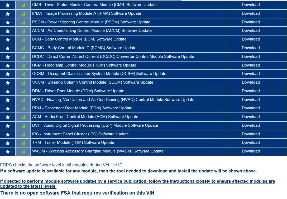

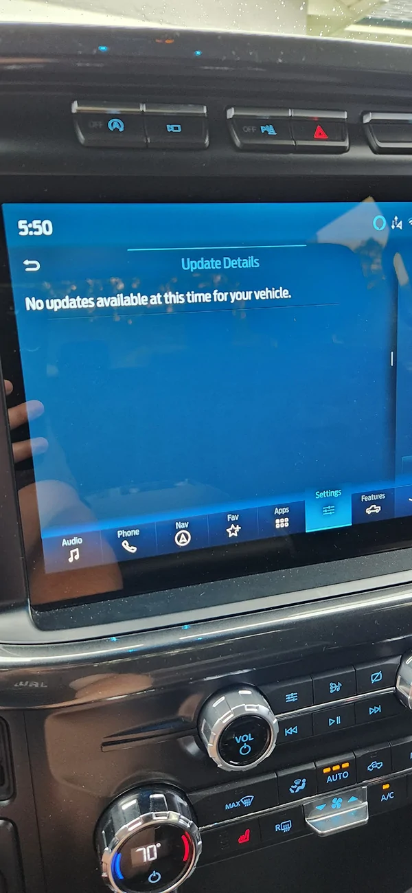

Lots of pending updates. The problem is, you do not show a pending update for the GWM. According to FDRS, there are no pending updates waiting behind these that are showing for you. Also, your truck is on Sync 22230 which is 3 year old software at this point. Because you are not showing any pending updates for the GWM, APIM or TCU, this means your truck is most likely affected by the attached SSM where Ford, for whatever stupid reason, is blocking updates for vehicles on Sync 23187 or lower.
Even if you had FDRS, you would not be able to update you truck's Sync modules to the latest version. The issue is on Ford's side and not with your truck. Until Ford gets its head out of its own ass in regards to why they are blocking updates for vehicles on antiquated software, there is nothing you (or the dealer) can do.
