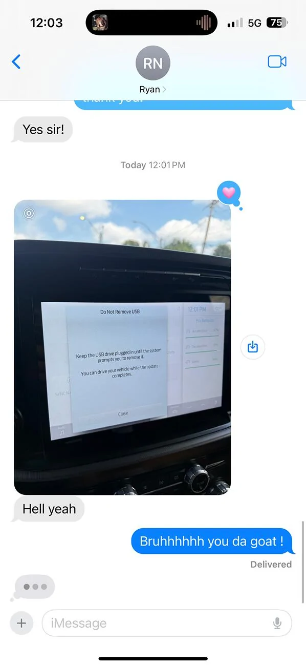

rugedraw
Javier
Dec 14, 2021
7,413
9,008
Miami
Auto Sales
I have a battery enhancement update that failed last week and it will not re-attempt. I have it hooked up to a battery maintainer and it still will not re-attempt. Can anyone give me insight as to why it is failing?
It failed due to some hash error on the server side. Nothing you did wrong. You have to wait for them to resend it.
