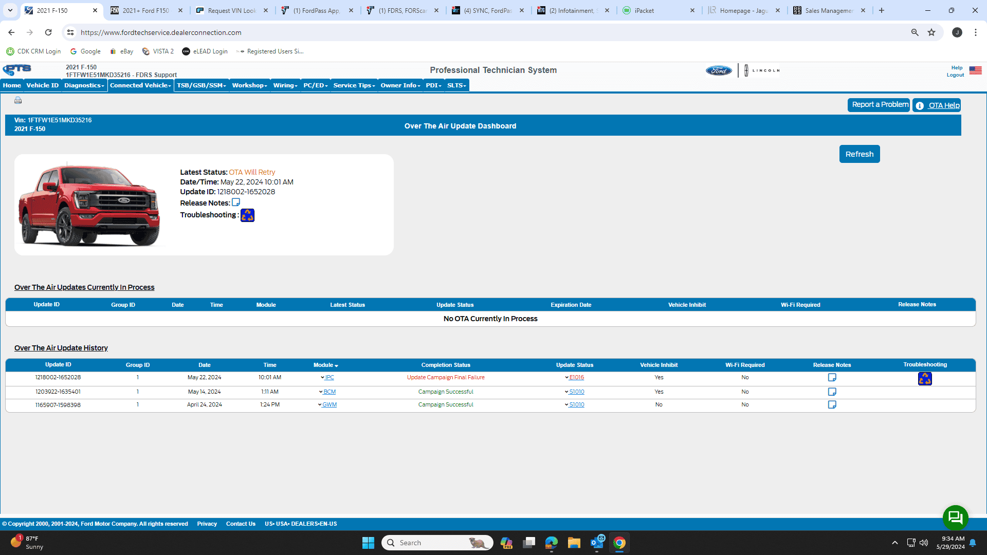

I purchased a 2021 F150 in February.
The last update I received was on May 19. It was 22-PU1009-TLC-CSM2. After reading the OTA update history, it says this update was released in January 2024.
Is it common to get these updates months after release? It appears there’s been about a dozen updates since that one. Do I just keep waiting for them to be pushed to me, or is there a reason I haven’t received them yet?
After exploring this forum I replaced the stock battery with an H8, as I was experiencing some low battery charge issues. Those issues went away with the new battery, and I eventually received the aforementioned update.
My VIN is 1FTFW1E51MKD35216
Thanks very much for your time.
Yes, it is common to get updates months after they are released. You OTA history shows you got a BCM update after that one, and also OTA 6.8.0 was sent to you recently, but it failed due to a server error.

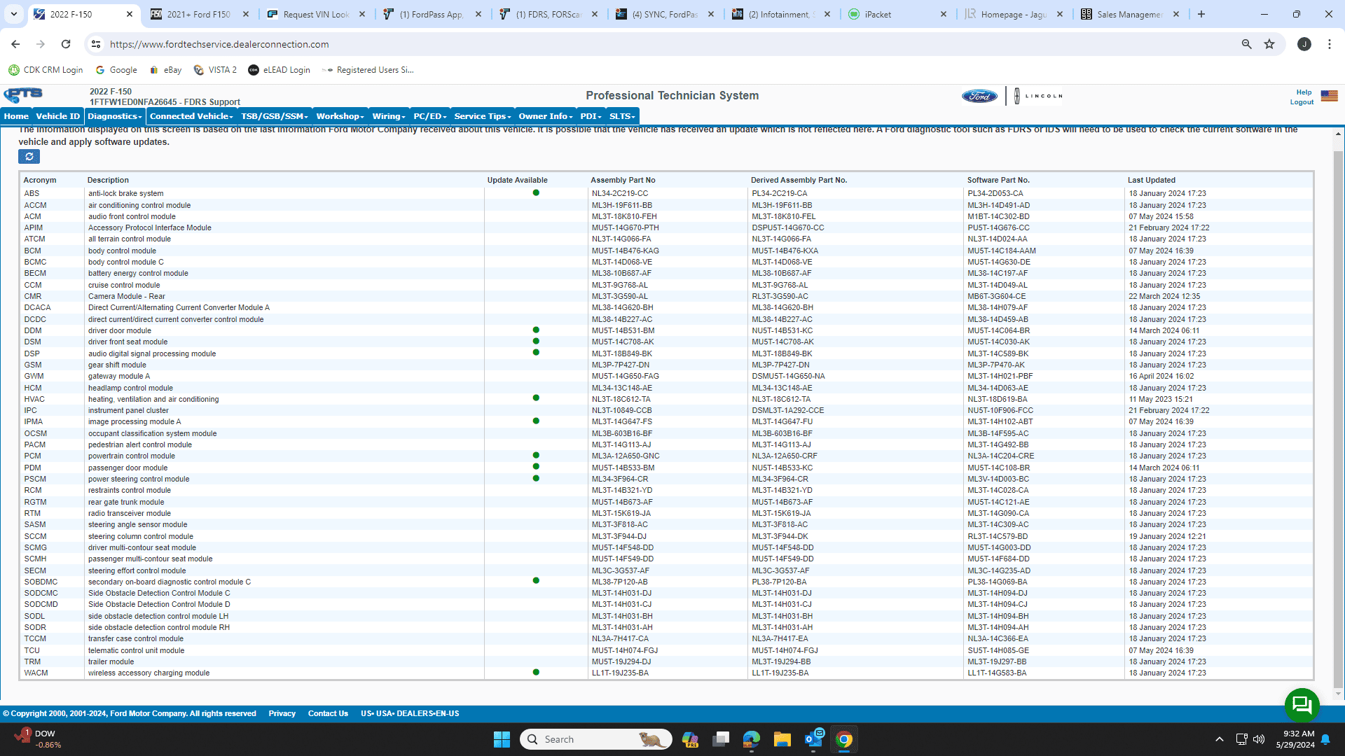

SW Updates available, please? 1FTFW1E54NKD92964. Thank you!
Truck is on the latest Sync version. Modules pending updates are below:
