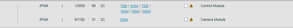

PTS shows this campaign open for your VIN stating a GWM can fix connectivity issues preventing certain connected features from working. One of the things specifically mentioned if you read through the document is Fordpass not being able to lock/inlock the vehicle. This looks like a good place to start. Without FDRS, a dealer visit will be required.I can't seem to lock/unlock my truck from FordPass recently but everything else in the app works. I was wondering if there was something someone could look into for me?
1FTFW1ED1PFA16905
