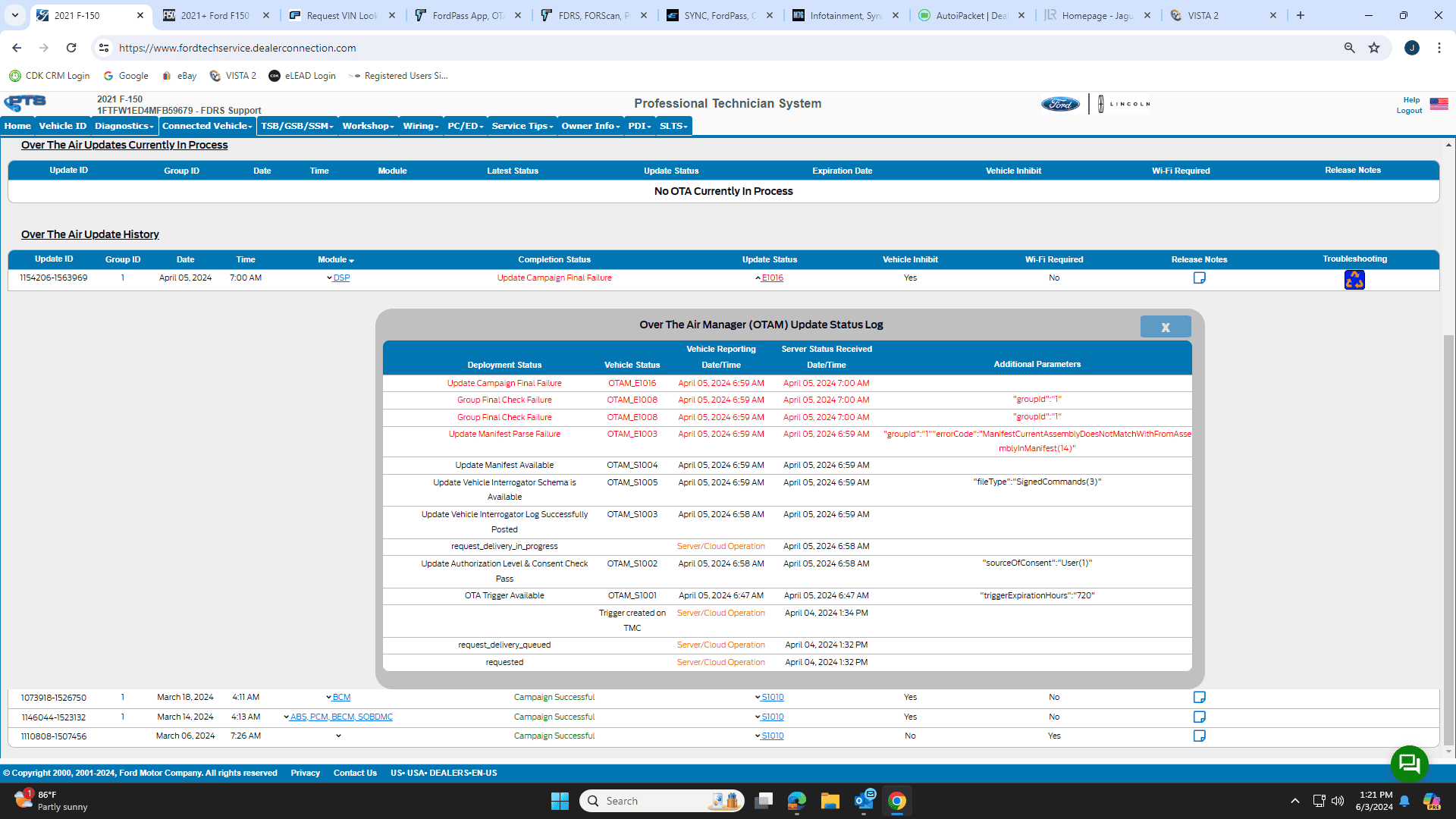

VIN check. 1FTFW1ED4MFB59679. Thanks. Have 23-P1024-6CH-AUD in a not completed state
It failed due to a manifest mismatch. Nothing you did wrong; the issue is on Ford's side. Just gotta wait for it to be resent.
